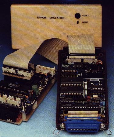

I have such an EPROM emulator, a design by the dutch magazine Elektor in the 80ties. Attached to the parallel port of the PC.
Works fine upto 1 or 2 MHz clock speeds.
It is the usual design with TTL and 6116 SRAM.
With EEPROM and ZIF sockets I do not use it often.

Here's the article, from December 1989:
http://techdoc.kvindesland.no/radio/yms ... 510828.pdf
Here's some info on a successor device, from Elector of September 1992:
And another one from 2001 (serial-connected).

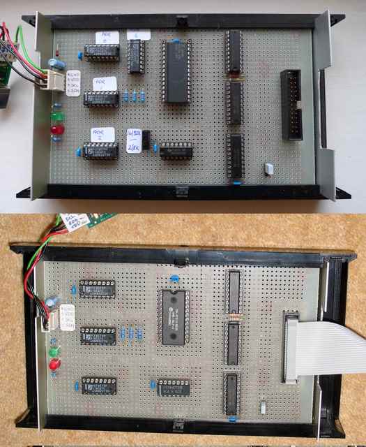

Shouldn't need much to build one.
A RAM chip to hold the data
3x tristate line drivers/buffers to all allow the targets address and data lines to be isolated when changing the RAM contents
A GAL chip to arbitrate target and host access control signals
A micro-controller to load the RAM chip via USB or UART
Definely less than $300. Probably less than $30 on strip board.
Andrew Jacobs
