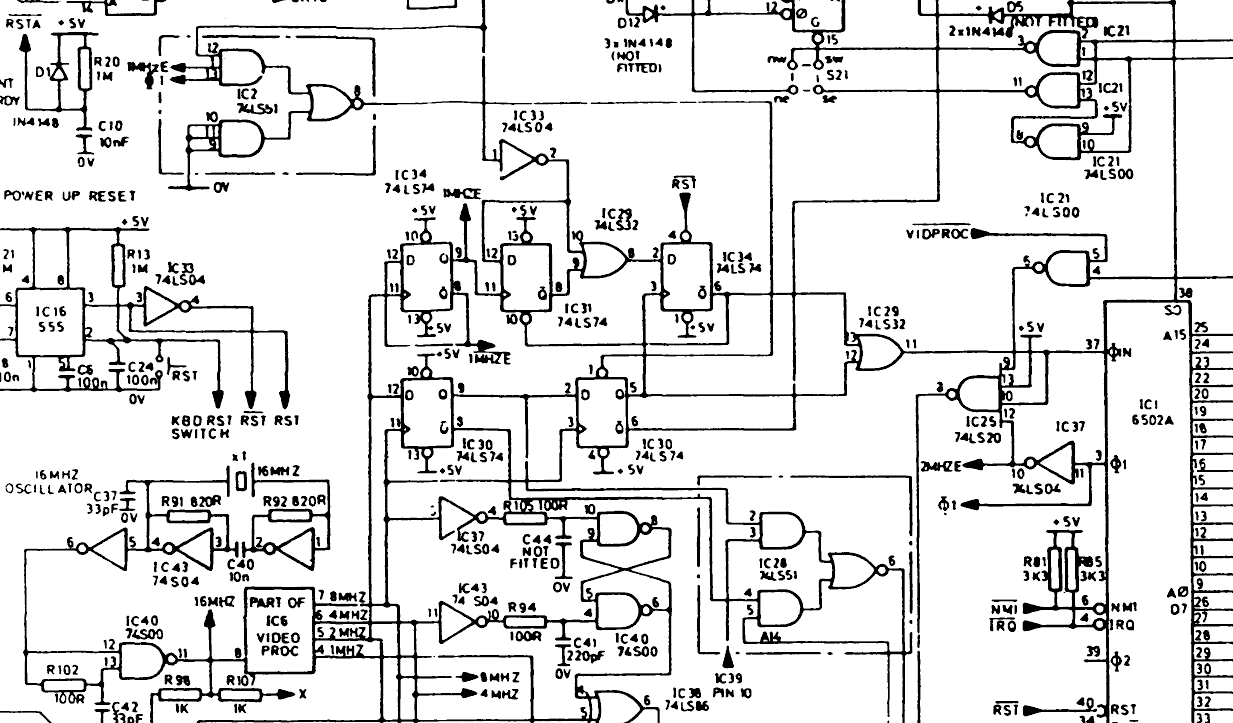

There are probably many ways to fiddle the clock signal, either syncing to a slower free-running clock or suppressing pulses. Here's Acorn's circuit for the BBC Micro:

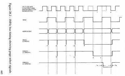

Unfortunately this method may result in duplicate accesses - see App Note 3 or Figure 28.2 on page 443 of the Advanced User Guide:
Anyone got a reliable, simple and glitch-free solution to the problem of accessing slow peripherals?

Fair point, using a CMOS part would surely make life a lot easier. I have a gut feeling that Acorn's approach (which did have to work with the NMOS part) is over-complex, and yet it's quite beyond me to come up with anything better.
The problem for Acorn, I think, was two-fold: they had to effectively change the Ø2 frequency without inadvertent phase shift or level glitches, and they had to do it with the available logic of the day. Had they had, say, GALs available at the time it would have resulted in a lot less circuitry.

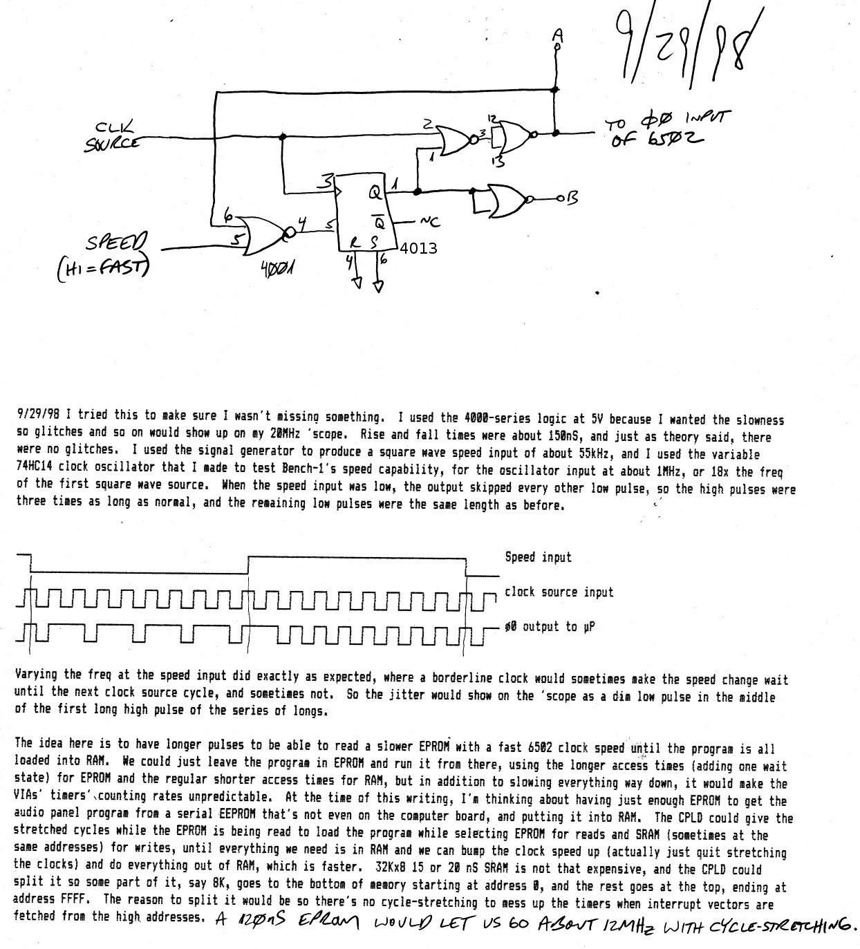

We've had a few discussions about this over the years but I'm not finding it easy to round them up. I posted a circuit at viewtopic.php?f=4&t=1370&start=262 (in one of ElEctric_EyE's long topics) that uses a speed input bit to selectively skip every other low pulse, without glitches at the switching. Don't use the 4000-series logic I show there-- I used that only because I wanted slow-enough logic that if there were any glitches or runt pulses, my slow oscilloscope could catch them. The circuit uses a flip-flop and a quad NOR, which you would want to select from a faster family.
PostPosted: Fri Apr 04, 2014 9:40 pm
That's good -please could you attach it here? I did a little searching before posting, but didn't find that one.
Edit: Hmm, it only slows one phase, so it might not work with peripherals that use both edges of the clock...
You might be able to get the timing accurate enough by adding a non-inverting gate of some kind that gets its input at the same place the top-right NOR does (which is only being used as an inverter anyway), or by using an OR gate getting its inputs at the same place the second-to-last NOR does, namely the clock source and the flipflop's Q output. The extra gate could be of a different 74 family if necessary to try to match timings.
