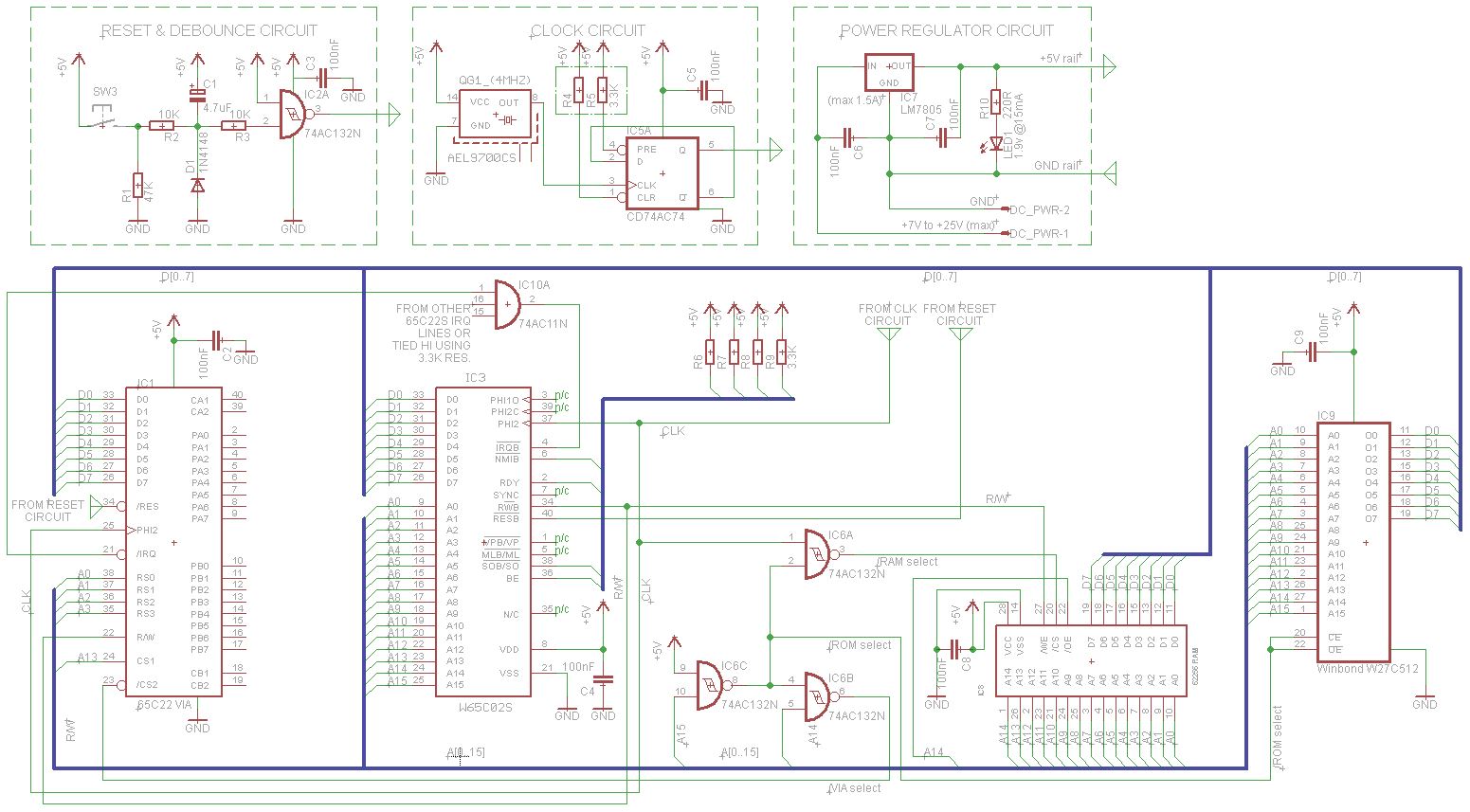

Hi guys
I've built my first prototype 6502 and am trying to debug it. Currently it has no I/O, but is simply a 65C02 (2MHz), RAM, EEPROM and glue logic.
The debugging process is somewhat long winded as I'm doing it by hand using an oscilloscope to probe each bit of the address bus, data bus, and decoder lines. So each cycle means that I have to read 24+ points.
As this is more than a little tedious, I've settled on the idea of purchasing a logic analyser.
Now the question... does any one have any recommendations? I know that generally speaking the more probes the better. I was thinking of getting one with up to 30+ probes. Money-wise I can afford £60-£70 when I next get paid.
Any ideas/recommendations?

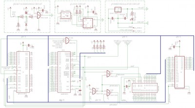

As for the latest diagram, it hasn't changed apart from:
- the addition of the manual clocking push button circuit
- replaced the entire 4MHz clock circuit (4MHz oscillator can+D type flip-flop) with just a 2MHz oscillator can
- To keep debugging simple the VIA hasn't been connected up yet

You should post your schematics directly to 6502.org. You can attach JPEGs, PDFs and some other file types directly to your messages, which means they'll always be there, even if your website goes down for any reason. Also, if you move the website copy you may break links in your older messages.
As an aside, schematics might be easier to read in monochrome than color, especially for we old folks who are partially colorblind. I've been trying to follow your schematics but am having a tough time with the colors because they don't have much contrast.
Oh, one other thing. The value for R10 appears to be too low—470 ohms might be a better choice, as there's no point in beating on the power LED.

I don't see any problem with the schematic itself.
This schematic type is common, so I suspect it's from popular software and the user has no control over the colors. I've had intermittent slight fogging in one eye for the last 15 months (I can often get it to go away for a couple of seconds by rubbing it) and the gray letters on white background really slows down my reading. Young-eyed programmers and web developers think it's cool to soften the look, so this problem is rampant. It's everywhere! They say the monitor has higher contrast than black ink on white paper; but the fact is I never have the problem on the paper.

Thank you all for you suggestions. Driving 1mA through LEDs sounds like the easiest way to do this so excellent suggestion there. I've got a large bag full of red 5mm 1.9V LEDs. Not sure I have enough resistors as this is my second electronics project and so I haven't built up tons of components. Time to do some ebaying!
Regarding the schematic: I normally use the free version of Eagle from CADsoft (hence the colour scheme), but there's nothing stopping me converting it to black and white or grey scale. Which would you prefer/is easiest on the eyes for you? The "soft" look of the schematic I think is because it's a JPEG which is a lossy format. I could be wrong, though. However, if it can take a lossless format (I think PNG should be ok?) then I'll use that.
I've also edited my post above and attached the schematic to the post.
The power LED is rated at 20mA (max) @ 1.9V so thought 15mA would be ok. I'll reduce this to 10mA thus requiring a 310R. I'd normally go lower with amber/yellow LEDs and some other colours as they seem to quite bright, but the red ones I have are relatively dim in comparison.
PNG is okay, but GIF may be better with monochrome. I post my schematics in monochrome as GIF files, which are lossless for all practical purposes. Also, the resulting file is small and fast-loading. Some of the default colors in Eagle are too light a contrast for me to clearly see. Fiddling with the monitor, as Ed suggested, won't help because the light colors are on a white background.
