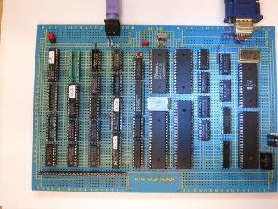

here is my newest SBC using a real 65 CPU, but as it is a large prototype board I call it a a Single BigBoard Computer.
Top View of the Single Big Board Computer
It implements the following features
  • W65C816 CPU currently running at 8MHz Clock (as soon the fast GALs arrive I will try how fast it really goes)
    PS/2 Keyboard input (and of course CTRL-ALT-DEL produces a reset)
    VGA Video Output with 40x24 or 80x24 Text (no attributes however, just plain B/W and Flashing support for 64 characters)
    Low-Res Graphics with 40x48 or 80x48 Blocks with 16 colours
    512kbyte SRAM
    256kbyte EEPROM
    Space for two SCC2691 (only one is currently mounted)
    Breadboard compatible expansion for IO (the Databus Buffer and the Address Buffer are currently not populated)
The GALs are programmed (together with some gluelogic) to produce a AppleII (II, IIplus, IIe, jumper selectable) compatible hardware, so I can run some tests without having to write a monitor and other software.
The VGA controller produces a standard VESA signal (480x640@60Hz) and uses a Dual-Port RAM and a ATMega162. Although I have not implemented any type of collision avoidance I never had any artifacts on the screen. The PS/2 interface is built using a ATTiny44 together with a 74HCT595 as interface between the ATTiny and the SBBC databus.
But as always a job isn't done until paperwork is finished. So next is to document the whole thing properly. I soldered and unsoldered so many wires and did so many changes, that the original drawings are no longer valid. This happens if you implement new ideas during building your computer :wink:

Here some more information about the ICs you can't read the type. At the bottom right is the ATMega162. Left to it is the SN74HC573 the address latch required for the external memory interface. The 48-pin IC is the DP-RAM, an IDT7134 (4k DP-RAM without arbitration logic). For more detailed information here is the schematic of the VGA-Controller as it is now. The 74LS02 which is turned by 180° is because it was initially a 74LS00 but I had to reverse the logic of the A0L line, else the Firmware would draw the columns in wrong order. And the 74LS02 has the pin-out 180° turned (just needed to swap GND and VCC)
vga-controller-v3.pdf
Schematic VGA-Controller
(39.28 KiB) Downloaded 245 times
Above the DP-RAM you have the SRAM (512kbyte AS6C4008-55). Below the EEPROM is the CPU X-tal and then the CPU itself (W65C816), again left to the CPU is the Bank Address Latch (47AC573) and the Clock generator (74AC74 used to divide the 16MHz X-Tal Clock to provide both PHI2 and /PHI2 in sync and the AC can sink and source 24mA, almost a perfect clock source for a SBC). Then the last 14-Pin IC you can't read is the ATTiny44.

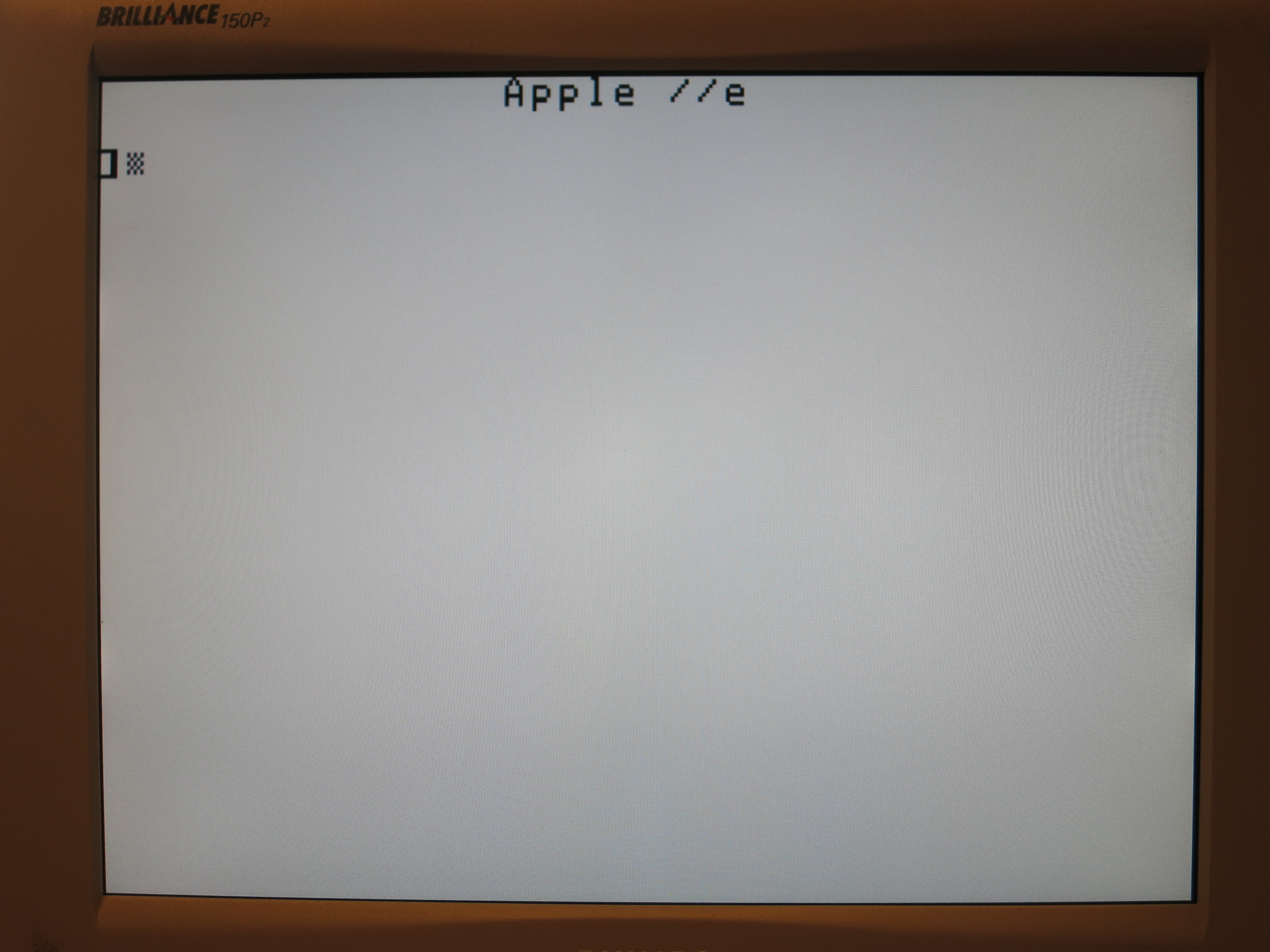

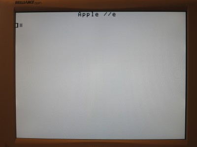

Here the screen after boot
Boot Screen Apple //e Mode

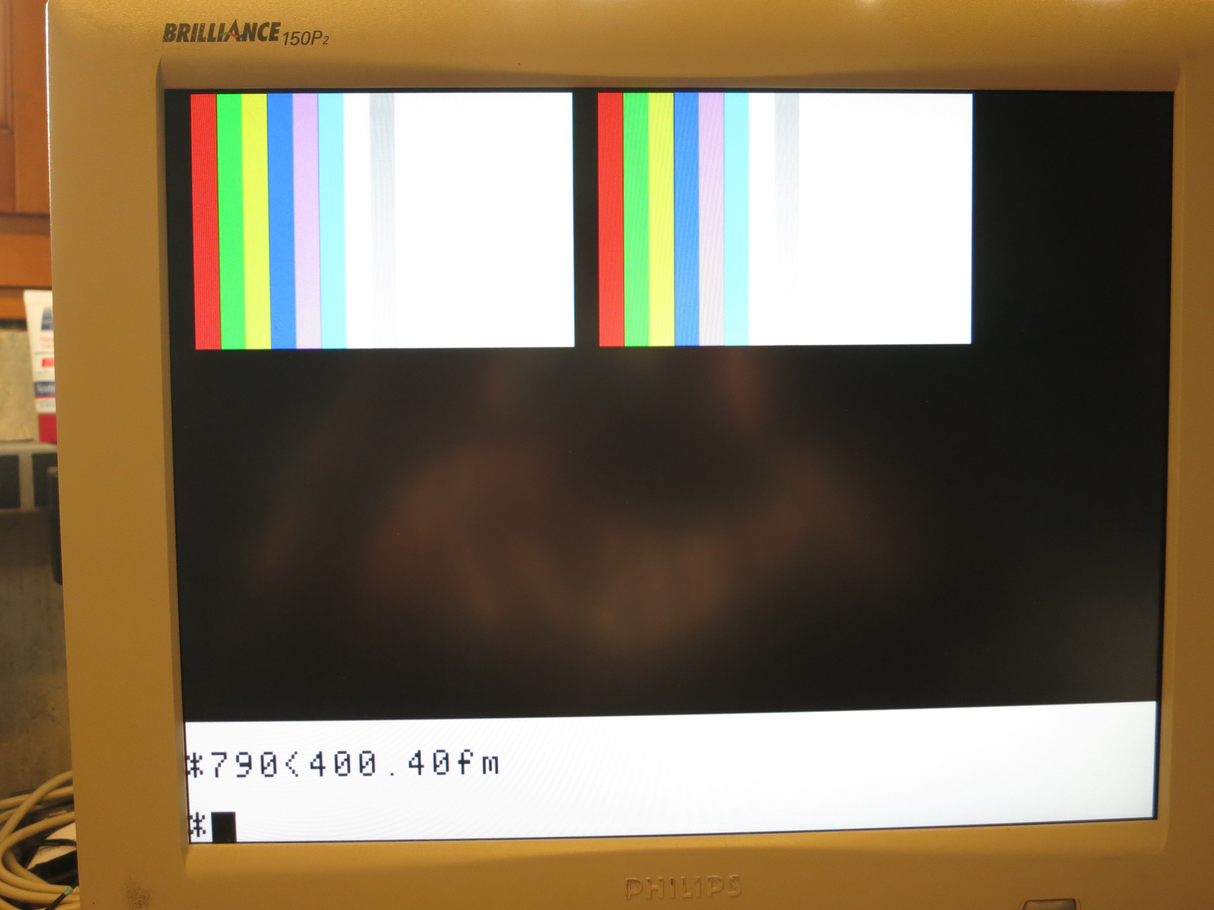

and some tests with the colours
Colour Stripes
Colour Stripes
not a very good picture though. Next is to finish all schematics in Eagle. Unfortunately I have to build first my custom chips (GAL) and the CPU into the Eagle Library. I already did this once. But that was long ago with Version 3.xx and the current version 6.5 is not able to import them, aaaaahhh. And I did not save them as scripts. My bad.

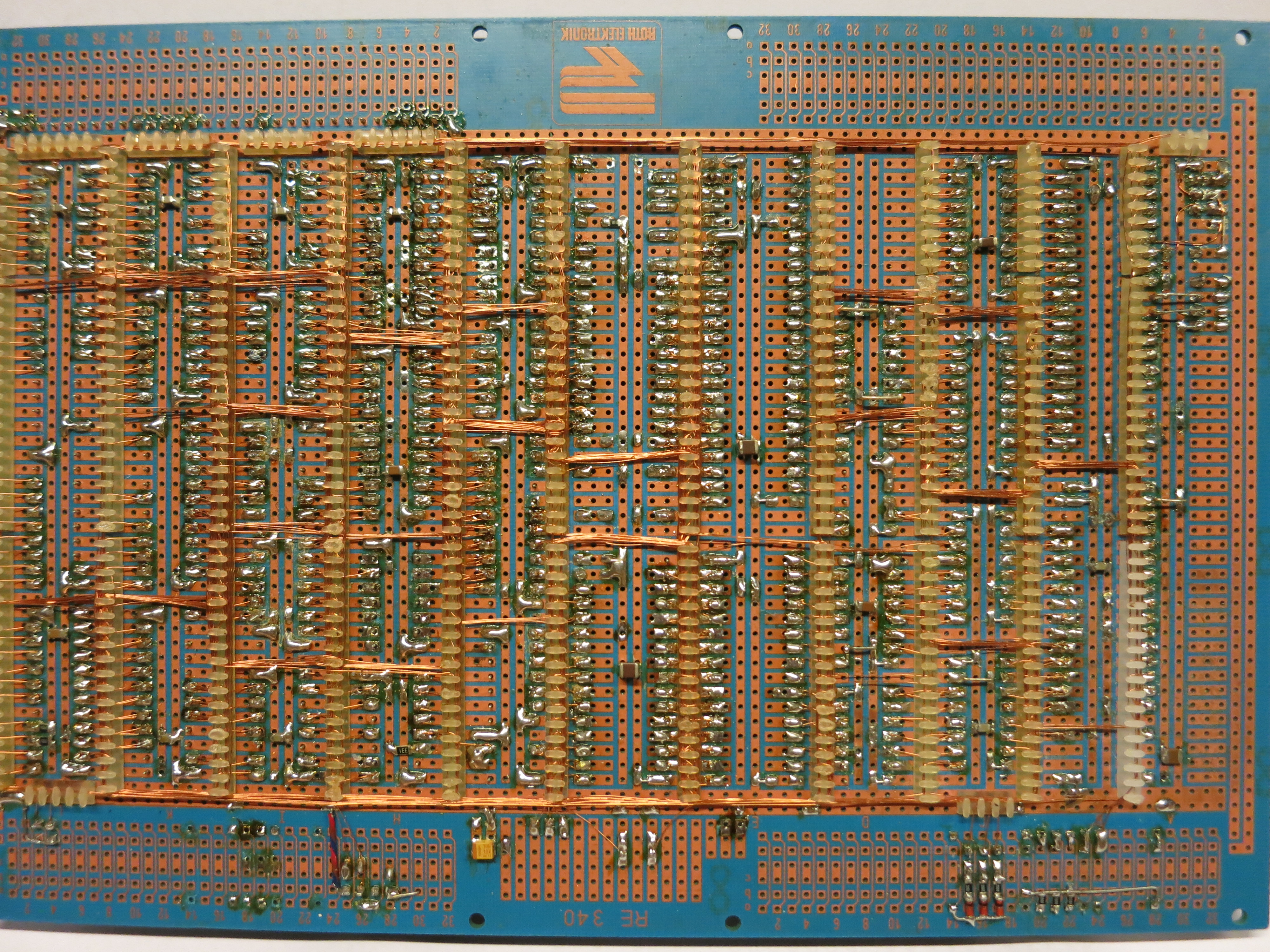

Nice! Do you have a view of the bottom of the board. I like seeing the wires (I appreciate the work that goes into it) :)

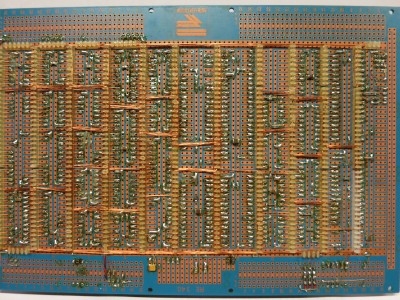

Here a picture from the wiring side
Wiring Side (PS/2 and VGA at bottom)
Because of design changes during the setup some solder points really look bad as I removed wires and placed new wires to the same point. Especially when the comb is placed close to the pins, placing the wire so it stays in place during soldering requires some patience.
