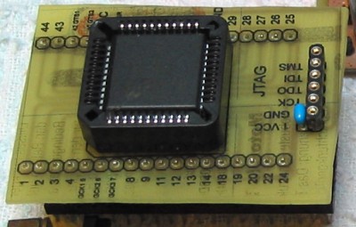

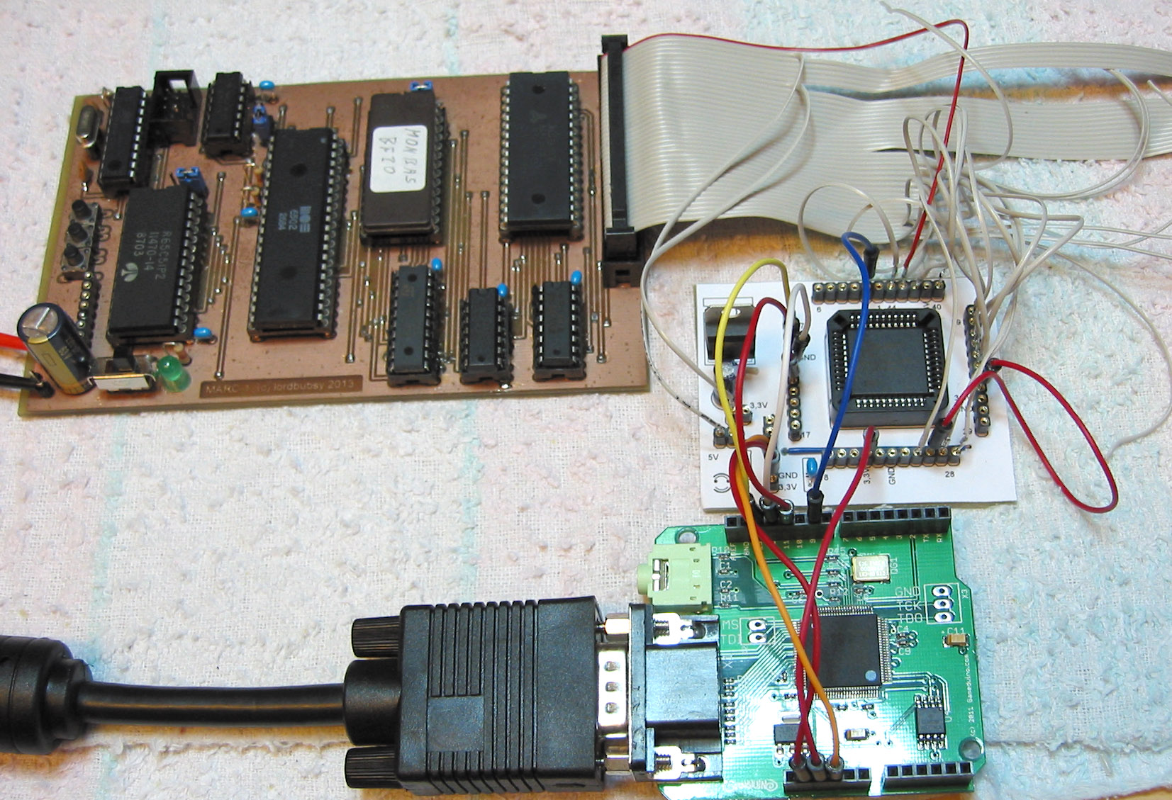

I do hope you don't mean solderless breadboard though-- those are the worst of all worlds for digital.
True and true, especially with CPLD’s I found out the hard way. That’s also a reason I made MARC-1, to get rid of the whole computer on a breadboard. While replacing glue logic and adding 65SPI, things simply didn’t work until I placed a lot of bypass caps. Without help, I was clueless.
nyef wrote:
Or there's the approach of using a soldertail PLCC socket and just sticking it into wire-wrap pin headers.
I did something like that. The first approach was an adapter from PLCC to DIL.
The second approach was an adapter using pinheads (I believe that’s how they are called)
Marco

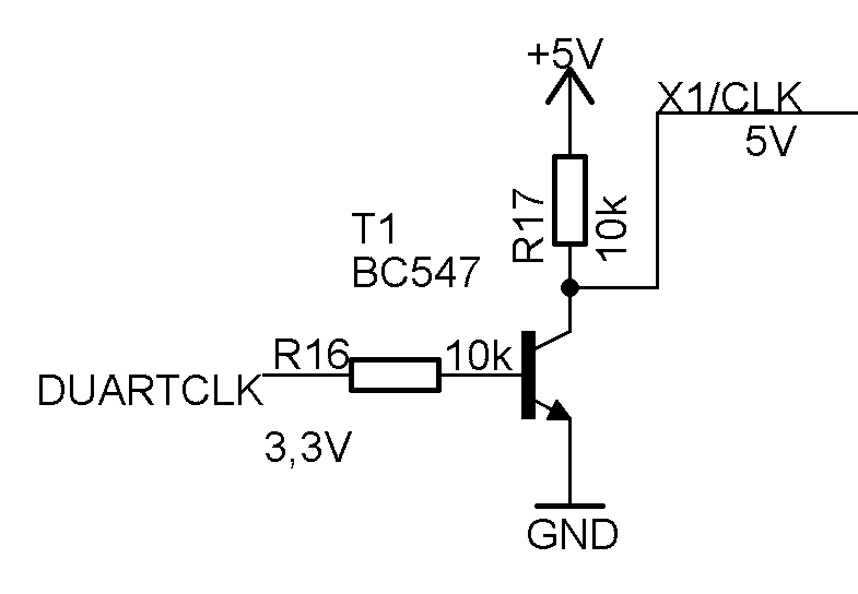

For MARC-2 I’m using an XC95288XL 144 pin CPLD. It’s a 3,3V part with 5V tolerant I/O’s. The DUART that I’m using, the SC26C92, needs 0,8 x 5V = 4V at the clock input. I want the CPLD to deliver that clock and level-shift it to 5V. I could use a resister to pull-up to 5V and tri-state the I/O line for HIGH. This is a method Xilinx suggests. I’d rather use a transistor like this:
Would this suffice for the needed 3,36864MHz? I’d rather not use a 74XXX14 or 74XXX74.

lordbubsy wrote:
For MARC-2 I’m using an XC95288XL 144 pin CPLD. It’s a 3,3V part with 5V tolerant I/O’s. The DUART that I’m using, the SC26C92, needs 0,8 x 5V = 4V at the clock input. I want the CPLD to deliver that clock and level-shift it to 5V. I could use a resister to pull-up to 5V and tri-state the I/O line for HIGH. This is a method Xilinx suggests. I’d rather use a transistor like this...
Either way, the output waveform will be sloppy. Rate of rise will depend on how quickly R17 can charge the parasitic capacitance of the clock circuit. So the clock high phase will be something less than the ideal rectangular waveform. A totem-pole arrangement would be better, as both clock phases will be driven. An alternative would be to use the lowest value for R17 that is consistent with the rating and gain characteristics of T1.
That said, you'd be better served by using a can oscillator to generate the 26C92 clock. That clock is asynchronous to the 65xx bus cycle, so there's nothing gained by making the CPLD act as the clock generator. All you're accomplishing is wasting product terms and I/O pins. :D

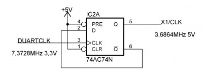

I don’t have (easy) access to a 3.6864MHz can oscillator.
What about a 3.6864MHz crystal?
I’m also considering using a 74AC74 like this.
So to summarize, I’m considering three options: the transistor, a crystal or a 74AC74. What would be the preferable of those?

 Post subject: Re: MARC-2 project
PostPosted: Sat Apr 12, 2014 7:14 am
Posts: 258
Location: Southampton, UK
Could you elaborate?
See: http://en.wikipedia.org/wiki/Push%E2%80%93pull_output
This would seem like the simplest arrangement.
I know many people dismiss discrete crystals with a pair of caps as clock sources. I personally have never had any issues with them in my 8bit computers, either handmade or not. They might suffer temperature variance issues, but on the plus side they are simple and cheap and easy to get hold of.
But like BBD said, the clocking of your [D]UART is asynchronous with regard to the rest of the circuit, so you are free to treat it as a separate problem to solve in the way you think is appropriate.
(FWIW I will be using a simple 3.6864MHz crystal in my 88C681 DUART setup. I don't anticipate any issues bearing in mind I've had the same circuit rigged on breadboad for months. I used rates up to and including 115K2.)
