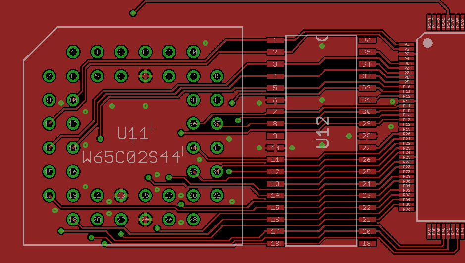

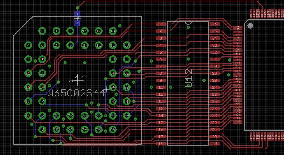

As far as X/Y routing, I do mostly surface mount parts, so generally, I try to route as much as possible on the component layer, and try to keep the traces on the bottom layer short. Here's an image from the board I'm currently working on. It's got a 6502 in a socket, SRAM, and FPGA. It's not finished (power isn't connected for example, and so are a bunch of control signals between 6502 and FPGA), but it shows work in progress. Note that I fully exploit the pin swap capabilities of the FPGA to avoid vias.
Here's the top + ground pour:

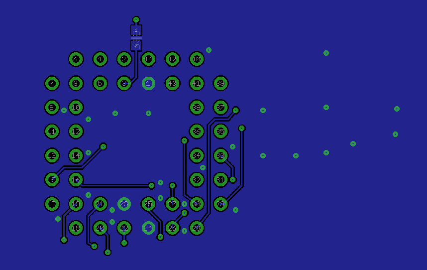

And the bottom:
Note that the bottom looks empty now, but the power nets haven't been drawn yet. I do make an effort to keep the traces surrounded by ground as much as possible, avoiding to cut up the ground plane with long traces.

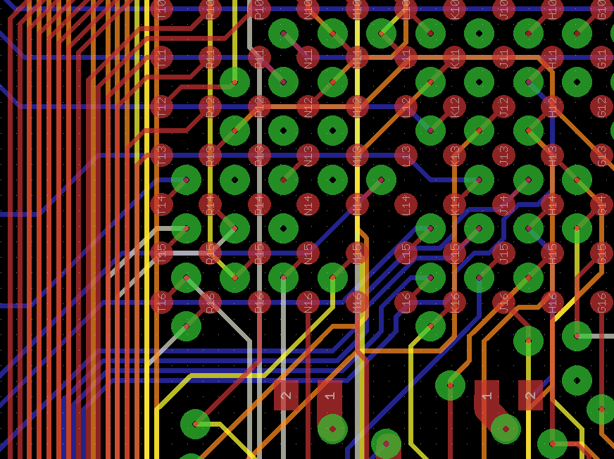

Where I order my boards (eurocircuits.com), all of them are electrically tested before shipping. Any boards that fail the test are quickly replaced. That doesn't mean I use 6 mil traces all the time. If possible, I use 12, 10 or 8 mil traces, depending on the density of the board. But if the board requires it, I have gone down to 6 mil trace/clearance, and never had any problems.
Here's another board I had made at the same place. It's got 6 layers, 4 mil trace/clearance and 6 mil (0.15 mm) finished hole. I didn't design it myself, though.
