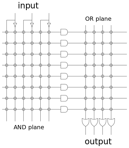

I have read a bit on how the 6502 processes instructions but im still a bit confused. From a diagram of a normal pla there is an input with a normal line and an inversion of that same line, and there are lines of the array attached to nothing, then those lines lead to the nor section which go down into the output. Image
What is the purpose of the inputs and the outputs? I saw that it fires instructions based on timing, but I don't know where that goes in on that schematic. Im attempting to better understand processors and this is a bit confusing to me. I've looked at simulations and i've come up with what I THINK is going on but this might be something different.
So there might be triggers for parts of the cpu, like (Accumulator INPUT) (Accumulator OUTPUT) (X input) (X output) (Load) (Store) etc etc..
And STA might trigger Store, and A, which will select A to dump it's data into the register bus, where the store circuit will pick that up and send it to whatever address is in the argument registers. (example, STA $0D00) would trigger Store, and A. LDA will trigger Load and A, which will pull the data from the address in the argument registers into the register bus and only A will pick that up and lock on the next clock cycle.
I'm aiming to build a very simplified processor from relays or transistors as a project. Instead of being 8 bit it will be 4 bit, the addresses will be 1 byte, which will give me enough room to do very basic functions, allow 16 different instructions. From there i might expand but all in all I'm just trying to learn. Thanks for your help.

In the most simplistic terms, the Programmable Logic Array (PLA) is a device that allows logic products to be summed (combined) to form a logic signal. The logic products are represented by the AND terms, and the sums are represented by the OR terms.
In your diagram, the inputs are put into the device as true and not true terms. Another array wires crossing under these input wires collect these terms into a single product. As represented in your diagram, the product term can consist of any of the inputs and their complements.
A second array of wires allows the product terms to be collected into sums of product terms. Thus, the output each of the AND gates functions as an input to this second array, and another set of wires below them allow these terms to be collected into sums of products which are the outputs of the ORs shown on your diagram.

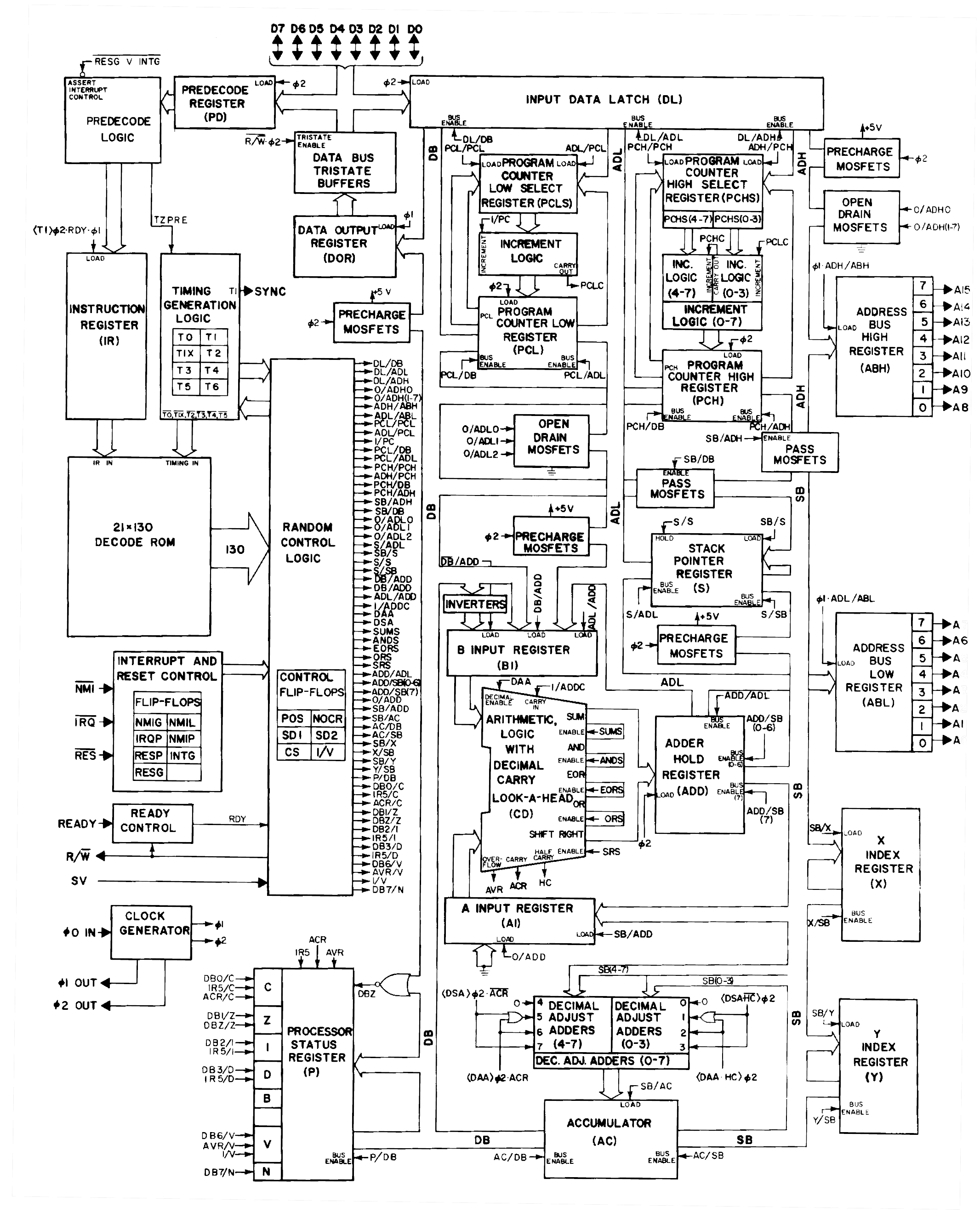

In the 6502 and similar processors which use PLAs, the IR (instruction register), the processor sequencer, and other signals such as the processor flags are provided as inputs to the PLA. The number of OR terms is generally much higher than the number of inputs so that their outputs can be used to control specific logic circuits.
In the 6502, the IR is an 8-bit register, the processor sequencer must represent at least 7 memory cycles (so it's at least 3 bits in width), IRQ, NMI, the ALU flags (NVZC), Interrupt Mask (I), Decimal Mode Flag (D), memory ready (RDY), etc., are inputs to the PLA.
Elsewhere on the Internet there's a block diagram of the 6502 (Hanson's Block Diagram) that shows that the number of inputs signals into the PLA are 21 and the number of outputs are 130. This means that there are at least 42 (true and not true) inputs into the first array of your diagram, and that there are 130 OR gates collecting product terms in the second array of your diagram. However, there's no direct way to determine the number of AND gates used to develop the product terms collected by the OR gates.
The beauty of a logic arrays like the one used in the 6502 is its ability to be tailored specifically to the requirements of the application. As a user programmable element, there's a practical limit imposed by the process used in its implementation. Thus, PLAs tend to have a fixed number of AND terms and a fixed number of OR terms. The 6502 uses a logic array where the number of AND and OR terms is determined by the designer.
As you can also see in the referenced block diagram, there's feedback from the decode logic into the processor sequencer. This feedback determines the next cycle of the sequencer. Because the designer used a PLA in the implementation, at each state in the sequencer, the designer is able to take a branch to the appropriate next state with a minimal amount of logic. Further, the state transitions equations have access to the current state of all critical signals and the instruction register. Together, the decode logic and the sequencer can minimize the number of distinct states required to implement the complex addressing modes of the 6502.

File comment: 6502 Block Diagram - Hanson
