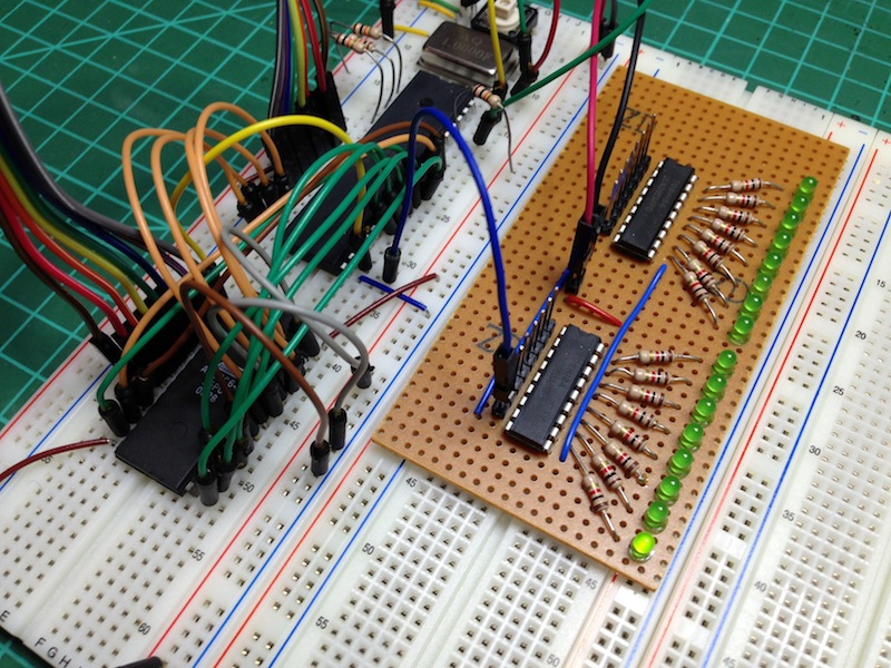

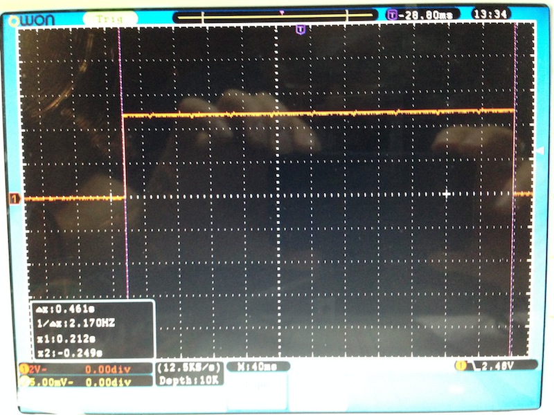

Having an LED blink was my second step toward a complete system. It worked out of the box without any problems. The pictures shows the blinking LED.
I also calculated the number of cycles and the time that each outer loop should take. I could then proof that my calculation was correct, measuring the time with my oscilloscope.
Exactly the calculated 461ms (460547 cycles at 1MHz) showing up for the high- or low period of the two loops.
I had no unconnected addresslines, because A15 to A13 are connected to an 3-to-8 decoder and A0 to A12 are connected to the address lines of the ROM. all data lines were also completely connected between CPU and ROM. /OE on the ROM was connected to the highest output of the 74hc138 causing my 8k ROM appear at $e000. R/W on the ROM was pulled HIGH to make sure that only a READ is performed.
Writing Code for a RAMles system is a bit annoying, because you have to write code without using stack or memory, so you have to write multiple blocks of the same code instead of jumping to subroutine with JSR.

         ; ( 256 * 7 cycles + 7 ) * 256 + 3 = 460547 cycles

There is also an article about that: "http://www.ichbinzustaendig.de/2013/09/26/mouse-erste-schritte.html", but you may need to translate it, because it's in german.
Mario.

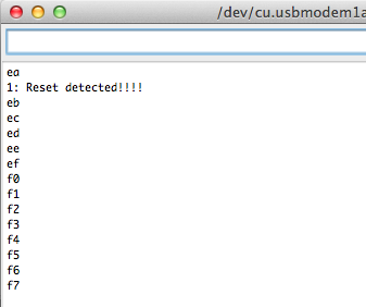

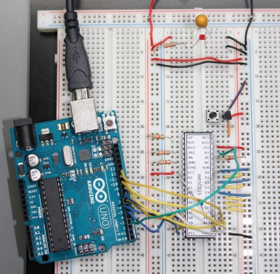

For those of us without a logic analyzer, the first steps of a free run (without ROM) will work with an Arduino. Based on Coronax' example (http://coronax.wordpress.com/2012/11/11 ... n-circles/), I set up a 65c02 with the A15-A08 address lines leading to digital input pins of the Arduino. An output pin provides the clock.
The output is a bit basic -- just the high byte of the address -- but, meine Güte, it's alive!
I'm not sure if the Arduino is fast enough for a 1 MHz clock can, will try to find out in the coming days. The little thing is really cool. Just should have bought the Mega for the extra I/O.

I can now state that the Arduino method of signal detection works with a 1 MHz system clock (comment out the delay instruction). I'll be rewriting the sketch for more general use when I find the time, though blinking lights are more dramatic, I must admit.
