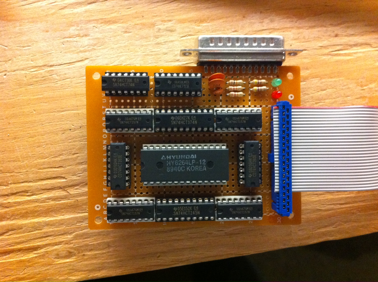

I made a ROM emulator a while ago that I'm re-visiting. Right now it supports up to 8k as I didn't want to use more parts but I need to make it support up to 512k or so. The way it works is that you connect it to your computer's parallel-port and then simple type 'copy test.bin lpt1:' which will then copy the contents of that file to RAM. During that time your CPU will be disconnected / execute crap code so you'll need to reset it afterwards. Still, the process takes under a second.
From a technical point of view, it's based around a 74hc123, which is a 'dual re-triggerable monostable multivibrator' and a flip-flop (the top two IC's), counters, multiplexers and a latch. The first half of the 74hc123 acts like a watchdog circuit and switches the address / data bus on the negative pulse of the parallel-port strobe. The positive edge then drives the busy / ack signals as well as performing the write to RAM and clocking the address counters. As long as it receives strobes from the PC, it'll keep the CPU off the bus. Once the file is done, it times out and resets the flip-flop to switch the CPU back.
I'm regurgitating all this from memory but do have the schematics somewhere. If anyone has any requests as to what they'd like to have, let me know..
-Yvo

Location: Seattle
Yeah, I'm planning on putting it up as soon as I redesign the board. On that note, one of the things I was considering was making separate daughter PCB's that would route the signals the right way. I.e. 24, 28 and 32-pin boards with perhaps some jumpers on there to select different devices.
