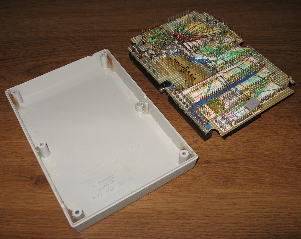

I am going to give WW a go on my 6502 project. I've read Garth Wilson's detailed WW Q/A but, I didn't see much about discrete components.
I know you can get IC WW sockets (which are more expensive than I would like), but say I have just a few resistors and caps; do I need to solder them to some sort of post?

The two little pictures about 1/4 of the way down the wire-wrap page are the main ways to add discrete components in wire-wrapped circuits.  If you instead put the leads of the components down through the holes and wire-wrap them, you need to solder them, because either their leads are round and won't bite into the wire at all to make the chemical weld, or, even if they're square or rectangular, they're not the right size for the tool to achieve that quality chemical weld.  Another thing you have to be careful of is that component leads are not nearly as stiff as WW pins, and they easily bend over to touch something they shouldn't, and that is made worse if the prototyping board doesn't have pads to solder the components' leads to to keep them from rocking.
Wire-wrap is kind of expensive, but I figure that it's not bad when you count your time.  The cost goes way up with WW PLCC sockets, but is still worth it in some cases.

I noticed that you have some sort of wire mask on the bottom in this pic:
Is that just like a label you printed out?

They are commercially available labels like the one shown for 20-pin DIPs at http://www.jameco.com/webapp/wcs/stores ... 1_38586_-1.
I see Jameco has the Vector WW pins I showed, at http://www.jameco.com/webapp/wcs/stores ... 1_34155_-1, $10 for 100 pins.
