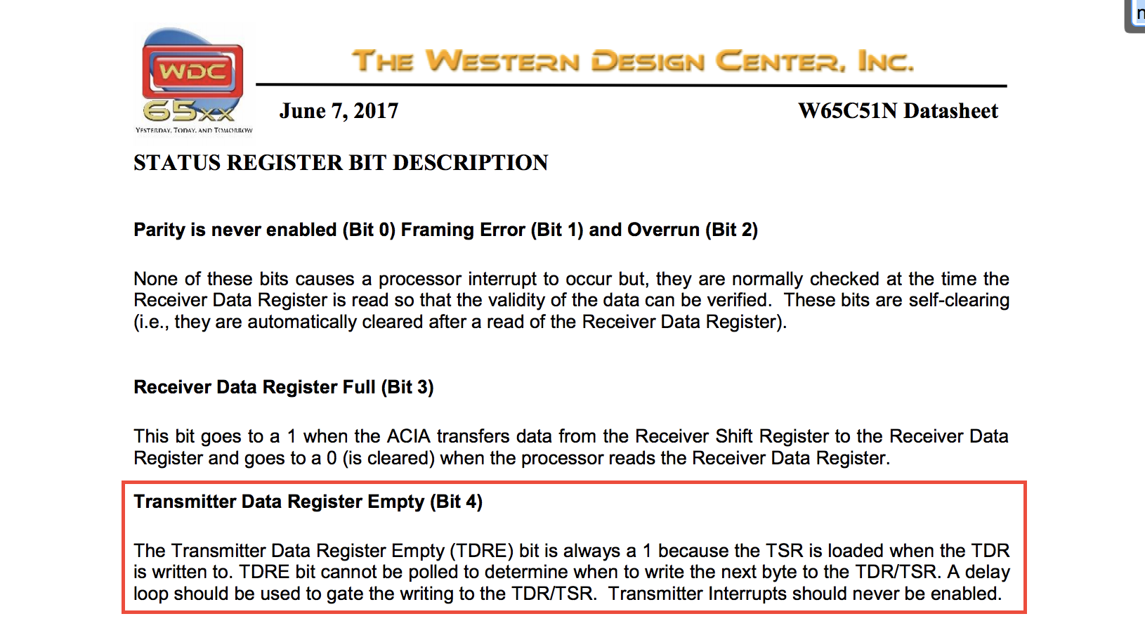

PostPosted: Mon Jun 12, 2017 10:14 am
Posts: 172
Location: Sweden
Just noticed that the datasheet has been updated recently, i'm guessing from the wording that this isn't ever going to be fixed :/

PostPosted: Mon Jun 12, 2017 12:17 pm
Posts: 1373
So they've updated the datasheet to rename the bug in the chip to a "feature". I think this basically seals the fate of the chip. I don't see them making any more chips as they likely had enough quantity made to fulfill expected needs going forward. Based on the newly discovered feature, I doubt they'll ever run out and as a result will never need to make another production run. That's too bad in my view, but it is what it is.
PostPosted: Mon Jun 12, 2017 12:24 pm
Posts: 10793
I think this illustrates one aspect of the economics of chip design and manufacture: it's really cheap to make chips in quantity, but quite expensive to make a design in the first place. WDC seem to have discovered that they cannot afford to correct their bad design - they think they'd get insufficient revenue from a fixed part, so they won't fix it. It's not unusual for a first cut of a chip to have problems, in fact it's normal, so the cost of a second cut is usually priced into the project cost. But if you don't have the resources, or the techniques, or the culture, you have a risk of introducing a new bug when you fix an old one, or when you update a product to run on a different process. That can be expensive, as WDC has found it - it's clear that they would prefer not to have boxed themselves into this corner.
PostPosted: Mon Jun 12, 2017 4:20 pm
Posts: 8154
This is the age in which we live. We can't come right out and admit that a product has a defect and won't correctly function.
Good analysis. Sales of the 65C51 have likely been extremely poor, not surprising when one considers that the design is out-of-date and quite limited when compared to newer UARTs. About all it has going for it is the ease of attachment to the 65C02 buses. It seems WDC has ended up with a chicken-and-egg situation in which they can't sell the defective devices they have in order to produce the revenue needed to redo the design and produce a fixed UART that will sell better. That's assuming they actually know where the defect lies in the present design.
The 6551 was never a good design, but at least the non-WDC parts worked as advertised. Being forced to use PIO during transmission should be a deal-breaker for anyone who values performance and code efficiency, especially since it is necessary to busy-loop the MPU just to accommodate a chip defect, or set up an overly-complicated timer-generated interrupt to tell the MPU when the 65C51 can accept another datum for transmission. With so many other UARTs readily available, devices that are capable of much higher speeds, have more fine-grained control features and no defects, why anyone would consider the 65C61 baffles me. :roll:
