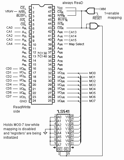

In my search for something not as hard to find as the 74HCT612 the Cypress CY7C130 Dual-Port RAM seemed to me as something that might be applicable.
If used as a Mapper, one side would be Read/Write and the other side held at Read-only.
http://www.sdiy.org/richardc64/vx2/7c130mmu2.gif
Ten Address bits are more than enough to divide memory into segments smaller than 8K and still provide many sets of maps. The built-in Arbitration (/Busy and /Int,) would be of no use to me in a VIC20 but might be useful in more sophisticated systems in which there might be conflicts while WRiting to the 7C130 in I/O space. You guys would know better than I.
The 7c130 is a bit pricey ($10.90 from http://www.futurlec.com/Memory/CY7C130-30PC.shtml ,) but I think its capacity and ease of interfacing might be worth it.
