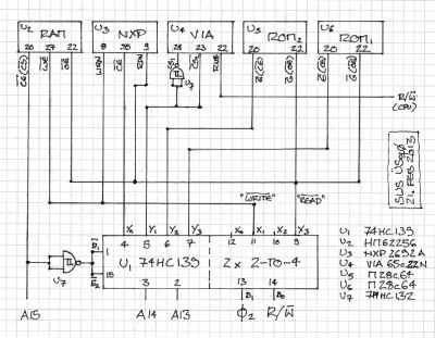

So I think I have my first draft for a memory map and the chip select logic worked out. If I might run it by the group -
Chips: WDC65c02, 62256-80 RAM (32 Kb), NXP 2692A UART, VIA 65c22N, 2 x 28C64-150 EEPROM (each 8 Kb, two distinct chips so one socket can be used as a EEPROM programmer).
Rough map:
0000:7FFF RAM
8000: start of NXP 2692A
A000: start of VIA 65c22N
C000:DFFF ROM 2 (EEPROM socket)
E000:FFFF ROM 1 (Bios, Monitor)
Since we are on 8k segments, the pin table only requires A15, A14, A13, as well as Phi2 for RAM. Ignoring that chip select lines are low for the moment, because it hurts my brain to do both steps at once, that gives us:
Phi2 A15 A14 A13
1 0 x x RAM
x 1 0 0 NXP
x 1 0 1 VIA
x 1 1 0 ROM 2
x 1 1 1 ROM 1
Again, the result will have to be flipped for the actual chip select signals, which are low.
Now I've worked out that I could use four 3-line NAND gates and four 2-line NAND gates (three of them for negating signals, one for Phi2/A15 to RAM). Unfortunately, the only available 3-line NAND package seems to be the triple 3-line NAND 74HC10, which means I would need two of these chips (and one 74HC132 four 2-line NAND Schmitt trigger). That's three ICs in all. Unfortunately, the 74HC10 doesn't seem to have a Schmitt trigger. Worse, I don't think the design will call for a more 3-line NAND gates, so two-thirds of one 74HC10 would be wasted. That's not elegant.
However, looking at the bit table, I am wondering about a different approach.
1. For the RAM, invert A15 with a NAND, and NAND that with Phi2, as before. That's half of a 74HC132. I should be able to use the other half later -- one NAND will be needed with the reset button for the Schmitt trigger, for instance.
2. Now, for the other chips, use a 2-to-4 line decoder (half of a 74HC139), and NAND each of its output lines with A15, using up a full 74HC132. Three chips as well, but the output will be Schmitt triggered ("schmitted"?). The second half of the 74HC139 could be used for something in combination with the VIA or NXP, if only to drive LEDs (my kids love LEDs, and it looks like I'll be putting them in, like it or not). I'll figure that out later.
What I'm not sure about, though: The datasheets give a propagation delay for the 3-line NAND 74HC10 of 9 ns and 11 ns for the 2-to-4 74HC139. I have no feeling for how important those 2 ns are in the real-world -- any guidance on this? I'm planning to run everything low-speed, with anything above 1 MHz "nice to have".
So that's the plan so far. I'd be grateful for any corrections or suggestions, of course ...

You could make your address decoding even easier. Put A13-A15 into a 3-8 decoder & phase2 into one of the active high enables. That divides the entire 64K into 8K chunks like you have. You will need each the top 4 selects from the decoder for each of your I/O & ROMs. The lower 4 selects you would logic 'OR' or 'NOR' for your RAM depending on if you're using the active low or active high enable.
Note though, if you want higher speed later on, your phase 2 should be decoded as close to the device as possible, i.e. last in the logic path. Have a look at BDD's POC v.1 schematic. Notice the signals he uses for decoding the RAM vs. ROM.
The 2ns is not what to be concerned about. Look at the max delay after adding all your delays in the logic path + access times of the device. This will give you a ballpark when you start to push max speeds.

x 1 1 1 ROM 1What's Ø2 doing in there? You should not be qualifying decodes with Ø2. Use Ø2 to qualify read/write only. The 65C22, in particular must be selected prior to Ø2 going high. This is clearly spelled out in the timing diagrams. You want your chip selects ready before Ø2 goes high to give the selected device plenty of time to get ready for access. Using Ø2 as a qualifying signal "throws away" valuable time, since the device won't be ready until some time after Ø2 has gone high and the MPU is expecting access to the device.
In the same vein, qualify RWB with Ø2 so /OE (output enable) or /WE (write enable) of the selected device are not asserted when Ø2 is low. Failure to do so with RAM and I/O devices may cause data corruption. See attached schematic.
As for selecting devices, have you looked at the 74AC138 3-8 decoder (data sheet attached)? I think that is all you would need for this application. It has eight low-true outputs that can drive your devices' /CS inputs. BTW, best to use 74AC instead of 74HC logic.
Propagation time is cumulative, so you can quickly "run out" of time if too much logic is required to decoded addresses into chip selects. The 74AC138 decoder has a prop time of as little as 3ns at 5 volts and no more than 11ns worst-case. If you can figure out how to integrate the '138 into your design as the primary logic then your circuit's speed will be mostly limited by how well you do your assembly.
The 65C22N is an open-drain IRQ part designed to replace the old NMOS equivalent. It has current limiting resistors on the output pins. You may wish to consider the 65C22S. However, it has a totem-pole IRQ output, so it will have to be isolated from the rest of the IRQ circuit with Schottky diode, since the 2692 has an open-drain IRQ output.

Re: Memory map design with 2-to-4 line decoder?
scotws
You can do what you wish with just 1 74HC139 and a single inverter.
Note that the 74HC139 outputs go low when selected and the CS' or CE' pins of the devices you wish to select need to go low when selected - exactly what we need for simple connections.
Connect A15 directly to the RAM CS' pin. This enables the RAM whenever A15 is low, ie for 0000 - 7FFF.
Invert A15 and feed it to the enable input of the 74HC139. Connect the A & B inputs of the 74HC139 to A13 and A14. The outputs of the 74HC139 can connect directly to the CS pins of your ROMs and IO devices. This decodes 8000 - FFFF into 8k chunks like you want.
Note that the Phase2 signal is NOT included in the address decoding. It is not needed. Leaving out Phase2 gives the memory and I/O devices a longer time period for chip selection - not a major problem with modern devices at 1MHz but it becomes significant at higher speeds. Also, the 65C22 needs its chip select to become active before Phase2 goes high, so you cannot include Phase2 in a decoder that selects a 65C22.
Use the other half of the 74HC139 to decode the Phase2 and R/W' signals from the CPU. Of the four outputs, one is READ' (when Phase2 and R/W' are both high) and one is WRITE' (when Phase2 is high and R/W' is low). Connect the READ' output to the OE' pins of your RAM and ROMs. Connect the WRITE' output to the WE' pin of the RAM chip. This enables output from the device when the 65C02 is performing a read and enables a write to the RAM when the 65C02 is performing a write.
I couldn't find a data sheet for the NXP2692A you mentioned. I assume it's a DUART equivilant to the SCC2692. If that's the case, the decoded READ' signal from the 74HC139 connects to the RDN input and the decoded WRITE' signal from the 74HC139 connects to the WDN input.
Don't worry about the propagation delays of 74HC logic if you are only running at 1MHz - at this speed 74HC logic is far more than fast enough. It's only when you get to higher speeds that propagation delays become something to worry about. Using an inverter and a 74HC139 as above, you should have no problems at 4MHz.

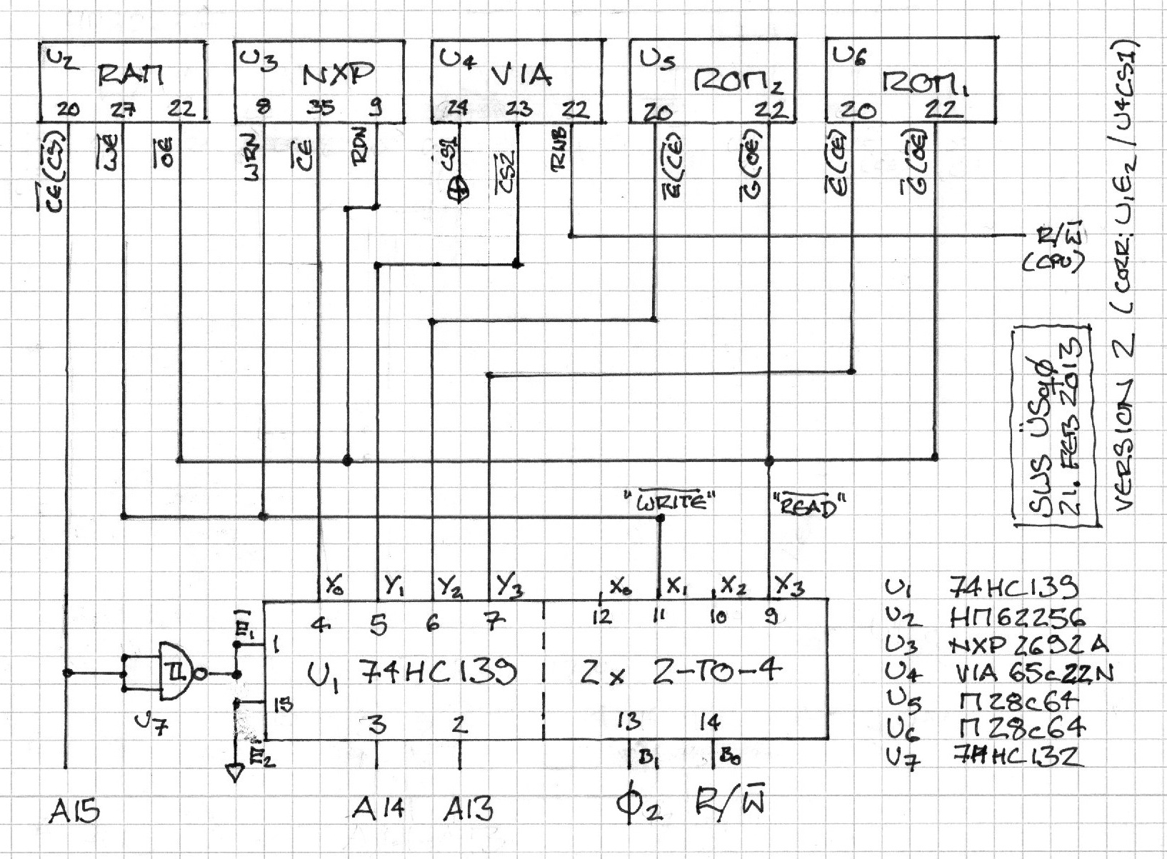

Hi Paul,
Ay, thanks for all the detail! I won't even post what I had been working on for R/W' and stuff -- mentally, I still have this tendency to try to reduce everything to AND and NOT first before thinking, gee, there is half of a 2-to-4 over here ...
I've included a sketch of how I understood your description (pin numbers need to be re-checked, will do that when I'm fully awake). Don't I need two inverters, a second one on the VIA for CS1 (CS2 is low already)? I connected the R/W' on the VIA directly to the R/W' of the 65c02 as per Garth's tutorial example.
Thanks again. I'll try to get my hands on a '139 next week and breadboard a test.

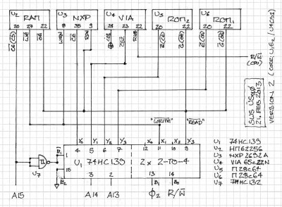

I've noticed a mistake on the diagram you posted. Only E1 on the 74HC139 should be connected to the inverted A15. E2 should be connected directly to 0V. You want this section of the 74HC139 to be permanently enabled. As shown, it won't generate READ' and WRITE' signals when A15 is low, so you won't be able to read from or write to RAM!
As Garth Wilson says, you don't need the inverter to drive CS1 on the 65C22. Just tie this pin to +5V
Otherwise, you have correctly interpreted my ramblings. Hope it helps and good luck!
