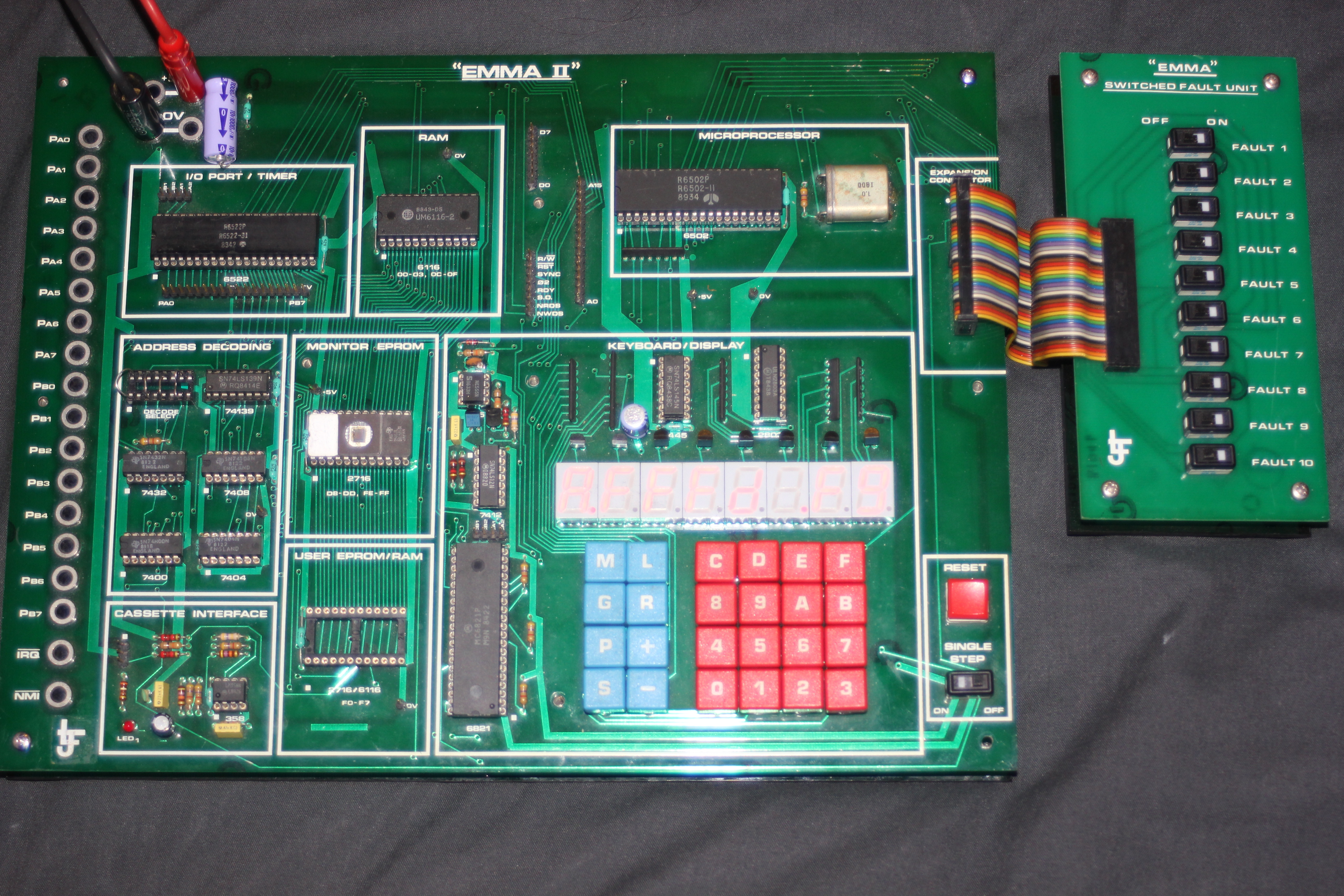

I went on ebay and I bought two of these as spares or repairs. There should be a reasonable picture of one with a "Switched Fault Unit" as an attachment. After some work they both operate. Well, they run code from rom and display memory contents etc. I have yet to fully test them. They had been badly stored and scavenged for parts.
I found a scanned "User Manual" at http://www.ee.siue.edu/~smuren/ece282/l ... manual.pdf .
It refers to the "Technical Manual" and "Experiment manual" which I have been unable to find. If anyone knows of the whereabouts of these I would be most grateful.
It has been many years since I last did any 6502 programming and would like to know what editors, assemblers and simulators you would recommend. I last used dos based sim and assemblers on old 80186 machines.
I'll also need to sort out the programming method for these. It has a built in cassette audio I/O for program save and load. I could use a line in on the PC for saving and loading. I used to use an eprom emulator device many years ago. Writing and erasing UV Eprom is a painful process when coding. I know, because a lecturer made us firstly type in the code on the trainer board for months then use eproms for months. Eventually he walked in one day with the emulator and smiled. At least it made us take care when programming but it still hurts to recall the pain of the process.
Anyway, many thanks in advance for any help.
John

Upon receiving the boards I unboxed the first to find it scavenged for parts. My heart sank badly when I noticed the Monitor Rom was missing. I franticly unboxed the second. To my great relief it was there. There were less parts missing and it wasn't so battered.
My first action was to remove the rom and read it. Upon a successful read and verify I copied it to a blank spare 2716 I had. That was close. I couldn't care if all the other parts were missing as long as I had one good rom.
Repopulating the board, repairing the damage and using some contact cleaner in the oxidised sockets brought them back to life.
So, now I'm on to using them.
Many thanks again

I have been looking into the monitor rom from the Emma 2. It has a contiguous gap of 330 bytes that is address decoded. I was hoping to find some space in there for some of my own routines but I wasn't expecting that much.
So far these routines have been mentioned in the manual.
Data Insert Routine
Display 8
Display routine
Multiply by 10
Multiply by 16
Hex2Dec/Dec2Hex
Branch Offset Calculator
Re-locator
Checksum Routine
Write 4 Characters to display
Display Memory Contents
Display Memory Contents of indirect address
Display Accumulator Contents.
Display 4 Characters
Read the Keys
Output Data to the Cassette interface
Input Data from the Cassette interface
I have found them in the rom using a hex editor. I have also manipulated the rom image to correctly reflect the address decoding of the sections. This I have run in an emulator and it seems to run the monitor program without halting. I have only given it a cursory inspection but I'm happy I have correctly organised the code space.
If anyone has any suggestions as to what I can put in the available space I would welcome them.

Just a thought, maybe some code in that space to program a few bits in the VIA port for communicating with i2C EEPROM or other devices.

That's an excellent idea and I highly recommend it. The 6502 primer's circuit potpourri page has info on it with a sample circuit with explanation and a link to working accompanying code, at http://wilsonminesco.com/6502primer/pot ... ITBANG_I2C. There's a brief comparison of synchronous-serial interfaces at viewtopic.php?t=1301&start=28, with a set of links at the end of the post.
