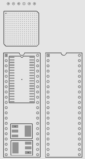

PostPosted: Thu Dec 06, 2012 2:03 am
Posts: 904
YES!
Is there a core that is pin-compatible to the 6502? if yes, how about a board like this:
If we don't strive for pin and 5V compatibility, it's doable. A 3.3V 6502-like device. Otherwise, level-translation is probably inevitable (you can sort of fake it with a resistor).
P.S. I just saw the other threads about similar boards....
You can fit level converters under the board.
I was just talking to Electric_Eye about making a FPGA board that would fit in a 64 pin dip socket, and that would have boot ROM, and level converters for 5V.
I would pay more than 15$ for such a contraption.
I also think other people could be interested, since i can't find anywhere such a compact module that operates on 5V. You could also sell it on ebay. :D
