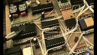

Just came across this: a couple of short videos showing off a "very simple" homebuilt 6502 machine, which apparently took "about a month and bit to design and build, doing a few hours here and there"
(video is a bit dark and shakey, but so are all my photos)
User YT2O95 on YouTube is also user YT2095 on Twitter. I found no blog or website, but we do learn that he previously made a Z80-based machine, and has some collected photos here.

It looks like he started with a slightly modified Micro UK101 and added bits.
I wonder how accessing the 6850 is handled, wait cycles?
That could actually be a MC68C50, and maybe it can work at 8MHz (my 1MHz peripherals work at 4).
What kind of mixed technique of building is that? Ww on pin headers?

well, I had originally planned on replying here a day or so ago, but I got a bit side-tracked reading some of the other threads here, WOW! what a fantastic site this is! I wish I`d known about this place sooner (or maybe not as I`d probably get very little done).
I`ll do my best to answer the above, although there`s really nothing special that was done on my part to make it work.
the CPU although capable of 10MHz is being run at 8.192MHz, the reason was that when I tried 10MHz the whole thing failed, my bottleneck was the EPROM speed (it was a 150nS type), so I decided to buy a 70nS OTP ROM and use that.
things were much better and for the most part working, but the 6850 was the new bottleneck.
it would Recieve ok and send that data to the CPU, but the TX was flakey at best and would lose signal integrity at about 9.5 MHz.
so I backed it off to 8.192 to be on the safe side, its also a nice freq to use in terms of timing calculations.
the RX TX clk is derived from an entirely different cct using a 9.8304MHz crystal (it divides down nicely for baud rates).
so in effect, I went through all my 6850s at different freq`s to find the best ones and highest freq I could safely get away with, and the CERDIP version (whos number has worn off) was far better than the Plastic devices by 2MHz and 8.192MHz was the winning freq.
as I said at the outset, it`s really rather unimpressive and there was nothing really clever done on my part to make it work, just trial and error using the parts that I had really.
as for the build technique, it`s one that I made up several years ago largely out of necessity, WW boards are really expensive and quite a few of the pins never get used anyway, soldering alone is ok if you can solder anytime anyplace (I don`t many who can), so made a Hybrid, this allows me to use only the pins I`ll need, get all the soldering prep work done when I`m well, and when I`m not so well I can still be making ccts doing WW in bed.

On my new cpu board, i got 15ns ram, but the eeprom is still the bottleneck for speed. I use NMOS ic(cheaper) and on my current system i got it to run from the original 1MHz to 4MHz, with all of the components being 1MHz. Since now i kinda have lots of NMOS 6502, i have a CM630P, SY6502, R6502A, UM6502, and an MPS6502. I tested them, and it seems the CM630P and MPS6502 can only get to 2MHz, while the other can get to 4MHz, but they also seem to suck more power.
But in my new system, i plan to have fast buffers on the cpu itself, and also to the backplane. So when the cpu is not accessing any peripherals, it should be able to run at higher speeds.
I wonder how fast NMOS can really go...
Speaking about the 6850, i got three of those 6850 from ebay for rs232, usb, and ethernet. And as in your case, the chip serial kinda faded.
Where did you get the SID chip?

Instead of using fast EPROM, how about using slow EPROM, and copy it to fast SRAM. After the copy, replace the EPROM with the SRAM. Alternatively, load the data from a serial flash chip or SD card.

I started with the 65c02 P4 chips and never really considered overclocking them, then someone mentioned the WDC version at 10MHz (I didn`t even know such a beast existed) so I won 5 brand new ones on fleabay and never really looked back.
as with some of my other computer designs, I like the idea of a chip having Static registers too, so you can stop or step the clock and not have to worry about internal register refresh, so that was another bonus for me, esp after comming from a Z80 build.
the SID chips were pulled from broken C=64`s, I have 2 of them the one starting with the 6 and the other with an 8, both work!
All of WDC's current production parts are rated for 14MHz minimum, and the 65c02's will mostly go to 24MHz at room temperature (although they don't guarantee that). At least one of their licensees for their IP is running a 65c02 core in a custom IC at over 200MHz.
Note that temperature does affect maximum operating speed. If you find it runs up to a particular speed and back it off only a small percentage, it may still fail to work when the temperature gets higher.
