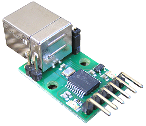

richarde and I used the predecessor to this USB-ISS usb-serial module which offers serial, i2c, spi or 4 bits of gpio for bit-banging. (The predecessor is less capable but the two are now the same price.)
Note that the bit-banging can't be done especially quickly as it takes a USB command to change the pin states.
This module is breadboard friendly too, and can bring 5v supply from USB cable to the breadboard if you don't need much current.

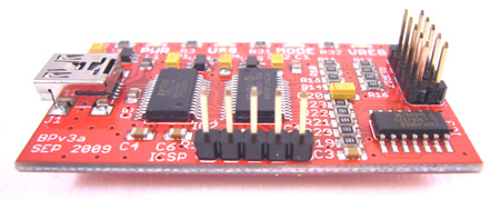

How about the Bus Pirate for $30? (Also available for 25EUR. New model for $40.) Seems to be a near-universal serial and parallel port-style USB adapter (but with just 5 I/Os.)
    USB interface, USB powered
    0-5.5volt tolerant pins
    0-6volt measurement probe
    1Hz-40MHz frequency measurement
    1kHz – 4MHz pulse-width modulator, frequency generator
    On-board multi-voltage pull-up resistors
    On-board 3.3volt and 5volt power supplies with software reset
    Macros for common operations
    Bus traffic sniffers (SPI, I2C)
    Transparent USB->serial bridge mode
    10Hz-1MHz low-speed logic analyzer
    AVR STK500 v2 programmer clone
    Scriptable from Perl, Python, etc.
    Translations (currently Spanish and Italian)
(Never used one, but it's open-source hardware and seems well-established with a forum and so on.)
