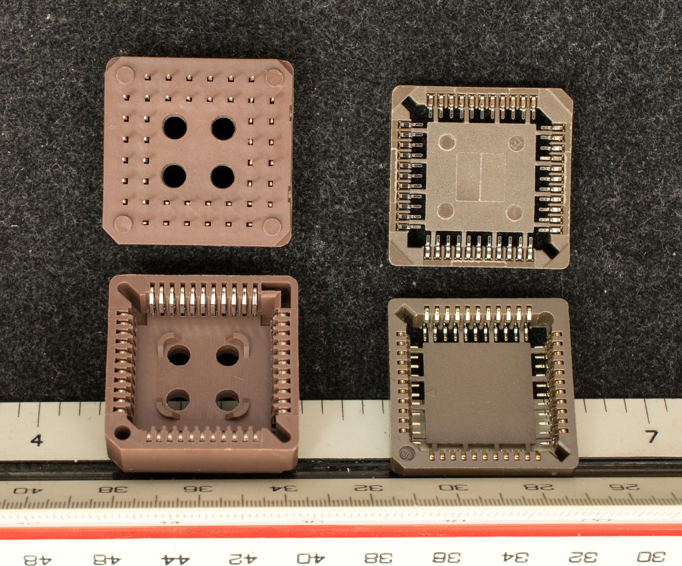

I'm laying out an '816 board. I thought of just soldering PLCCs directly to the board, but I would need space around them to solder them, meaning sockets wouldn't take any more room. Thru-hole sockets kind of precludes putting parts on both sides of the board right there, but SMT sockets cannot be hand-soldered. I'm also staying away from parts so small I'm not sure I could finish a board and not have soldering defects, so I don't think I want to try the PQFPs for this.
It is possible to hand solder SMT PLCC socket. With sufficient practice, the level of difficulty is comparable to hand soldering 0.5mm pitch QFP. I use a fine tip with 30 degree bend, Metcal STTC-026. The bend helps get around the plastic webbing of the SMT PLCC socket. SMT PLCC socket is bigger than PLCC IC, so you do need to allocate more space around a PLCC if you plan to use a socket.

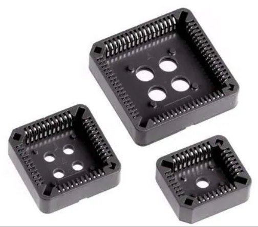

What brand of PLCC sockets are you using? I was thinking of this kind, where the contacts are not accessible at all for a soldering iron, being completely underneath and covered:
The problem is the access, not the pitch.

Garth,
These are unusual SMT PLCC sockets. SMT socket's contacts should be visually inspect-able to check for proper solder joints. Photo shows my SMT PLCC44 socket on the right; the PLCC44 socket on the left is through-hole PLCC socket.

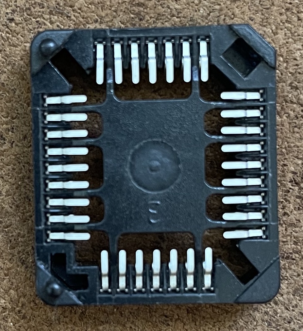

I also found a PLCC-32 SMT socket that has mounting studs. This should make alignment much easier before hand-soldering one of these.

The mounting studs are nice alignment feature. The hard part about soldering the SMT PLCC socket by hand is not burning the central plastic webbing which is located very close the the soldering tabs.
I'd be tempted to take an X-acto knife and cut the little strands, then remove that little rectangular "floor" before the soldering even begins. Is the darn thing even necessary?
Alright, I guess maybe it's supposed to limit the depth of insertion of the PLCC into the socket. But you could wait until the soldering is done then put the little rectangle back where it belongs... secured to the PCB with a dab of adhesive. Hmmm...
That stuff might be more temperature-resistant than one might think. After all, the socket has to be able to withstand reflow temperatures of ~450°F for at least 30 seconds.
Where did you find it?
If your using a low temp solder paste the temperature should not affect the plastic.

Do you have side/angle shots that show how far the contacts extend below the bottom of the socket base?
I guess it's about the same as the stand-off height.
