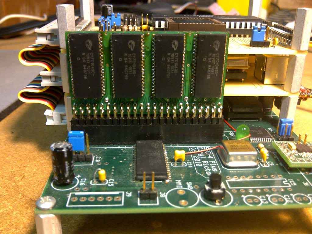

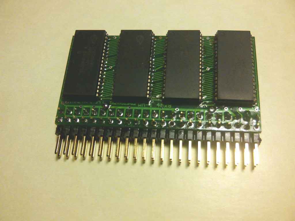

Hi All,
Garth Wilson has designed and created a 4MB SRAM module that can be used for our projects. I have tested these on my SBC-4P and they work great. They are very compact and did not seem to add a significant amount of bus loading to my system. I was able to run my SBC-4P with three expansion cards and the memory module at 12MHz without any issues.
These will be perfect for applications that require a large amount of SRAM without taking up acres of board space.
The board has SRAM chips on both sides - 8 total.
Here are a few pictures of Garth's module:
Daryl

Below is some of the info on the module. Pictures are already above.
  • 4Mx8 5V SRAM module, 2.300" long x 1.234" wide, not including connector
  • has eight 10ns Cypress CY7C1049D-10VXI 512Kx8 5V SRAMs, four on each side. See Cypress data sheet at http://www.cypress.com/file/221601/download (Keep the total capacitive bus loading in mind when estimating actual speed performance predictions.) Note, 9/28/18: Cypress occasionally makes teensy changes in the silicon process or bond wires or something else that has zero effect on us hobbyists, and then change the part number, and then people look it up and get scared thinking it's been discontinued. No, I'm sure they'll have it available for many years to come, maybe decades. I have a legitimate business and a resale number, and I buy 100 at a time from commercial Cypress distributors in the U.S. who don't sell to mere hobbyists, at half of Digi-Key's price. Edit, in 2020: When I went to buy more SRAMs, Cypress's prices had gone way up, so I went to the ISSI equivalent, whose data sheet is at http://www.issi.com/WW/pdf/61-64C5128AL.pdf .
  • six embedded (for minimum inductance) .1uF bypass capacitors
  • four ground pins and two Vcc pins, distributed so no signal pin is more than .2" away from a ground or bypassed Vcc pin
  • eight separate CE\ pins, so you can get faster selects by handling the computer's entire address-decoding scheme with a CPLD if desired than you would get from adding a 74xx138 to this plus the computer's other address-decoding logic
  • two WE\ pins, one for each set of four ICs, so your circuit can write-protect half at a time if desired
  • two OE\ pins, one for each set of four ICs
  • two-layer board's high-speed performance is maximized by unorthodox layout and bypass chip capacitors under the ICs actually embedded in the board for minimum inductance
  • 46-pin dual-row header of .025" square posts on .100" centers, to plug into readily available, inexpensive thru-hole sockets on your prototyping boards (I can supply the sockets too)
  • symmetrical pin-out lets you plug it in backwards and it will still work! (This is possible with SRAM because as long as data lines go do data pins, it doesn't matter if they get mixed up; the same goes for address lines, and the same goes for CE\ lines. I have also done this with EPROM to make the board easier to route, and then used a programming adapter.)
  • available with straight or 90° pins
  • partial assemblies in increments of half megabyte available for lower prices, using the same board. Even if you only get one or two SRAMs on the board, one advantage to you may be the easier assembly of your computer because of the pin header (ie, not having to solder with SMT-only devices), less time required to build your computer, be able to build it on perfboard (although for such fast parts I still recommend using at least a ground plane on one side like Twin Industries' 8100-series protoboards ( http://twinind.com/subcategory/plated-t ... ngle-power ) if not also a Vcc plane on the other side like Twin Industries' 8200-series protoboards ( http://twinind.com/subcategory/plated-t ... dual-power ) and keep parts as close together as possible and wire-wrap wires as short and straight as possible without straining them.)
Edit, 2/25/12: Data sheet now available at http://wilsonminesco.com/WM-1_4Mx8SRAMmodule1-2-17.pdf . Later updates for Cypress' updated data sheet on the ICs. Edit again: Updated http://wilsonminesco.com/WM-1_4Mx8SRAMmodule4-23-20.pdf

PostPosted: Sun Sep 18, 2011 3:40 am
Capacitors embedded in the board? Cool! That would be underneath an IC, then, right? I've wondered about trying something like that. Care to share the details, and a photo maybe? Sounds like you'd have to use a chisel or router to create a cavity in the PCB material...
ps- lovely job on the RAM module!
