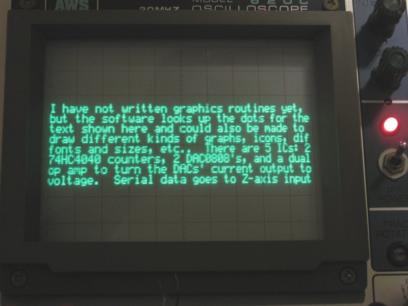

For simple raster graphics using an analog oscilloscope in X-Y mode, I built a circuit whose counter ICs are fed from the clock line of a 6522's synchronous-serial port, whose data line goes to the Z-axis input. Here's a photo:

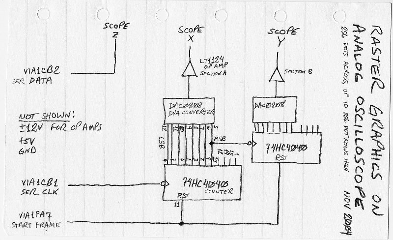

Here's a simplified schematic of it (just omitting some resistors and capacitors):
It just takes three pins of the 6522: two for the serial interface and one to reset the frame to start. As you can see, you could make any character you want, any font, and monochrome binary graphics. The 6522 takes constant babysitting though, so to keep the display going while your processor does something else, one way would be to make a separate, very simple computer to take the data and buffer it and run the display.
I should probably interlace it to cut the perceived flicker when scanning a lot of rows at a rate that everything can handle. It would requiring switching a couple of wires and changing the software. The down side would be that the frame height in number of lines can't change on the fly. I'd have to put in a DIP switch.

PS to Garth: do you think your tidy little X-Y-Z circuit could be simplified even further? I'd be tempted to replace each DAC chip with a set of eight binary-weighted resistors. And, since a 'scope is the only load, then the op-amps and the 12V supplies could be eliminated, too. :D
The tolerances of the msb resistor values would have to be about 0.2%. Maybe you could just add trimmers in series to those and live with 1% resistors. Hopefully all the counter outputs would pull up or down to identical distances from the rails (within 10mV of each other).
I use ±12V for a lot of things though, so it made sense to run it over there. Having it frees you up to do all kinds of things. The exact amount is not critical at all, and usually you're ok if you're in the range of 8 to 13V. For the oscilloscope raster-graphics circuit above, you need at least about ±7V. If you only have a 5V supply, you can get close to double that with modern variations on the 7660 8-pin switched-capacitor voltage doubler/inverter IC, like the National Semiconductor LM2662, Linear Technology LTC1044A, and MAX660, and use another such IC to invert to get the negative. This is definitely not an exhaustive list. These all take only three external capacitors. Some can deliver more current than others (the MAX660 being good for 200mA), and some can handle more voltage than others (another one being good to 15V). You won't need much current on these voltages anyway. Negative-voltage LCD bias for example is not even 1mA.
Yeah, I guess to build a resistor DAC there would be some fussing involved, although not too bad. Years ago I built a pair of resistor DACs, and had instant success. But that was with the advantage of using a set of high-precision resistors salvaged from a Linotron phototypesetter :D BTW I see your point about the 12V supplies -- it's really not a big deal to provide those.
