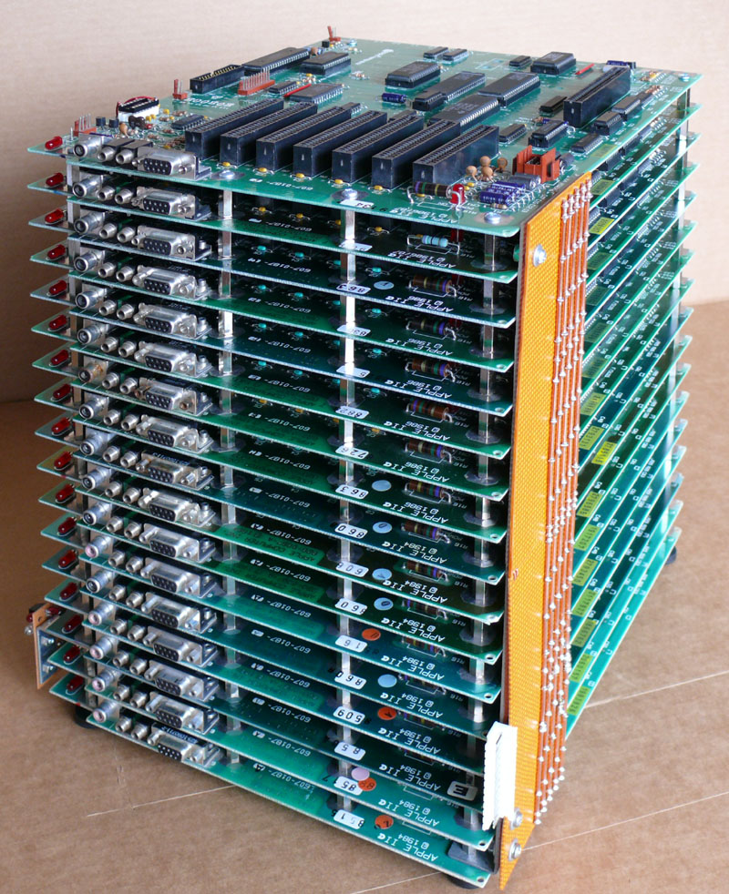

AppleCrate - parallel computing on 17 apple IIe boards
See here (and the earlier 8-board system)
It's networked up (and network booted) using NadaNet, and can be used for multi-voice sound synthesis.
(By Michael J. Mahon – July 26, 2008, Revised – May 7, 2010)
(seen here)
Arlet
Joined: 16 Nov 2010
Post by Arlet »
I wonder how hot it gets :)
He'll be fine - there's no power supply!
But seriously, the earlier system was better arranged for convective cooling. I'm a big fan of fanless computing. (No pun intended.)

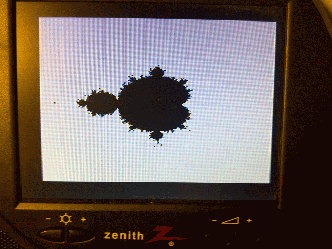

The CC65 package has a Mandelbrot Generator in the sample code. I adopted that for the SBC-3. The code took 7 minutes and 46.4 seconds to run (65816 clocked at 7.1MHz generating a 320x200 color display).
Here a picture of the results:
The article was very impressive. I would like to use some of that code in the future, when I can get the time.

The code in the article can be sped up in a number of ways, such as using a smaller timeout value than 256 (e.g. 32 as in CC65). 7.1 MHz compared to 1 Mhz Apple II (or 2.5 MHz Apple IIgs) helps too, of course, as would using 16-bit native mode on the 65C816. (I thought about replacing the multiply routine with a faster table-driven technique, like 4AB = (A+B)^2 - (A-B)^2, but I never got around to doing much about that.) The BASIC loop in lines 300-550 would be much faster in assembly, since the all the necessary values already pre-computed; the FP math would be replaced with fixed point math (and the FP to one's complement fixed point conversion wouldn't happen inside the loop any more, nor would saving/restoring the ZP each time), and so on.
One modification I made was to separate the calculation from rendering. I just stored the data in RAM, then I could apply coarse value coloring or fine value coloring to the same data without having to recalculate the data (which was the slow part). (The built-in BASIC graphics routines were ROM-space-optimzed, and thus slow; redisplaying the image was fairly quick using speed-optimized routines.)
