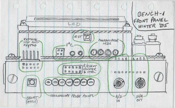

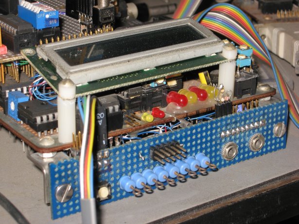

Finally, real computers have blikenlights. I want to add LEDs so you can see the state of the buses and stuff. (Probably more useful once I add a single stepping mode.) What's the proper way to do that and avoid causing problems?

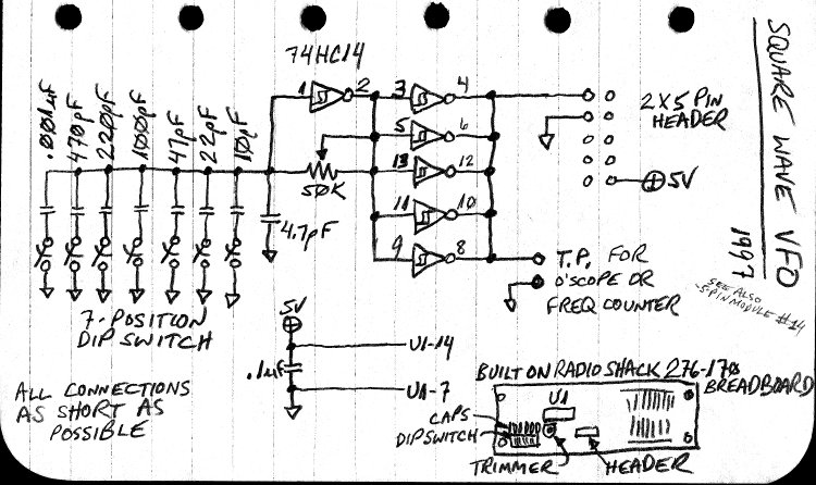

... I've noticed a lot of you start with a slower clock speed and then crank it up until it stops working. Do you just use a fixed clock and then swap out the crystals, or is you use a variable clock speed design? If the latter, how do you build one?...
An easy circuit I'v used in the past uses a VCO (voltage controlled oscillator) using a 74S124. You can change the values to get it down to slower speeds.

Clock oscillator cans are the easiest. You can get half-size ones that fit in an 8-pin DIP socket to save space. To get the best symmetry, you could put it through a flip-flop to divide by 2. For the reset circuit, as long as it's a CMOS (not NMOS) 6502, you can just hang an RC on the RST pin since it's a Schmitt-trigger input, but that can cause problems with your I/O circuitry since it may not all have Schmitt-trigger RST inputs or their thresholds may be different so they might not be ready for business yet when the processor addresses them in the RST routine. You can put the RC on a gate with Schmitt-trigger inputs, and run its output to the RST\ line to the processor and other ICs that need it. My circuit is here.
B. I made a variable-frequency oscillator, and measure the frequency with my frequency counter. Here's the first one I made:
I made a much smaller and faster one later, but this will do the job for beginning construction, and the faster stuff (100MHz) is more of a challenge to build and make it well behaved.
Lights for the buses won't do you any good unless you can use a pushbutton to advance the clock one cycle at a time and record all the bus status to substitute for the expensive logic analyzer you don't have. In thoser rare situations, I've just used the oscilloscope probe. A logic probe would do just as well. The LEDs will add a lot of unwanted bus loading. Even if they're fed by buffers, the buffers will add capacitive loading to the buses. I'd say skip it. I do like to have a few annunciator lights, but they're not so much for debugging. See my tips #35, 36, and 37 at viewtopic.php?t=342&start=35 . I brought some common oscilloscope probe points out to the front of the computer for easy access: IRQ\, NMI\, A/D input, D/A output, A/D CS, #4 LED, VIA3_PB6, and VIA3_PB7. They are the eight hooks with the light-blue bases along the bottom in this picture:

Ok, maybe the blinkenlights aren't such a good idea. Although, I do plan on implementing single-stepping. Hacker folklore about old dinosaurs with lots of lights is somehow appealing to me. I guess I'll have to make an LED bank IO device instead. In retrospect, it'd probably be more useful anyway as then they'd be under software control, rather than just flickering away at imperceptible speed.
