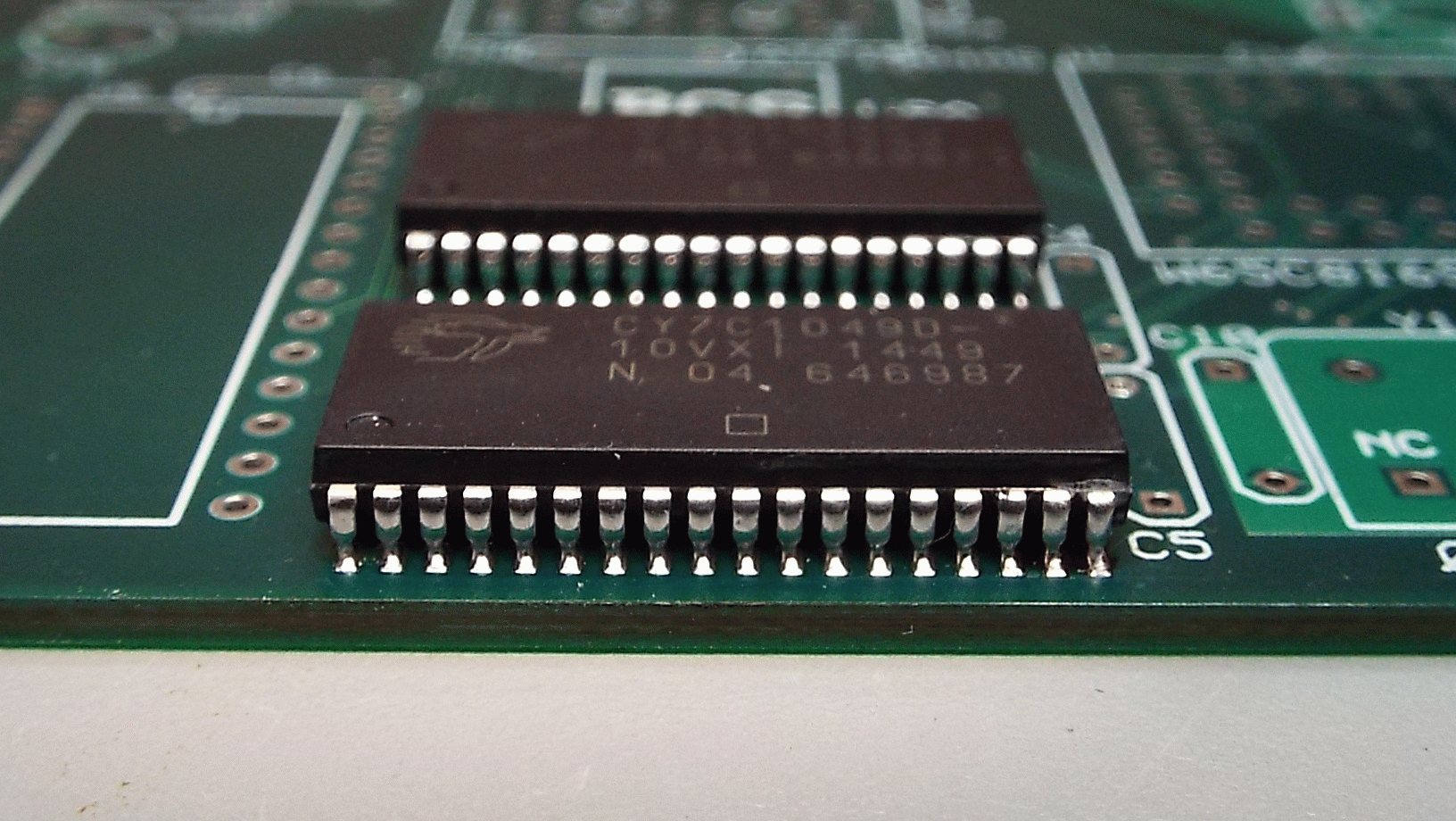

Garth took care of soldering the two static RAMs and the Ø2 clock flip-flop—which devices are SMT—to the PCB, and did a very nice job of it. The balance of the components are through-hole, which, despite only having vision in one eye, I should be able assemble. With any luck, I'll soon be ready to put power to this thing to see if it goes or blows. :D
Some pics follow.
File comment: SRAMs & Flip-Flop

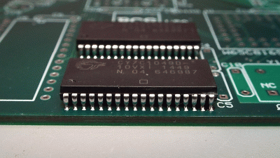

Above are the two SRAMs (512KB each) and a 74ABT74 flip-flop, the former in SOJ36 and the latter in SOIC14.
File comment: SRAM Close-Up
Above is a close-up of one of the SRAMs so you can see Garth's handiwork.

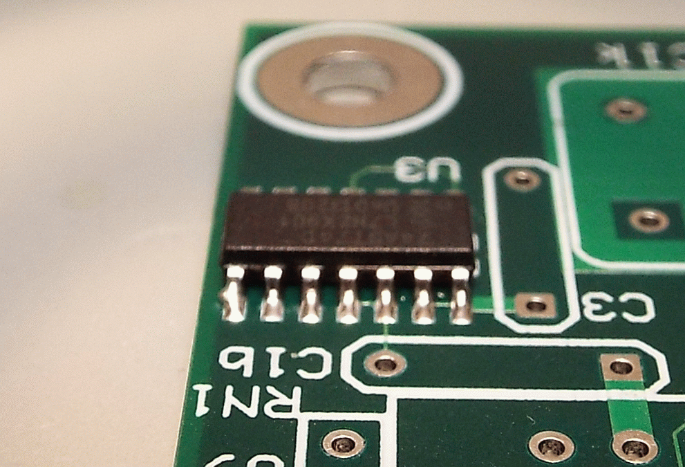

File comment: Flip-Flop Close-Up
Above is a close-up of the flip-flop. These SOIC14 packages sure don't take up much room. :D For some reason, my camera kept trying to focus on the silk screening in the foreground, making the subject (the flop) a bit blurry.

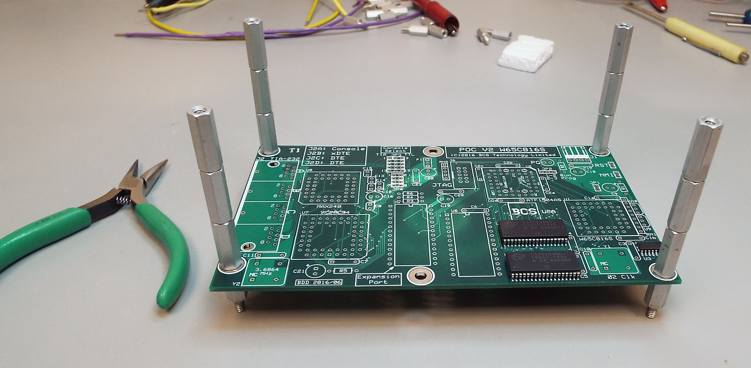

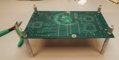

File comment: PCB Ready for Assembly #1
File comment: PCB Ready for Assembly #2
Above is how I set up PCBs for assembly. It's nothing fancy—I've been using this crude method for some 40 years. I put rubber caps on the long ends of the standoffs so the assembly doesn't slide around on the bench whilst poking it with the soldering iron. The caps are 8mm vacuum caps commonly used on automobile engines.
I'm embarrassed to admit I'd never have thought of doing that. That would have been a very handy approach when I was soldering up my MAXI09 board (25cm x 20cm or so). Oh well, I'll do that next time.

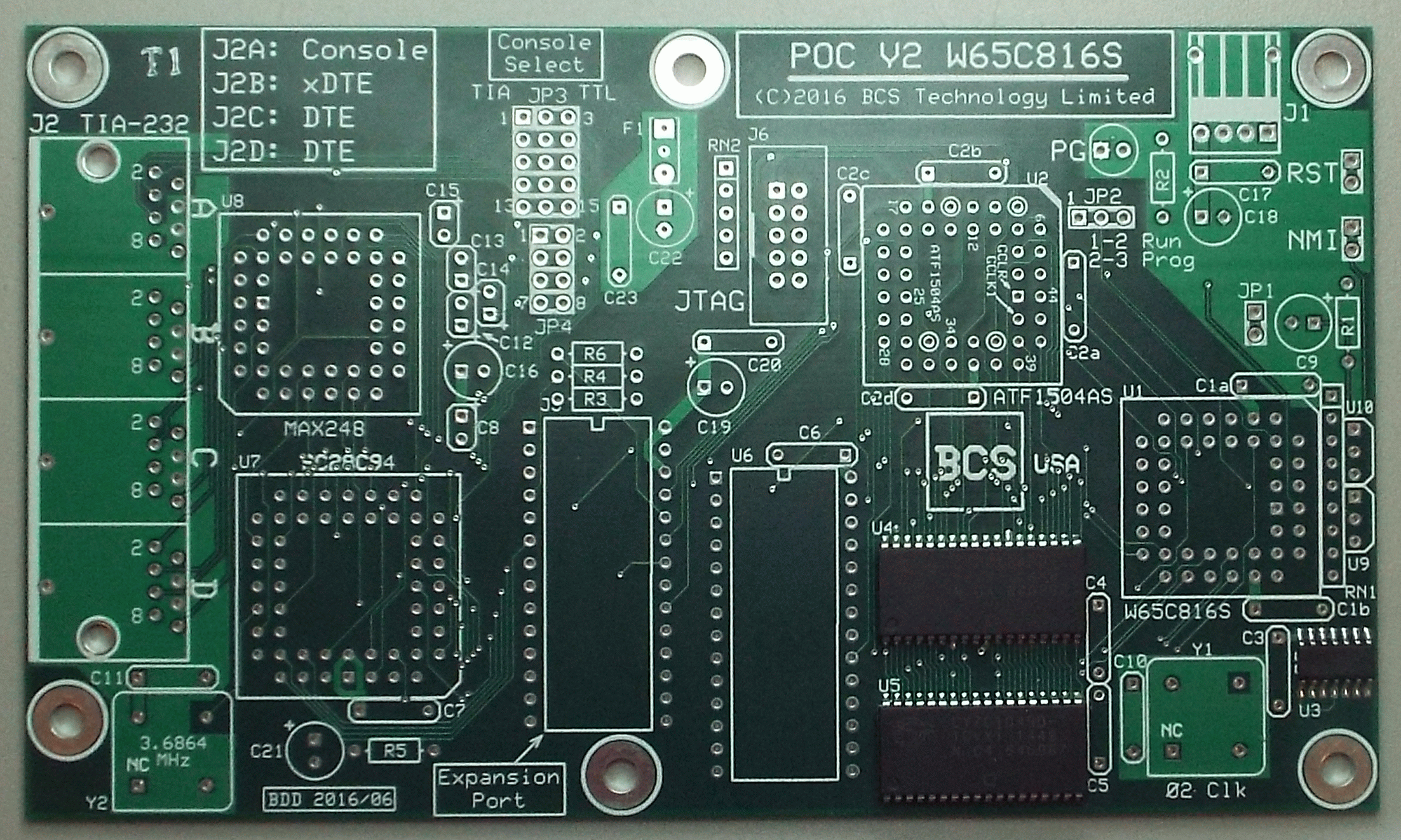

Here is the memory map for POC V2:
           +——————————————————————————+ $0FFFFF
           |  Extended RAM  (960 KB)  |
   +———————+——————————————————————————+ $010000
   | HIRAM |       HIROM (8 KB)       |
   +———————+——————————————————————————+ $00E000
           |      HMU (0.25 KB)       |
           +——————————————————————————+ $00DF00
           |   D-Block RAM (1.75 KB)  |
   +———————+——————————————————————————+ $00D800
   | IORAM |    I/O Devices (2 KB)    |
   +———————+——————————————————————————+ $00D000
   | LOROM |       LORAM (4 KB)       |
   +———————+——————————————————————————+ $00C000
           |     Base RAM (48 KB)     |
           +——————————————————————————+ $000000
At reset, ROM is mapped in at $00E000-$00FFFF and I/O is mapped in at $00D000-$00D7FF. Everything else except the hardware management unit (HMU) appears as RAM.
The HMU, which is a set of registers in the ATF1504AS CPLD, is defined as follows:
