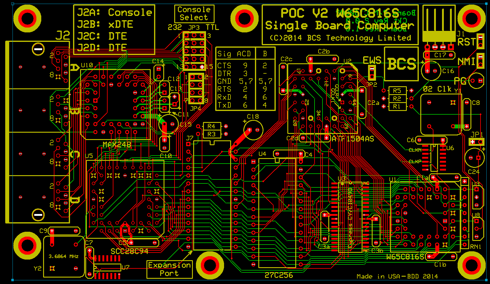

You seem to have quite a penchant for sockets oriented on the board at integer multiples of 90° ...
have you considered the possibility of other angles, like 45°?
Enso's Chochi is an example of what I'm suggesting.
Mike

There are a few situations where 45° makes it easier to route an IC with lots of pins; but usually it just takes more space that way. My own CAD will only do multiples of 90°. What I have done, on very few occasions, is to make a separate component like a thru-hole resistor or diode in 45°. I do not limit my trace angles though. They can be anything, not just multiples of 45°.
BDD, some of your vias appear to be too close to other traces, like near the middle of U4. Do they actually meet your design rules?
I actually did a layout with the CPLD (ATF1504AS) mounted that way. The problem was that now the effective north-south footprint of that device was much larger, and that impinged on space needed to route traces in the vicinity of the SRAM. It just didn't fly. In this application I haven't seen where 45 degree placement is of value. I will look at doing so with the CPLD in POC V3, as that device will be a PLCC84 package.
Yes they do. The via diameter is 0.026 inches, I'm using 0.006 inch wide traces and the layout is on a 0.025 inch grid. Therefore, the clearance between the via in question and the nearest trace is .025 - (.026 / 2 + .006 / 2), which is 0.009 inches. EPCB requires that a minimum of 0.007 inches clearance be maintained between traces and other objects, so that location meets that rule with 0.002 inches to spare. When I transfer the layout to an image file the via always seem to look bigger than they actually are.

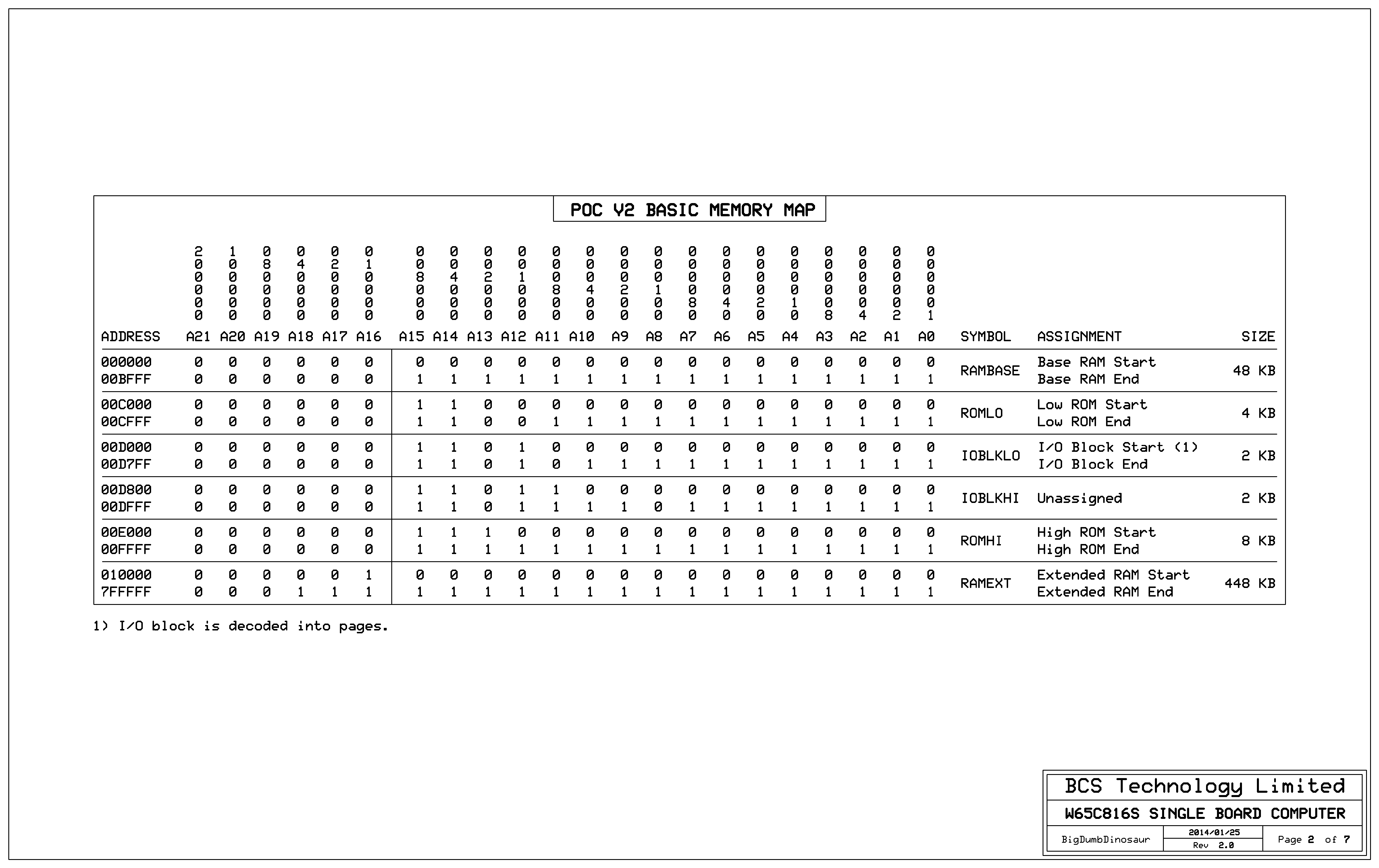

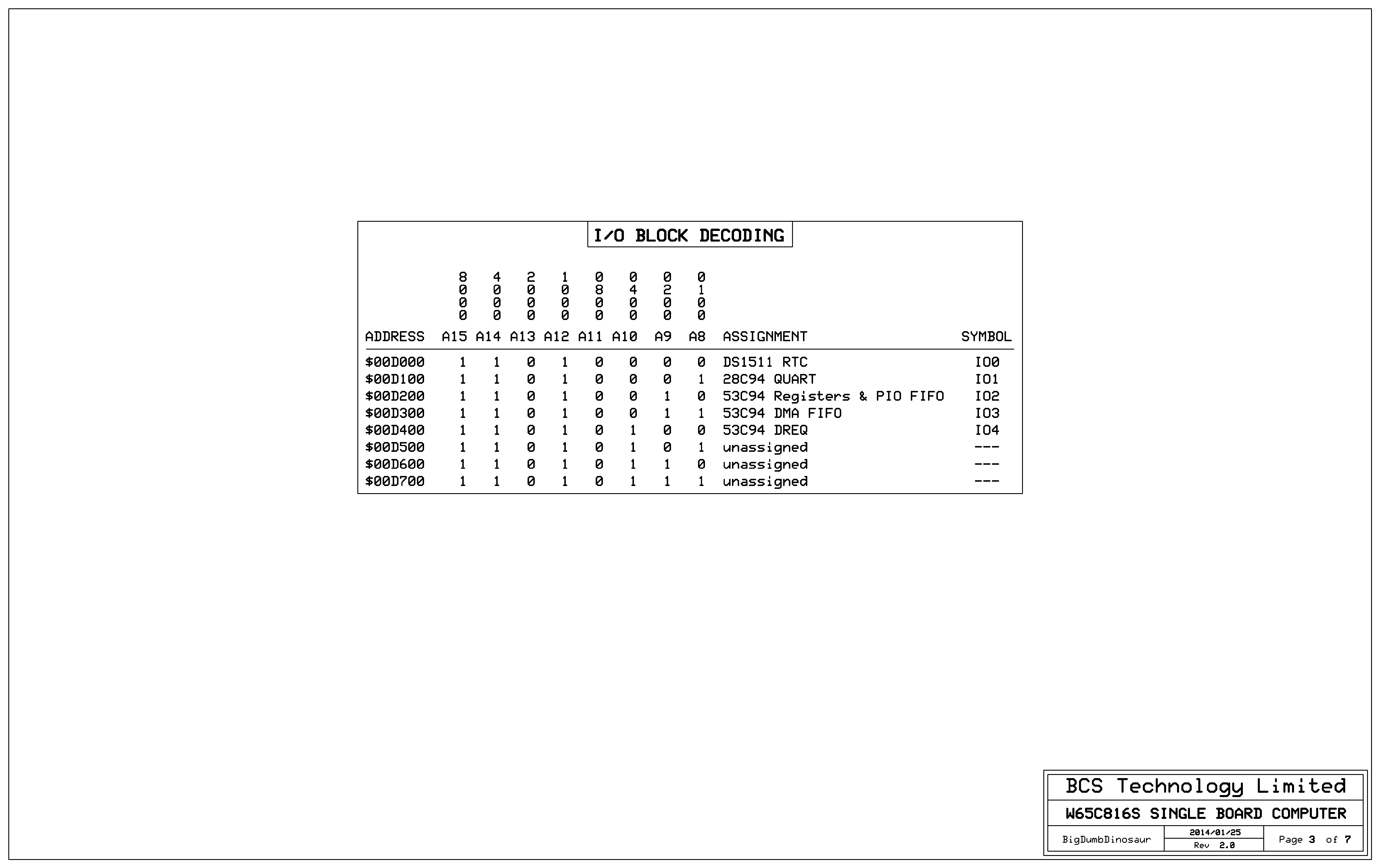

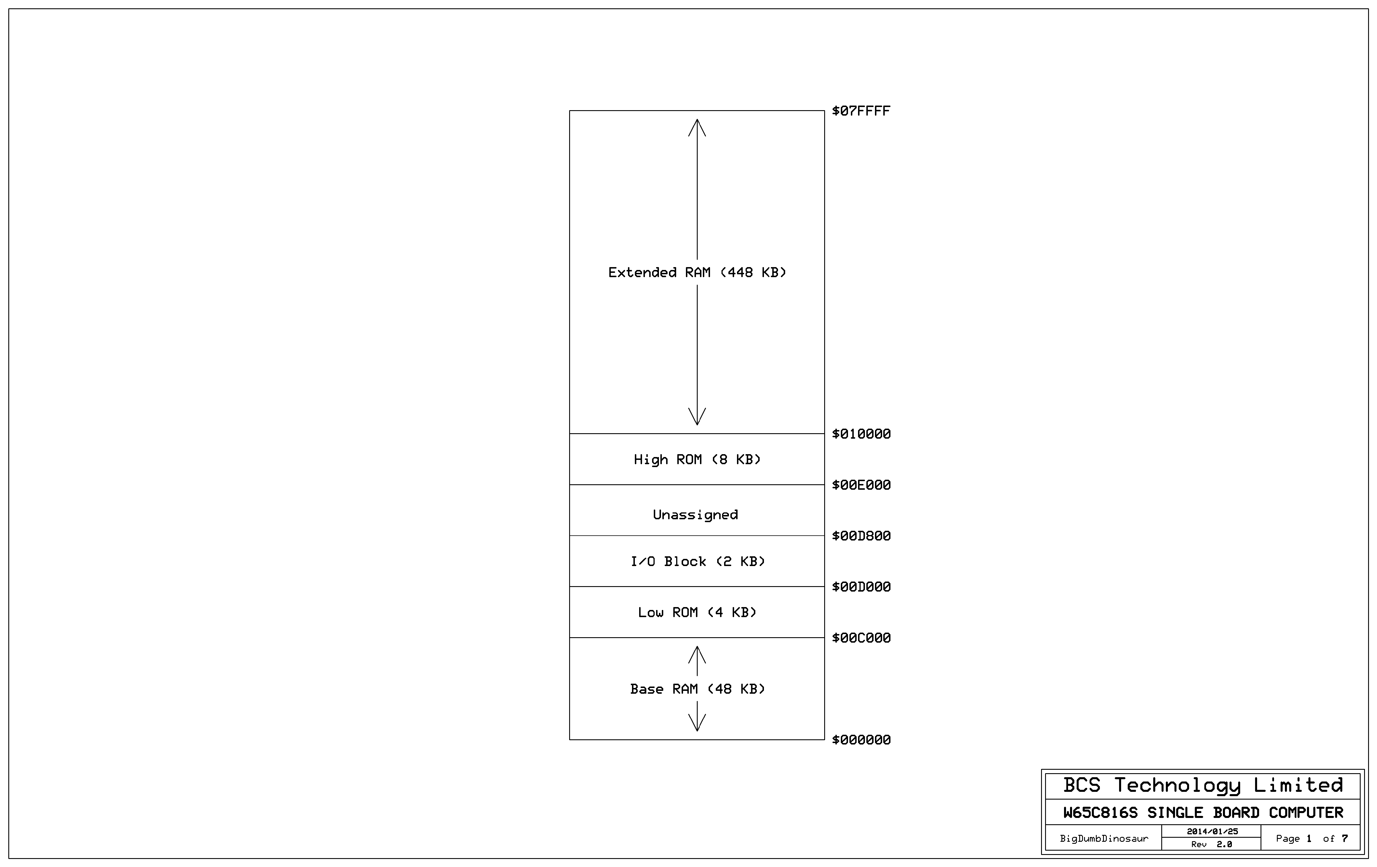

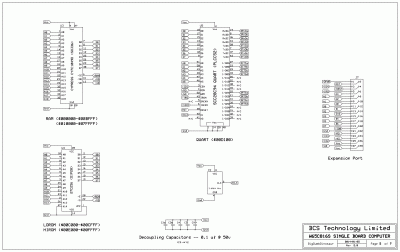

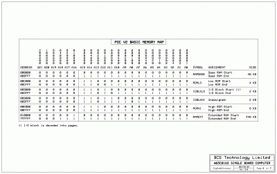

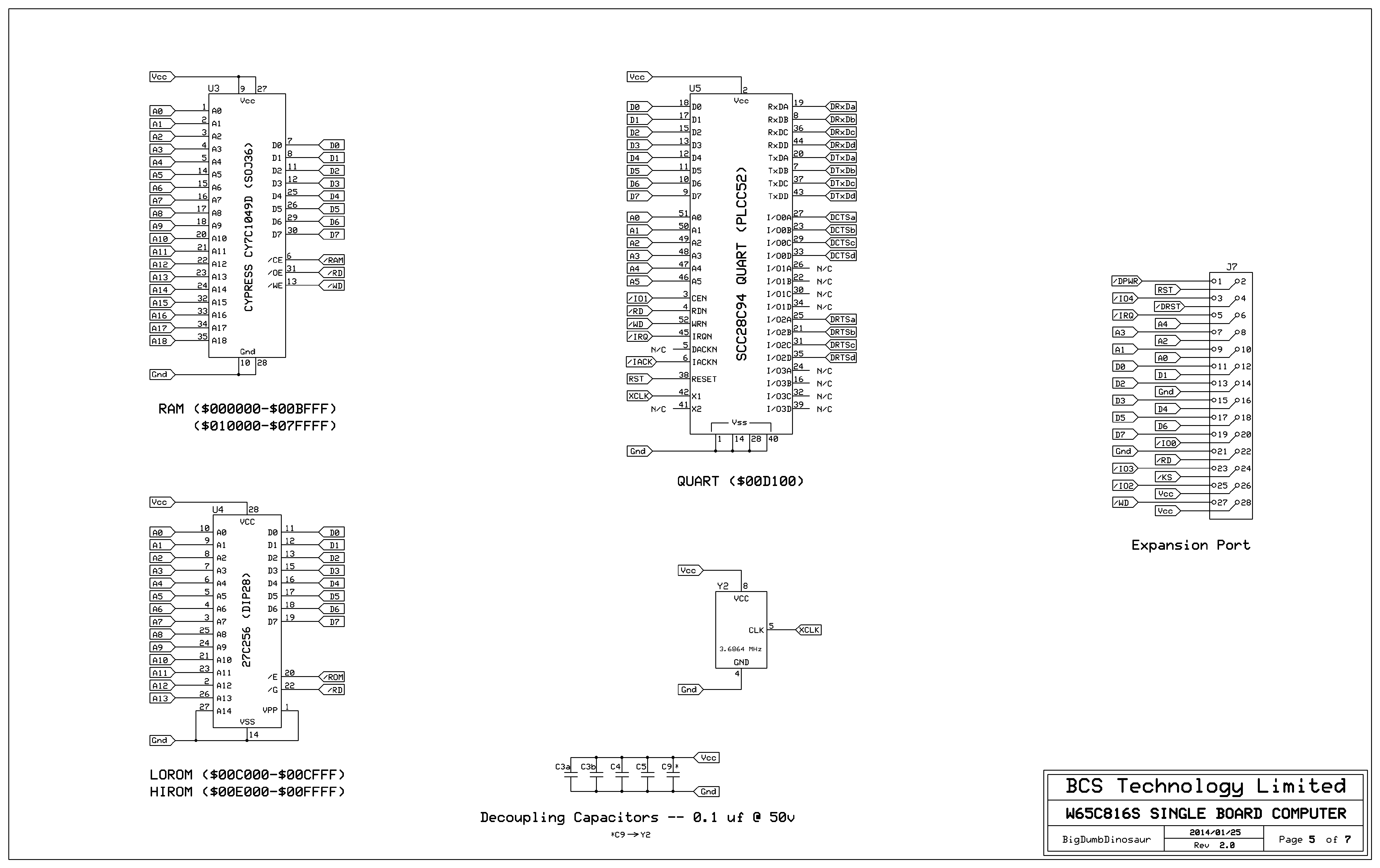

I've tinkered some more with POC V2's design and think I've got it to the point where it can be built. Pages one through five of the schematic are attached to this message, with page six of the schematic and the PCB layout attached to the next message. The next message will have some explanatory comments.
File comment: POC V2 Page 1: Machine Architecture
File comment: POC V2 Page 2: Memory Map
File comment: POC V2 Page 3: I/O Map
File comment: POC V2 Page 4: MPU Interface
File comment: POC V2 Page 5: RAM, ROM & I/O

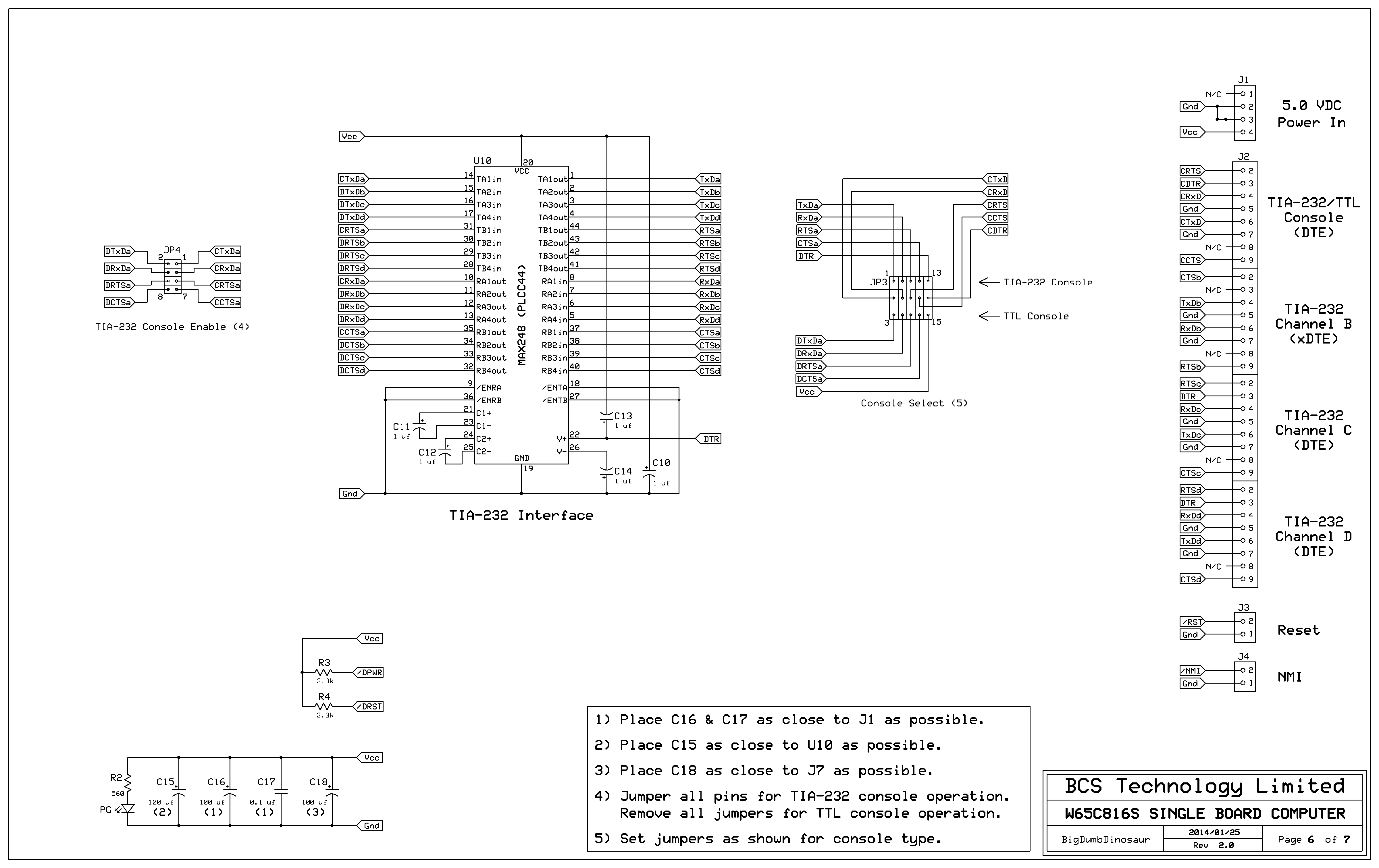

Here's page six of the schematic, and the PCB layout:
File comment: POC V2 Page 6: External Interface
File comment: POC V2 Printed Circuit Board

  • I decided to use a MAX-248 transceiver instead of a pair of MAX-238s. Although a single MAX-248 is more costly than two MAX-238s, its overall footprint is smaller and it requires only one set of charge pump capacitors to power all four serial channels. Also, the MAX-248 is in a PLCC-44 package, which relieves me of the chore of soldering 48 pins on two SOIC packages.
  • I relocated the EPROM (U4) to make it possible to use a ZIF socket. POC V1.1's ROM socket has taken quite a beating with constant ROM replacement as I tinker with the firmware code. As POC V2's firmware will be more complicated, I expect that I will be popping ROMs in and out of that socket quite often. This change required enlargement of the PCB from 19.5 square inches to 21 square inches, which is the maximum size allowed with ExpressPCB's Proto-Pro service.
  • I added circuitry to make it possible to connect either a dumb serial terminal or a SECONS µVGA terminal device to the console port (port A). The µVGA is a TTL device, so there are two jumper blocks in the circuit (JP3 and JP4) to configure the console port to operate at either TIA-232 or TTL signal levels. When configured for TTL, the DTR signal becomes Vcc to power the µVGA device.

Okay, I've run into a problem. I have here the Atmel programming/test rig for their CPLDs, as well as the PLCC-84 adapter so I can play around with the ATF1508AS CPLD. POC V2 is going to use the smaller 1504AS, which is in a PLCC-44 package. So a while back, I ordered the PLCC-44 adapter and waited for it to ship. And waited and waited and waited and...
Anyhow there's a snag at Atmel and it doesn't look like I'm going to get this adapter anytime soon. If I could, I'd reverse-engineer and make my own. However, Atmel is careful about covering their tracks with this stuff, and I'm reluctant to invest the necessary time when so many other things are tugging at my sleeve.
I can't use ISP via JTAG with the 1504AS because the four JTAG pins are being used as I/O connections—every pin on the device is spoken for in this design. Otherwise, I'd just add the necessary JTAG circuitry to POC V2.
As I said, a snag.
I have two possible remedies:
  1. Wait until Atmel produces and ships the adapter or,
  2. Figure out how to shoehorn the much larger 1508AS—who resources I don't need with this design—on to the PCB.
I really don't want to wait too much longer to get this thing built, so I may attempt B. It's going to be tight... :evil:

That seems to be the most sparsely populated area of your board, so it looks like you should be able to do it, at the expense of some bill-boarding and jumper-map real estate.
