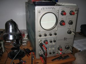

Hi all,
I am thinking of getting me a new O'scope. As some might know I'm still using my trusty old scope I got in used condition around 1986, when it was already old.... http://www.6502.org/users/andre/petindex/imgs/osci.jpg
So it's time for a change.
Now my question is, what would be good features for a new scope? I guess from all the features I'd feel like in hacker's heaven, but it has to fit my purse too, so I have to do some priority-based selection process...
