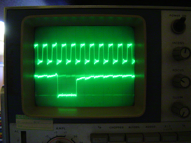

We've made just a little progress with our experiments. It turns out that there are three types of Tube interface with differences which might be crucial.
We are getting some success with donor Tom's Z80 second processor, in the case of using the Tube interface on a Model B. In this case, the Tube databus is actually the CPU databus, which can have quite a lot of other loads on it. Actually, our device works with the original CPU, but not with a 65816 replacement.
Our lack of success at the VCF was with the external Tube interface on a Master, which is almost an isolated bus - the CPU databus is bridged through a custom part called the PBC.
We may have some logic problems, but it looks likely that we have interface or timing problems, so...
I rescued my very old oscilloscope from the garage, and got some traces displayed. It uses 100w, and in the current weather I can only really use it in the morning - the room gets too hot later in the day. I was lucky enough not to have lost the probes - as it is, only one has a ground clip, so the clock waveform is probably affected by a bad ground:
No debug yet, but some capability for debug.
