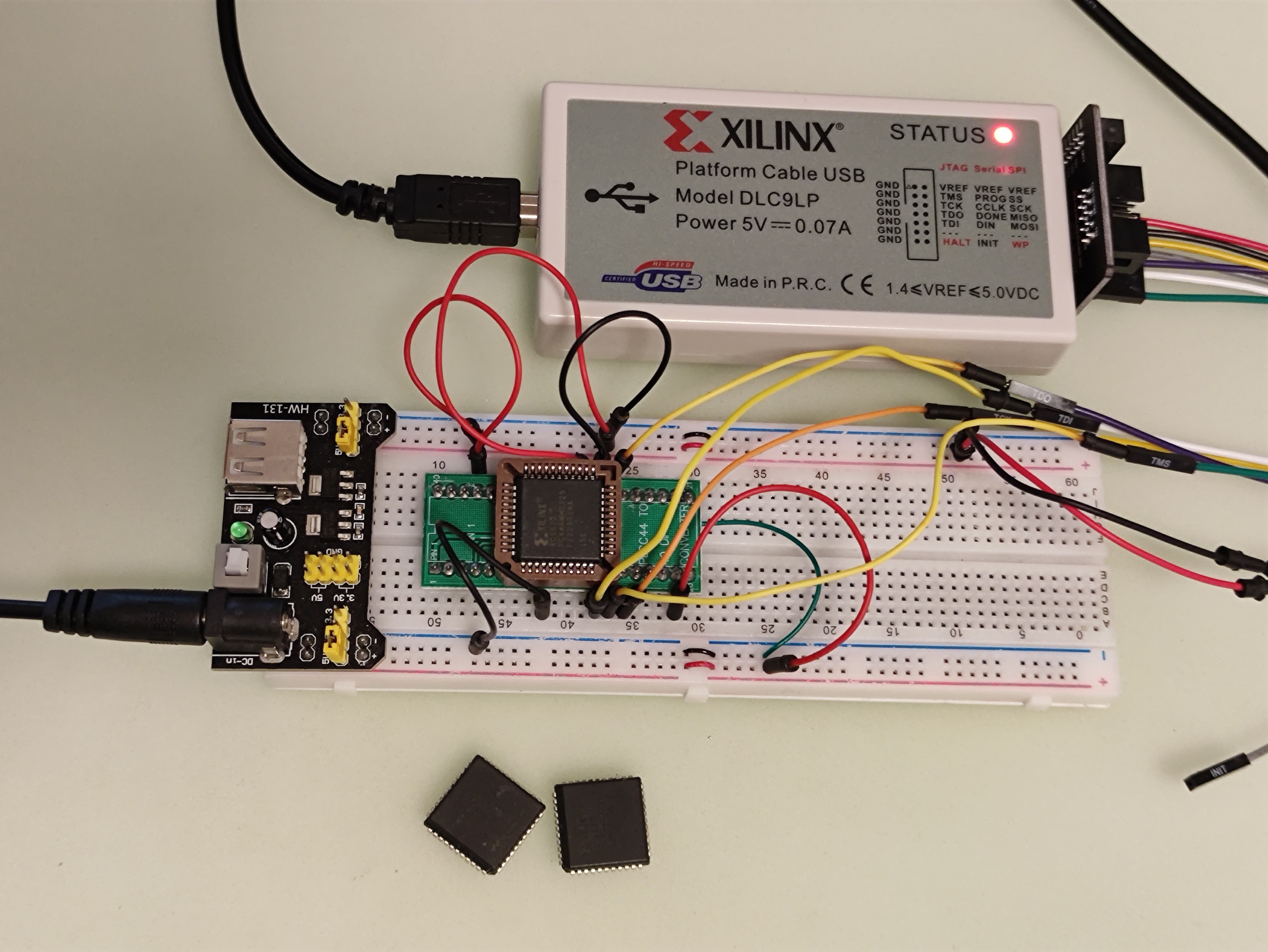

Just in case if anyone is interested. XC9572 (recycled chips) is still readily available from AliExpress. I've purchase 10 for few USD and wired a breadboard to program the 65SPI v1. I had hack the PLCC44 to DIP40 adapter that I have to make sure all the VCC & GND pinout are connected. I installed the latest ICE Webpack for Windows 10 and using Impact to program the JED file to the XC9572. It seem to program/verify fine. I will get it into my 6502 build soon.
