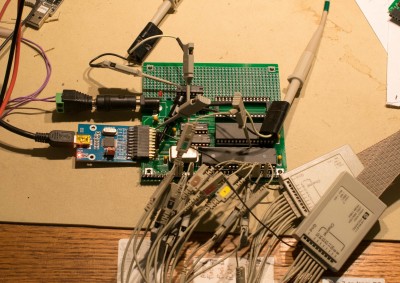

I breadboard up a FT245 and captured bootstrap program execution with logic analyzer. I used 6502's SYNC output as the reference. I see some noisy signals around the reset that can cause extra read of FT245 FIFO and throw it out of synchronization. This may be an artifact of my breadboard, but to work around that I use a sequence of NOP (0xEA) followed by an illegal instruction 0x3 prior to normal program. This way the reset vector is at 0xEAEA which is still within the memory region of FT245. The illegal instruction 0x3 will execute in one clock so if the instruction stream is offset by one byte due to spurious read, it will realign and fetch the correct instruction after the illegal instruction.
I also use the illegal instruction 0x3 as padding. I find the single byte instruction, INX, needs padding, but STA addr,x instruction does not need padding. Here is a simple program that successfully assembles a "NOP, NOP, JUMP to NOP" loop in RAM and jump into RAM to execute it.

6502's clock is 7.37MHz, but the RDY input of 6502 is connected to the invert of FT245's RXF#, so it is single-stepping each data provided by FT245. The data sequence for "STA $8000,X" is "0x9D 0x00 0x80" The two other cycles are in $8000 memory region so do not generate read pulses to FT245.
Instead of understanding many different instructions' cycle-by-cycle characteristic, I focus on few instructions like "STA abs,X", "INX", "LDA #imm", and "JMP abs" to build a simple bootloader program in RAM and then jump into RAM to load bigger and better loader that loads the application software.

(1) /RXF starts out high which takes 6502 RDY low.
(2) Send character to FT245. /RXF goes low to indicate RX char available which takes RDY high.
(3) 6502 reads character from FT245. /RXF goes high after reading the character which takes RDY low again.

I can see how sending 0x9D, 0x00, and 0x80 to the FT245 are accepted by the 6502 but after sending the 0x80 the 6502 RDY is low again. Don't you need to send another character to the FT245 to make /RXF low and take RDY high to allow the 6502 to perform the next clock cycle of the STA $8000,X instruction?
Yes, the circuit requires /RXF low to run so it will run as soon as FT245 received a byte and will stop as soon as the last byte is read out of FT245's FIFO. For the program to run freely, it need to have an extra data in the receive buffer of FT245.
Received my PC boards from JLCPCB this afternoon (5-day turn around!) and built up a Prog65. I've already found a mistake that requires adding a 74LS10 in the prototype area. Right now it can receive bootstrap program from FT245 and execute simple program in RAM but having problem putting data out on FT245. Picture of it on my bench; putting all 16 channels of logic analyzer plus 2 channel of analog scopes to work, it looks like an open-heart surgery...
One little gotcha with these FT24x chips is that, while the RD strobe is active low, the WR strobe is active high. I almost got burnt by that one but caught it in a final check just before I sent the PCB for fabrication.
