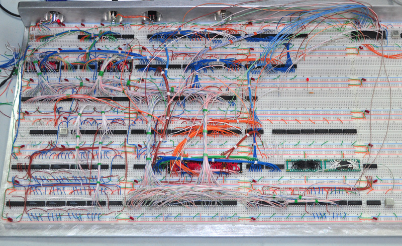

The new chips added to the board are in the lower right corner.
The lowest row is the X/Y counters that generate the 400x300 addressing to the back buffer.
The row above that is another dedicated megabyte of SRAM that will hold the giant 1024x1024 Playfield Screen.
Currently, only the counters are wired, so the Playfied is just a single color (hard wired to blue for testing).
Setting the single color effectively clears the screen to blue at the start of a new frame.

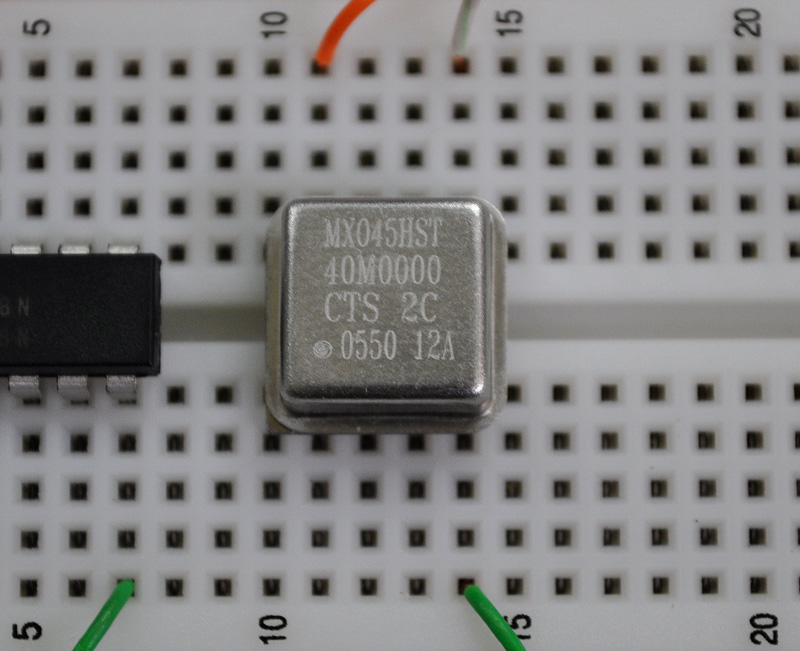

40MHz on a breadboard? Damn right it can be done!
Did I mention that the Playfield Generator is clocked at 40MHz?!
Yes indeed, 40MHz through that mess of new white wiring I have not even cleaned up yet!
It ran at 50MHz as well, but I will be lowering the clock back to 20MHz once the SRAM is connected.

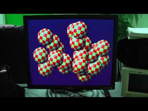

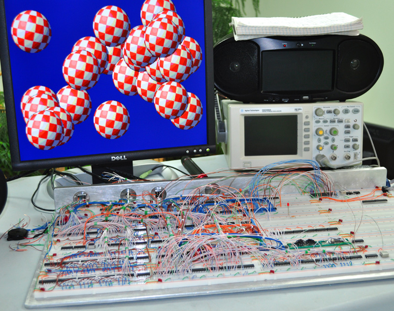

25 huge rotationg sprites bouncing around the screen.
Seeing 25 huge (80x80) sprites fly around the screen at 60 frames per second was very impressive!
I can't wait to see the same amount of power with the addition of a 256 color background image scrolling as well.

Here is a quick video showing the current system working...
https://www.youtube.com/watch?v=VDsEUw1m-bo

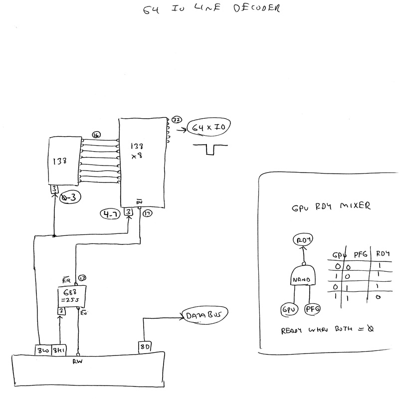

I have decided to add some of the IO logic to the board now that I have run out of IO pins on the test AVR.
Using this simple IO logic, the 6502 will be able to toggle 64 single bit IO lines, just enough to control the subsystems...
IO Mapping from the 6502 to the Vulcan Systems.
Since the only thing connected to the 6502 will be a 10ns 64K SRAM, this decode logic will not interfere.
All communication through these 64 IO bits will be as writes, so 64 bits will be lost (shadowed) in SRAM.
The decoder is simple, it just looks for a hi byte through the 688, and then splits nibbles to sets of 138 decoders.
This way, I can map any 256 IO lines to any segment. The 6502 just thinks it's writing as usual.
I will test this with the AVR, and then drop the 6502 in for a sanity check soon.

; OUTPUT BIT 48 = LOAD VOLUME CH3
; OUTPUT BIT 49 = LOAD ADR.LO CH3
; OUTPUT BIT 50 = LOAD ADR.MD CH3
; OUTPUT BIT 51 = LOAD ADR.HI CH3
; OUTPUT BIT 52 = LOAD FREQ.LO CH3
; OUTPUT BIT 53 = LOAD FREQ.HI CH3
; OUTPUT BIT 54 = LOAD VOLUME CH3
; OUTPUT BIT 55 = PLAY SOUND CH3
; OUTPUT BIT 56 = LOAD VOLUME CH4
; OUTPUT BIT 57 = LOAD ADR.LO CH4
; OUTPUT BIT 58 = LOAD ADR.MD CH4
; OUTPUT BIT 59 = LOAD ADR.HI CH4
; OUTPUT BIT 60 = LOAD FREQ.LO CH4
; OUTPUT BIT 61 = LOAD FREQ.HI CH4
; OUTPUT BIT 62 = LOAD VOLUME CH4
; OUTPUT BIT 63 = PLAY SOUND CH4
Brad
PostPosted: Mon Aug 10, 2015 8:35 pm
Hi again, Brad. Just a reminder to include Phase2 as one of the inputs to your decoder array. Maybe this is implicit in your drawing. To avoid glitches, the decoders must activate only when Phase2 is high.
Also, an interesting thought struck me. Instead of eight 1-of-8 decoders (74HC138) you could use four 1-of-16 decoders (74HC154). This would:
  • save space (the '154 is available in .3" DIP, in stock at Mouser)
  • reduce the number of interconnections
  • avoid heavy capacitive loading on the CPU address lines (ie; the address lines drive the input capacitance of four decoders, not eight), and
  • leave you with four decoder-enable inputs to drive instead of eight
The latter point means the "master" 74hc138 (the one on the left) can be eliminated. This gets slightly gnarly. Instead you would have four CPU address lines (A3-A0 in your diagram), each of which attaches directly to the enable input of one of the '154s. I admit the idea seems odd, but there's no downside. If you write to an address for which A3-A0 are $0E, only one '154 will activate -- and likewise with addresses for which A3-A0 are $0D, $0B and $07.
What's really radical is if you write to an address for which A3-A0 are other than $0E, $0D, $0C or $07. In that case multiple '154s will activate simultaneously. It's possible this quirk could be used to advantage, for smaller and faster output routines. I bet there are lots of cases where the software will need to issue multiple pulses. :)
cheers,
PostPosted: Mon Aug 10, 2015 8:44 pm
Posts: 652
I like the 4-16 idea, thanks!
Might just have a few of those around.
It does save 16ns to have only the single MUX connected.
Cheers!
Brad
PostPosted: Mon Aug 10, 2015 8:53 pm

PostPosted: Mon Aug 10, 2015 9:30 pm
Oneironaut wrote:
Memory recall... I just remembered why I did not use 154's in my last design.
Digikey no longer has them in DIP, and I received and end of life notice on them last year.
It's your decision, of course, but aren't you being rather cautious? The '154 has been around for decades, made by multiple sources. It's not "game over" if one manufacturer does the EOL thing. Also I just had a memory recall of my own. On a breadboard the .3" DIP package isn't really a space saver, so you can just as easily use the .6" DIP. This increases your buying options drastically. As for the .3" HC device, 50% of all the suppliers I checked (two :D ) do presently have it in stock.
Yes and no. Even if you opt for the original idea (two-tier decoding) you still want Phase2 to be part of the qualification -- and Phase2 will be the last signal to go true. So, feed Phase2 to all the second-tier decoders but not to the top tier (the "master").
[Edit: remove reference to 74F154]

Zoinks Scoob, Vulcan-74 just received Performance upgrade due to a previous wiring error!
After some rough calculations, I realized that the Playfield Generator was not drawing the entire screen as fast as originally calculated.
Looking over the logic, I found the Y-comparator (688) was set to wrap at 12,000 pixels too many.
Although this did nothing but draw beyond the screen, it did cause a delay in the Ready Flag coming from the GPU.
The result of moving the 3 wrong wires... a 30% gain in Sprite drawing performance!
Nice to have that happen since I was already happy with the speed!
I am now cleaning and testing all the small glue logic before it gets out of hand.
Before I move on, a few more components must be added to allow reading from the Back Buffer and Playfiled memory.
Currently, the CPU can only draw stuff, not read pixels, and although this would still allow for great games, it has some limitations.
For instance, I plan to write a Cannon Volley type game like "Scored Earth", and to generate a nice background with realistic looking trees and scenery, the game logic in the CPU would need to look at pixels to determine things like rock or tree placement on the rolling hills. Since the Playfield Memory is a HUGE bitmap, it would be unrealistic to store points in the CPU memory space rather than just peeking at the current drawing memory. For the Cannon game, the Playfield will be set to 2048x512 pixels for a massive horizontally scrolling background.
Oh yeah, forgot to mention that I made the 1024K Playfield Generator configurable on the fly.
The Playfield, can be scrolled in any direction, any number of pixels, and can be set to the following sizes...
Mode 0: 1024x1024 - Square or static Playfield
Mode 1: 2048x512 - Good for horizontal scrolling games
Mode 2 : 512x2048 - Good for vertical scrolling games
If I get time this weekend, I will post more videos showing the huge amount of performance increase since the last one.
Greets out to Hackaday... thanks for posting this project.
