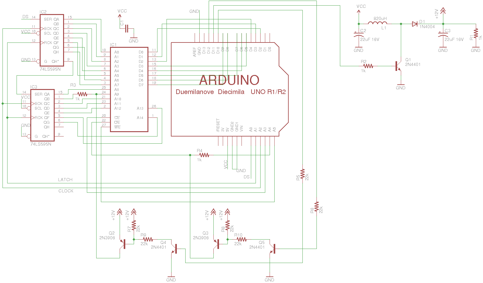

Heck yeah, I'd love to get an updated schematic. It'd be great to be able to program a greater variety of chips. I was looking at the datasheet for the 27C series chips and I didn't see a reasonable way to get the odd voltages it needs during programming.

Ok! I have modified UnaClocker's schematic with the transistors for VPP and A9. I also added a simple boost supply; this is not what I used as you can see in my photo, but I think it will work. Next time I order from Digikey I'll get these components to prototype it. The windowed EPROMs seem to also ask for VCC of 6.5V, but I read this is not necessary. In any case my flash EEPROMs only require 5V.
I ordered an Arduino Leonardo, previously I was using a UNO I borrowed from a friend. I think the Leonardo will be a bit faster because it has a virtual com port, and it's cheaper. I realize the sketch will need to be a bit different, I'd guess it could support both with the right changes.
In terms of speed it seems the slowest part is the bit banging of the shift registers, which is no surprise. I looked at the assembly generated from the C code and maybe it could be better, I will look at making it faster.

Re: 28Cxxx EEPROM Programmer
Thanks Mario! I've made a bunch of changes, I'll push them to my github tomorrow so you can check it out and pull it. I've done some optimization, so now it will read 64k in 3 seconds and write in 6.5 seconds. This is much faster than my old TOP2049.
I wonder if the Leonardo might be slower because of the virtual com port? Also the port pins are all over the place. I guess I'll see when it arrives.
I'd like to increase write speed for 28Cxxx but I don't have any. Maybe I will get one to play with.

Nice, that sounds nice and fast. Technically, the Leonardo's virtual serial port is FAR faster. It's a USB device pretending to be a serial device. Somewhere on PJRC.com, he's done some speed testing with the Teensy 2.0 (the Teensy 2.0 is an Arduino compatible that was using that same chip as the Leonardo about 2 years before the Leonardo came out), or maybe he did it on the 3.0, but either way, he found that the majority of the limit is the way Windows handles things. So if you're not using Windows, you should be able to get it up around 1mbit.
I'm certainly interested to hear how it works out.
I'd send you a 28C chip to play with, but they're $9 a piece and I'm using both of mine at the moment. Actually, you can get the 200ns ones pretty cheap on eBay, but those are too slow for my ECM.
Yeah I read it was faster, but I also read it takes more CPU. So I guess it depends if the higher available throughput can overcome the slower bit banging because of less available CPU. The weird port pins will probably have a speed hit too.
I pushed my changes to my repo here: https://github.com/presslab-us/MEEPROMMER
I also added code for 28C page write, maybe it will work who knows! Anyway, someone give it a try...

Got the Leonardo working, only mixed up one bit shift. ;D I pushed the fix to my repo. It's about 10% slower than the UNO. It's not the comms though, it's the bit swapping needed for the weird port setup. Anyway, it's plenty fast.
I ordered the parts to test the boost converter circuit. The PWM signal is working on the UNO and Leonardo, should give about 0.15V resolution on the boost supply.
