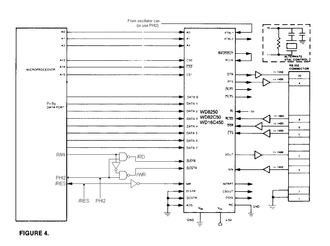

For a first effort, I’d suggest you find a 6551 [...] The bus interface will be much easier
A lot depends on circumstances. If being able to use the chip that's already in your possession is a fairly high priority for you, bogrol, then perhaps you won't mind if its interface for 65xx isn't the simplest. The amount of extra logic required is actually fairly small.
This edited version of Figure 4 from the datasheet could use a second set of eyes but it ought to steer you in the right direction. (I'm drawing attention to generation of the MR, /DISTR and /DOSTR signals, which are the ones that present the obvious challenge.)
Can you tell us more about your 6502 SBC, bogrol? Perhaps it already has the /RD and /WR signals shown in my diagram, as that's what is sometimes used to drive /OE and /WR on the RAM chip. And what's the clock rate?
ps- welcome!
Yes, it would be best to use what I have now even if it means I have to add some more glue logic, I'm more than willing to learn. :)
Very well. I'm using Garth's decoding design and a NOT-gate (from NANDs) crystal oscillator (giving 1.8432MHz) The rest of it is the same as the simplified version of Garth's schematics by Ben Eater, the VIA is mapped by A13.
It is evident that MR is wired throught a NOT. On the datasheet scheme you linked, are the triangles to the right also NOTs? Or diodes and then are they necessary? I have also found the 8250-compatible design of the Zeta SBC being worth a look at as it uses a Z80 MPU.

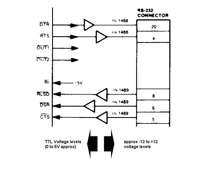

No, those are sections of a 1488 IC and sections of a 1489 IC. Their job is to convert the voltage levels of incoming and outgoing signals, because it's sometimes the case that you'll want +/- 12V levels... or not, depending on what sort of device attaches to the other end of your serial connection. BTW, modern equivalent ICs are preferable in some ways to the venerable 1488 and 1489.

Here your go, I hope it's adequate. I have two clocks, one 1MHz driving the CPU and other things and one 1.8432MHz for the UART. As the CPU wants to read from the UART, R/W becomes HIGH and thus UART pin 22 (DISTR) is active. When writing, R/W is LOW and such DOSTR becomes active.
I agree, but this doesn't satisfy the timing requirements shown in Figure 11 and Figure 12 of the datasheet (page 17). The DISTR and DOSTR signals aren't supposed to go active until after the address lines have settled -- see the tDIC and tDOC parameters shown in the figures. That's why in my suggested circuit I have used PHI2 to qualify DISTR and DOSTR (actually /DISTR and /DOSTR).
You can be confident the address lines from the CPU will be stable by the time PHI2 goes high. But at other times the address lines may be in transition, and it can cause trouble if DISTR and DOSTR are active.

Ah, very insighful, thanks! Do you think replicating this would suffice then or is it more complicated? I'll write a little program then to test it. Slim chances but we'll see.
Yeah, it should. And really there's no great insight involved. This sort of approach is extremely common, because with virtually all microprocessors it's normal for the address bus to be unreliable for a brief period as one cycle ends and the next begins. So, you need the peripheral device to "stop paying attention" during this time.
