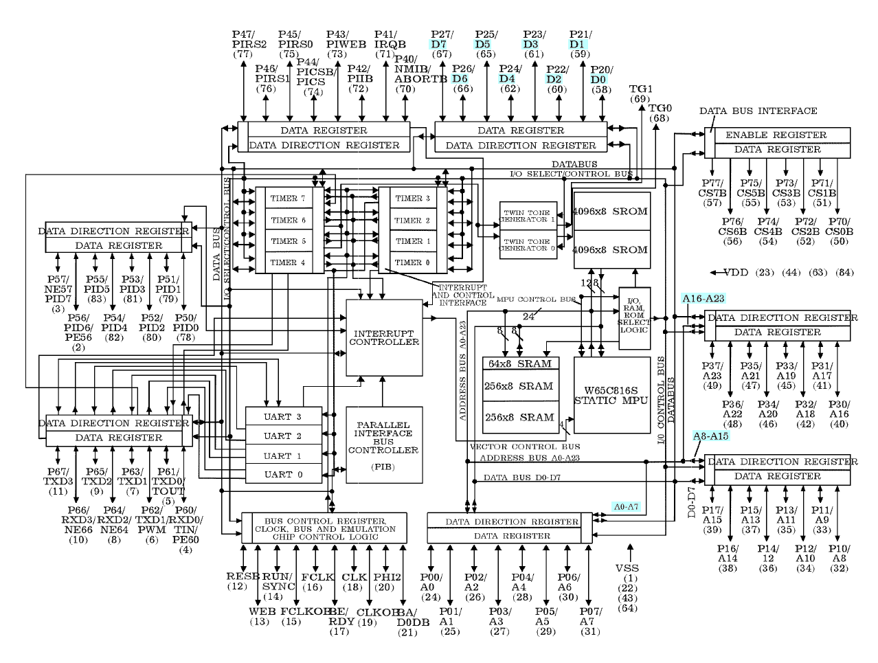

PostPosted: Thu Aug 11, 2016 4:58 pm
If it is desired to use an external ROM [with the 65C265 microcontroller] then some of the connectivity goes out the window.
That's true. You sacrifice about 45% of your IO pins when an external bus is used. OTOH, that still leaves 40 IO pins free, which is considerable.
In the '265 block diagram below I've highlighted the IO ports that are NOT available when an external bus is used.
Another potential limitation is the 265's 8 MHz speed rating. But if it's expected that code will execute directly from EPROM then the 8 MHz limit may not matter much.
Quite true.
POC V2 (when built) will be able to shadow ROM in RAM and thus avoid the performance limitations of running the firmware from ROM. I'm also cogitating on how to rig up the logic so the block of RAM that shadows the ROM can be write-protected. On paper, this mess should be able to run at 20 MHz. with only I/O hardware accesses being wait-stated.
