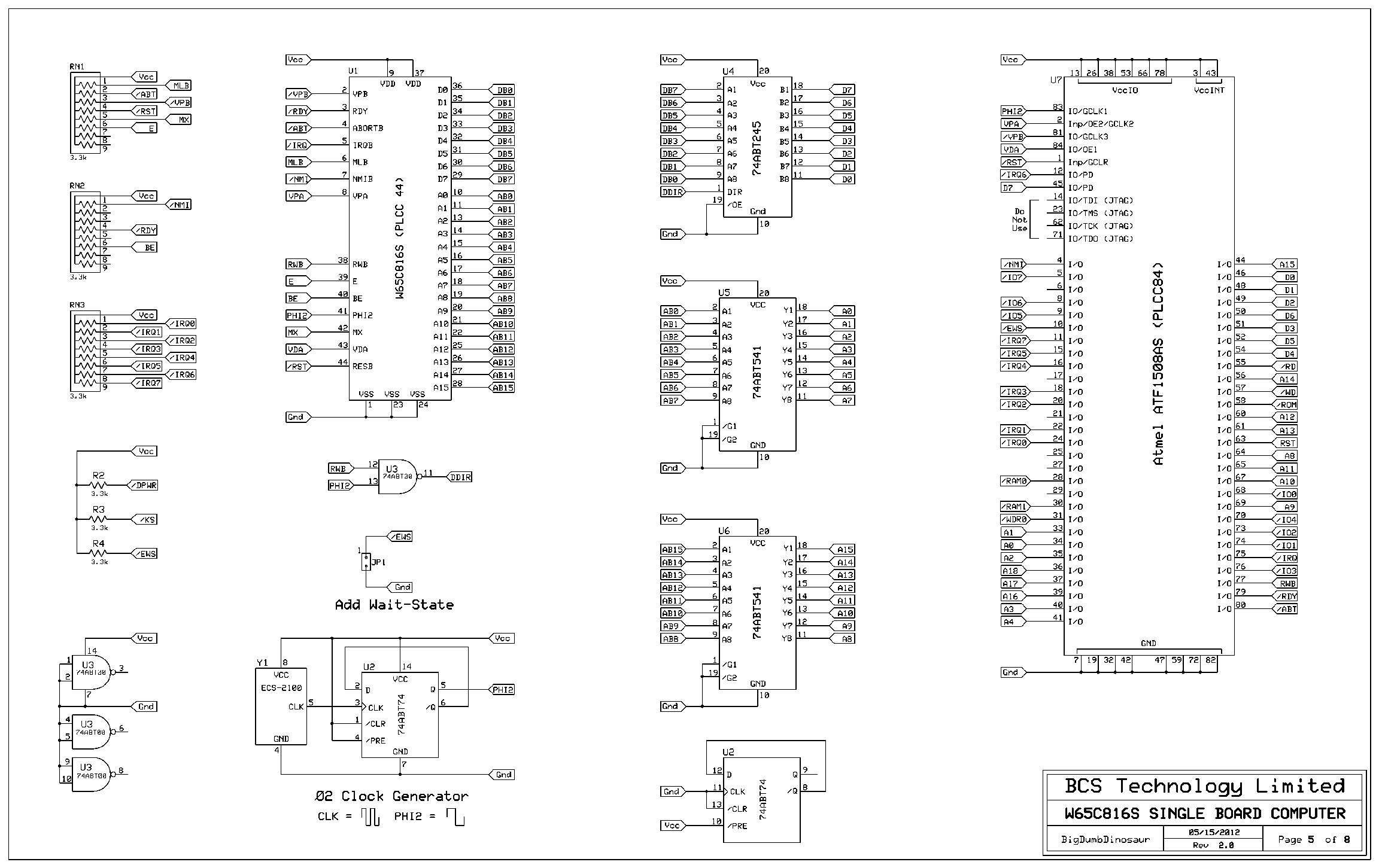

I'm not sure you understand the nature of the problem. Sandboxing per se would not all that difficult to achieve, if it weren't for a design "feature" of the 65C816. First off, let's review how the '816 generates valid addresses and how that information would be used to set up memory protection.
A0-A15 are generated from the MPU program counter, the same as the 65(c)02, and A16-A23 are generated on D0-D7 when Ø2 is low and the address bus is declared to be valid, the latter being determined by the VDA and VPA signals. The origin of the A16-A23 component varies as an instruction is executed. The VDA/VPA and address generation relationships are as follows:
                                A16-A23
Ref   VDA   VPA   Address Bus   Source    MPU Activity
 1     0     0      Invalid       --      Internal operation
 2     0     1       Valid        PB      Operand fetch
 3     1     0       Valid        DB      Data fetch or store
 4     1     1       Valid        PB      Opcode fetch
In the above, "address bus" includes the A16-A23 component that is multiplexed on D0-D7 during valid memory cycles when Ø2 low. If a memory cycle is not valid the state of D0-D7 is undefined. The entries in the A16-A23 Source Column refer to the program bank (PB) and data bank (DB) registers. The conditions in reference #1 occur during the intermediate execution stages of some instructions, especially those that involve indexed addressing. Chip selects must never be valid during the condition defined in reference #1, as the effective address is undefined. Incidentally, the conditions in reference #4 correspond to when the 65C02 asserts the SYNC signal.

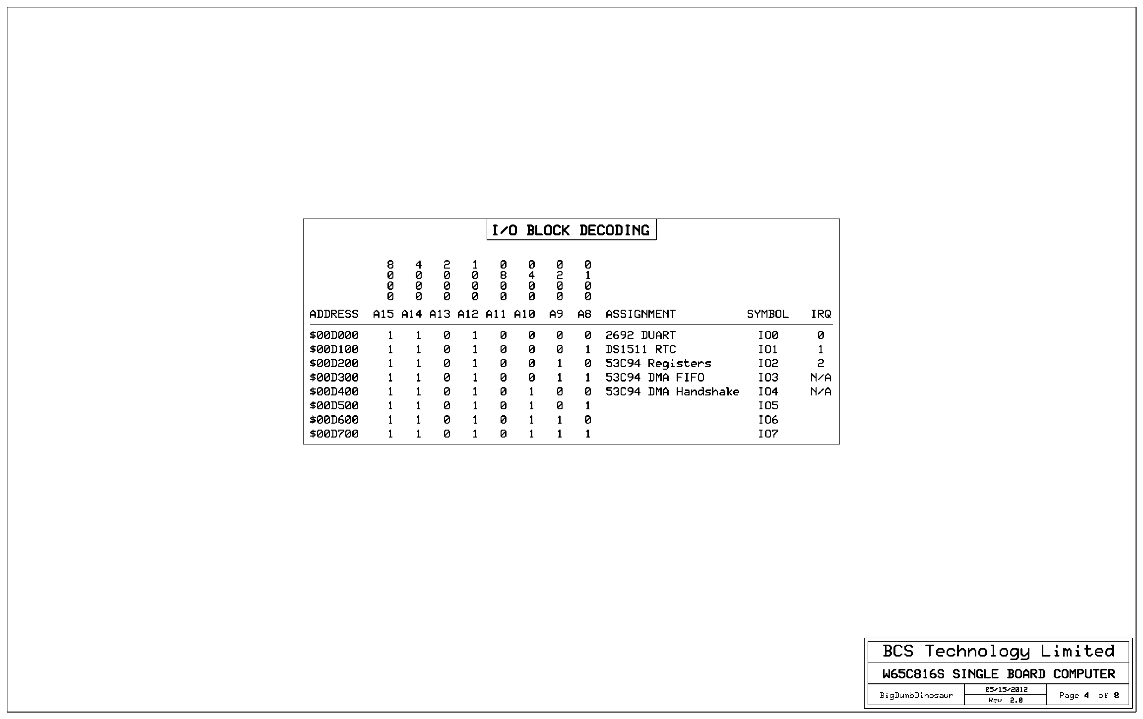

At any given time, the CPLD logic will "know" from watching VDA and VPA when the effective address is valid and, indirectly, what is on the data bus during any given clock cycle. Hence such information could be used to police memory accesses. However, this is a stateless situation—there is no way to know what transpired in the past, unless the CPLD institutes stateful inspection of each instruction cycle and records the condition of VDA, VPA, A0-A23 and D0-D7 for posterity. That's not practical, nor is it necessary in order to sandbox processes. All that has to be known is what is on D0-D7 when the expression !Ø2 & (VDA | VPA) is true, where & is logical AND, | is logical OR and ! is logical NOT. At that time, if the bit pattern on D0-D7 is not the same as the bank number of the currently executing process, and if the current process is not the kernel, a memory access violation has occurred. So the basic means of memory protection is implicitly defined in the CPLD logic.
The real, and so far intractable, problem is two-fold in nature and is due to a design choice made when the '816 was conceived:
  • All zero page and stack accesses are forced to bank $00 without regard to the setting of DB, which makes that bank a "community" sandbox. Therefore, the bank comparison rule has to be ignored for ZP and stack activity if the system is to be able to function—it's kind of tough to do much without ZP and a stack.
  • When any interrupt occurs the '816 automatically forces PB to $00 immediately after pushing the 24 bit program counter (PB followed by PC) and the status register (SR). Pushes occur to the currently-executing process' stack, since that is where SP will be pointing when the interrupt hits. Naturally, the relevant interrupt vector must be located in bank $00, since the MPU effectively does a JMP (<addr>) to get to the interrupt service routine (ISR), where <addr> is always $00xxxx. This characteristic implies that the ISR, or at least part of it, must be in bank $00 (it can, however, jump to another bank). Once again, the sandbox rule cannot be applied to bank $00 if the interrupt system is to be functional.
Given the requirement that bank $00 be accessible to all processes under all conditions, the approach to be taken at first blush would be to prohibit any user-space process from "manually" changing the direct page (DP) register and/or stack pointer (SP). Such a rule would prevent a user-space process from, say, making the I/O block its new stack (Ouch!) or selecting another process' stack as its new ZP. However, blocking DP and SP changes will hobble programming to some extent (being able to change DP on the fly is real useful) and obviously won't prevent a rogue process from overwriting much of bank $00 due to failure to maintain a clean stack.
Given all this, I need more than bank comparisons to prevent ZP and stack space corruption. Bank comparisons will protect all non-zero banks from improper accesses and thus provide sandboxing. Keeping bank $00 in shape is a different matter. My tiny dinosaur brain is having trouble visualizing what needs to be done.

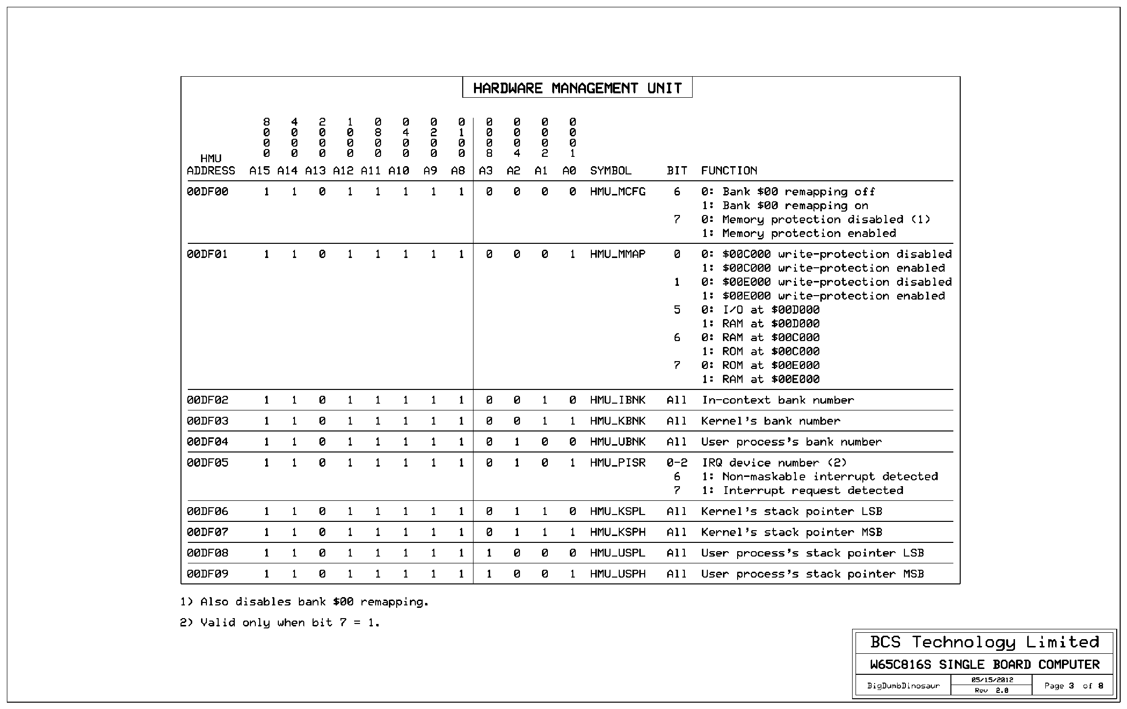

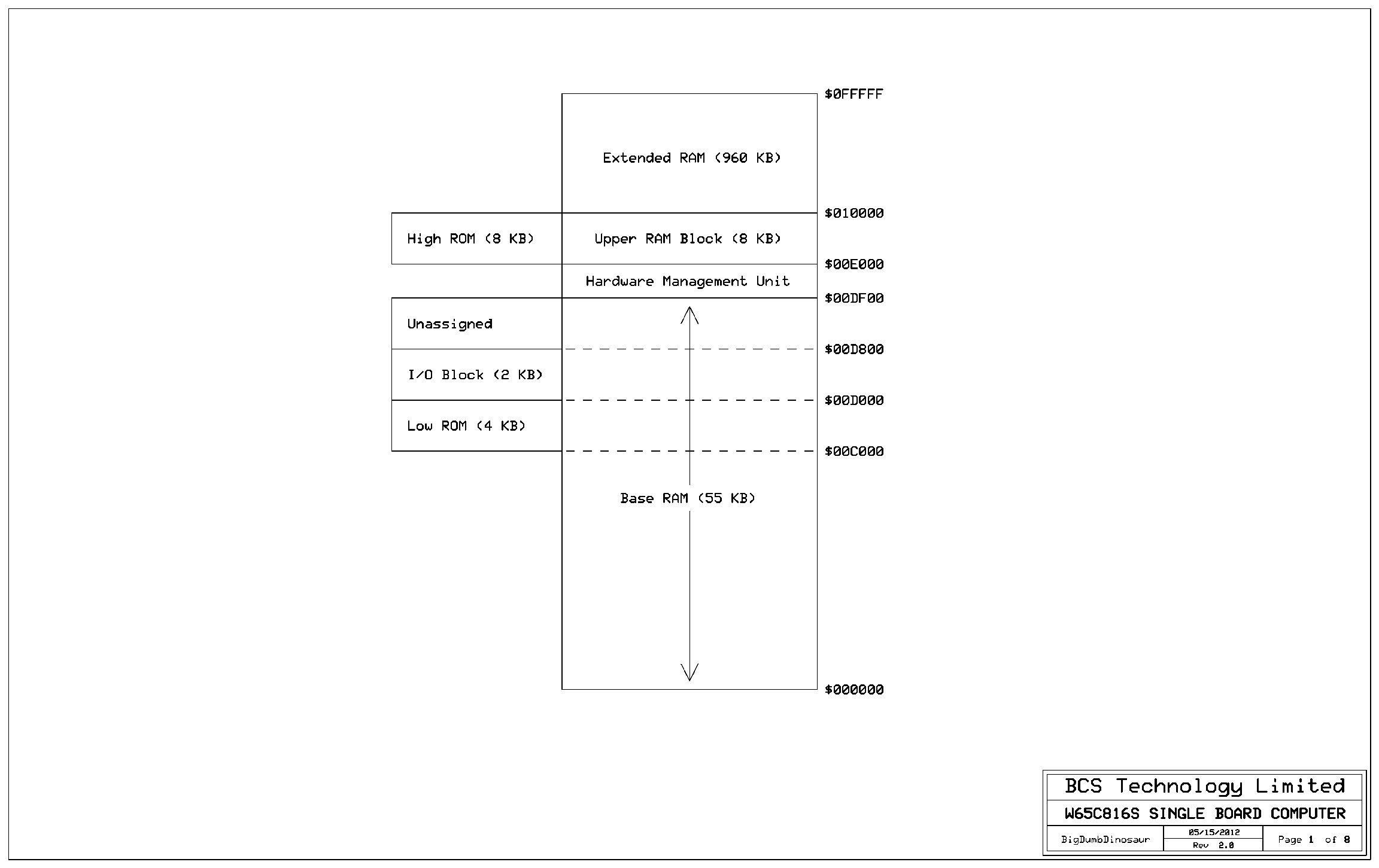

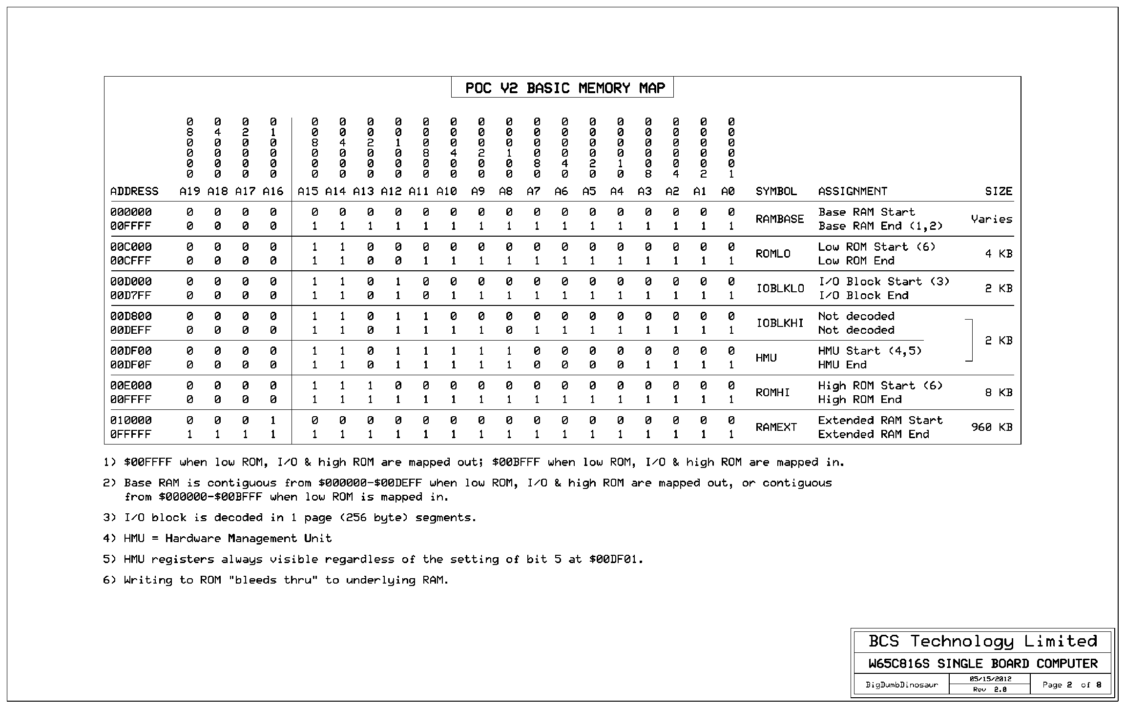

 Post subject: POC V2 Bank $00 Dilemma
PostPosted: Wed Jun 27, 2012 6:07 am
Posts: 8504
I have been contemplating the "bank $00 dilemma" for quite a while, even before POC V2 was more than some passing thoughts. To briefly recapitulate, the "bank $00 dilemma" exists due to a characteristic of the 65C816 that causes it to "hard wire" all zero page (ZP) and stack accesses, as well as indirect absolute addressing, to the first 64 KB of RAM, resulting in a $00xxxx effective address. Also, response to an interrupt of any kind causes the program bank to be forced to $00, thus requiring that the MPU's hardware vectors and interrupt service routines be located in bank $00. This convergence on bank $00 is inconvenient in any system that is expected to support preemptive multitasking, as it complicates the implementation of hardware memory protection.
Ideally, the natural memory segmentation produce by the '816's bank-oriented architecture should allow the system designer to confine each running process to an arbitrarily assigned bank, and prevent inter-bank access without the permission and cooperation of a supervisory program (e.g., an operating system kernel). This is the architecture I envision with POC V2. As ZP and stack access is necessary in most programs, a dilemma is created about what to do with the fact that ZP and stack accesses are directed to bank $00, thus violating the rule that no process be allowed to access any bank other than its own. If an exception to this rule is created so ZP and stack accesses will work, what would prevent any process from overwriting parts of bank $00 that it shouldn't touch?
In current RISC and x86 hardware, the MPU has a feature called "privilege rings," which can be utilized to prevent user-mode programs from executing instructions that should only be executed by the kernel. In such hardware, the kernel operates with maximum privileges and user applications operate with much lower privileges. Hence an attempt by a user-space process to execute potentially destructive instructions can be blocked. Unfortunately, the '816 doesn't have this feature, which if present, would solve the bank $00 dilemma. Therefore, the system glue logic has to somehow take over and create a "privilege rings" analog. I've started to develop some ideas on how to go about doing this. So the rest of this post will be a sort of sounding board for a possible solution to the bank $00 dilemma. I won't go into any hardware or software specifics, since the solution can't be designed until the problem has been defined.
Architectures that support memory protection typically use virtual addressing rather than physical, both for segregation of running processes and for economizing on RAM consumption. In virtual addressing architectures, the smallest amount of contiguous RAM that can be protected is often referred to as a page (not to be confused with the 65xx notion of a page) and, in many cases, is 4 KB in size. Multiple pages can be ganged to produce a larger protected execution space when needed.
In POC V2, I'm not particularly concerned about RAM consumption at this time. Therefore, I've decided to use fixed sized protected space equal in size to a bank, or 64 KB. As the '816's architecture is bank-oriented, I'll use that term instead of page when talking about protected space. V2 will have 1024 KB of RAM, which is equal to 16 banks, enough to prove that my virtual addressing concept will work—or not. :? The CPLD will be tasked with generating the A16-A23 bank bits, which means it will always determine into which bank an access will occur. If my logic is correctly implemented, accesses that would normally be forced into bank $00 by the MPU could instead be directed to a different bank without the running process being aware of the change. The result would be a solution to the bank $00 dilemma.
In order to remap bank $00 accesses, the CPLD logic has to know where to remap the accesses and when such a translation is appropriate. The former would be determine by consulting some virtual registers in the CPLD that the operating system kernel would maintain. The latter would be determined by whether the hardware is running in "real" or "protected" mode. Also, when in protected mode, a distinction will be made between user or kernel mode. Additional rules will apply when an interrupt is serviced:
  • User mode. Full protection is enabled. The effective address is always in the bank set in the CPLD's user bank virtual register. Bank $00 accesses are always remapped to the bank in which the user mode process is executing. Attempted accesses to another bank will cause an memory fault and trigger a hardware abort.
  • Kernel mode. Reduced memory protection is enabled. The effective address is normally in the bank set in the CPLD's kernel bank virtual register but can be changed to access another process' bank. Bank $00 accesses are normally remapped to the kernel bank but can be remapped to any other bank, such as for accessing another process' stack.
  • Interrupt mode. This mode occurs when the MPU starts to service an interrupt. The following generalized steps would occur:
    1. The current mode and bank $00 remapping is maintained until the MPU has pushed the program bank (PB), program counter (PC) and status register (SR). As bank $00 remapping has not been changed during this step, PB, PC and SR will be pushed onto the interrupted process' stack.
    2. As soon as the MPU has pushed SR (cycle 6 of the interrupt sequence), it will assert (negate) its VPB (vector pull) output, which will cause the CPLD to enable interrupt mode. Protection will be changed to kernel mode and bank $00 remapping will be disabled, causing the MPU hardware vectors to appear in the range $00FE00-$00FFFF.
    3. During cycles 7 and 8 of the interrupt sequence, the MPU will load PC from the relevant interrupt service routine (ISR) jump vector and execute the ISR.
    4. With bank $00 remapping disabled, any stack activity performed by the ISR will be directed to physical bank $00. The ISR is permitted to access any bank and may also enable bank $00 remapping as long as when doing so subsequent ISR code is not in the real bank $00. Special handling of the stack pointer would be required if an ISR itself was interrupted. Proper coding, however, can prevent this from occurring.
    As kernel APIs are called via software interrupts, the system always goes into interrupt mode before the API code is executed. Once the kernel has saved context it can (probably should) clear interrupt mode and re-enable IRQs before continuing.
  • Real mode. All protection is disabled. The effective address is always that generated by the MPU—the CPLD will use the DB (data bank) or PB register contents to assert the appropriate address bus and chip select lines. Real mode is the default following reset.
Also essential to effective protection is preventing execution of certain MPU instructions that could take down the system. Some instructions will automatically cause a memory fault because the associated operand uses a 24 bit address. However, there are instructions that should never be executed and some that should not be executable by user-mode processes. In the first group are COP, STP, WDM and XCE. In the second group are JML, JSL, RTI, RTL and SEI. SEP is potentially dangerous in one case: SEP #%00000100, which is effectively an SEI instruction. The sequence:
         LDA #%00000100
         PHA
         PLP
which would likewise disable IRQs, causing a total system halt (which a watchdog timer could fix by triggering an NMI whose handler would re-enable IRQs).
It is possible for CPLD code to look at D0-D7 while the MPU is fetching an opcode and compare it to the above list for further action. Checking SEP would mean also looking at the operand. Unfortunately, I can't think of any way to prevent a program from pulling a stack value into SR that would shut down IRQs.
Anyhow, now that I've got some of this down on paper the next step is to create some logic tables that describe what I'm trying to achieve.

The CPLD maintains context state information in several virtual registers:
  • HMU_IBNK. The bank in context when a hardware interrupt occurs. This register is changed by the CPLD logic when it detects an IRQ or NMI, and is consulted by the hardware interrupt handlers so they know to which bank to return when interrupt processing is completed.
  • HMU_KBNK. The bank in which the kernel is running, which is established at boot time (it would not change thereafter).
  • HMU_UBNK. The bank in which the current user-mode process is running. This register is changed by the kernel when any software context switch is made. When a kernel API has completed processing it returns to the bank in this register.
  • HMU_BNK0. If bit 7 is set in this register, bank $00 remapping rules are in effect, causing effective addresses that are "hard wired" to bank $00 to be redirected to the bank currently in context. The effective address seen by the MPU will be in the range $BB0000-$BBFFFF, where BB is the bank currently in context. If bit 7 is clear, effective addresses that are "hard wired" to bank $00 are directed to physical bank $00. The effective address seen by the MPU will be in the range $000000-$00FFFF.
HMU refers to the "hardware management unit," which is a virtual device inside the CPLD. All HMU virtual registers are accessible only to the kernel when operating in protected mode.
The kernel also has the ability to perform cross-bank loads and stores by loading the MPU's DB (data bank) register with any bank and then executing an absolute addressing instruction, such as LDA STACK_U,X. As long A8-A15 of the generated effective address is non-zero the load or store will go to the bank defined by DB. A user-mode process could likewise change DB and do the same thing, but would cause a memory protection fault on the next absolute memory referencing instruction.

I've slept on the design for a while and made a few modifications, mostly to simplify it. Also, I've fleshed out the HMU (hardware management unit) definitions. The PCB layout is also a little tighter. See updated schematics and PCB layout. I've spread the illustrations over two posts to get around the five attachment limit per post. Schematic pages one through five are below. Pages six and seven, as well as the PCB layout are in the next post.
File comment: POC V2 Schematic Page 1 — Architecture

File comment: POC V2 Schematic Page 2 — Memory Map
File comment: POC V2 Schematic Page 4 — I/O Map
File comment: POC V2 Schematic Page 5 — MPU Interface
