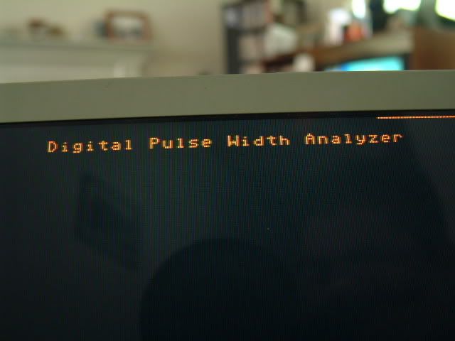

Thanks for the help with macros. I'll use them to try and troubleshoot this thing further. I have brought the 02 clock to under 1MHz with no change in operation.

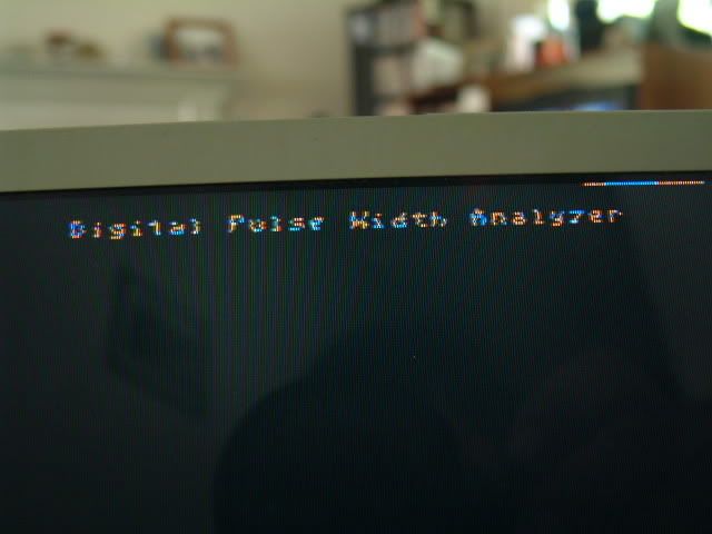

Also, I tried replacing the original delay with NOP's and you can see the result below, why in the heck would it do this? (There is no JSR in the PLTPXL routine because I want it to plot as fast as possible, and this routine is at the heart of my problem. When I figure out this delay problem there will be no JSR's.)
Here's some pics so you can see what's going on. When I call PLTPXL it looks like this:

Working:(If I delete the BNE instructions, it still works. If I delete the BNE & DEX instructions, it doesn't work.)
Not working:

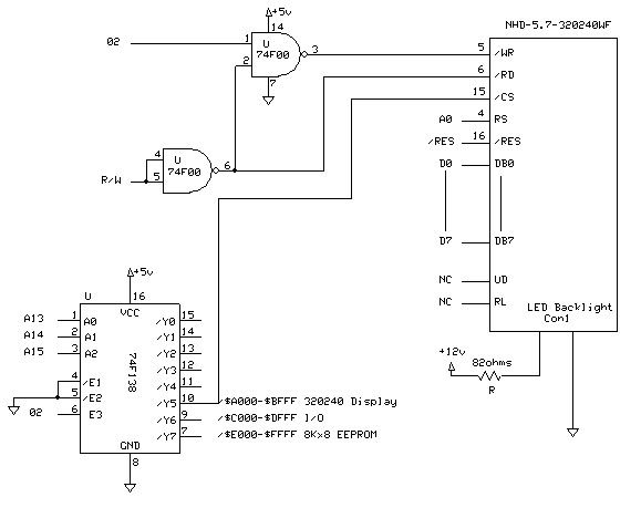

Here's the display interface:
I've tried to use two NAND gates in series with the A0 signal before the display with no change in behavior.

It looks like only the delay between the STAs is relevant, not the one before the first STA. Each delay in your second listing with the NOPs comes to 12 clocks though (2 clocks per NOP), whereas the delays in the first listing only come to 6 clocks each (2 for LDX#, 2 for DEX, and 2 for BNE where the branch is not taken). Too much delay is not usually a problem though.

ElEctric_EyE,
I just took a fresh look at the display datasheet and the FSA5606 datasheets.
It appears you are using the 80-series interface. On page 31 of the FSA5606 datasheet, there is an A/C timing diagram. It shows the WRB (X-WR) pin as being the one that goes active last, inactive first. The CSB (X-CS) should be stable first. It does not show the Read mode, but the diagrams on page 20 do.
According to your schematic, the /CS is gated through clk2. your /WR is gated through clk2 but the /RD is not.
Can you try this:
Remove the clk2 to the E3 input of the '138. Add clk2 to the /RD and /WR signals and see if that helps.
That should get your signals to match the datasheet better.
Just a thought....
Daryl

Thanks for checking that 8bit... I chose the 80 series interface over the 6800 series interface because it looked easier. I admit I have a hard time with timing issues. Logic is no problem, but I can't picture the signals in my brain...
Adding 02(phase 2) to the last stage of address decoding adds so many more gates. Your suggestion is not the first time I heard this, (...it is why I chose the 'F' series TTL, still learning here). I was trying to bypass this timing issue with 'F' series "FAST" logic. Going to rewire some things, report back here in abit. Thanks for all your guys help!

Sounds similar to the 65c22 VIA, which needs the chip selects to be valid and stable before phase 2 rises, meaning you can't gate the chip selects with phase 2.

I think I misread your post the first time I read it 8bit... I have just tried to just hold e3 high on the '138. The display is getting garbage data... I have enough time this morning to rehook 02 back up and try putting the delay between the STA's as Garth suggested.
edit: Tried the delay in between STA's. Looked like this: LDA,STA,delay.LDA,STA. Also tried increasing the value of x. Didn't work.
Any other ideas?
In addition to holding E3 high (which was what I was trying to say, sorry for not being more clear), the /RD and /WR pins both need to be gated with clk2. However, since your code is just performing writes, this should have improved things.
In the original configuration, are you able to perform reads without error?
The datasheet clearly shows the RS being stable first, followed by the /CS, then either /RD or /WR. with /RD or /WR going high first.
A0 (RS) should become stable along with A12-15. The '138 should provide the /CS after its propagation delay (but before clk2 goes high), and the /RD or /WR should go active after the propagation delays with clk2.
There could be an issue with the holding times on the databus after /RD or /WR go inactive. You would need a scope to check that.
If I understand the datasheet correctly, you set up the internal RAM address pointer , then enable writes to RAM, followed by a stream of data write cycles, and end with a "finished" command. Is that correct?
Could you post all of your code used to init and communicate with the display? We might be help more if we had a bigger picture.

Now thinking... You say A0 should become stable along with A13-A15. Do you think my problem is not gating A0 with 02 as I gate A13-A15 with 02 on the '138? ****, I'll bet you that's my problem! I thought there was something up with A0, I originally just tried putting it through 2 NAND gates to delay it. BRB...
No, A0 should not be gated with 02. It will become stable and stay stable for 1/2 of 02 low and all of 02 high.
