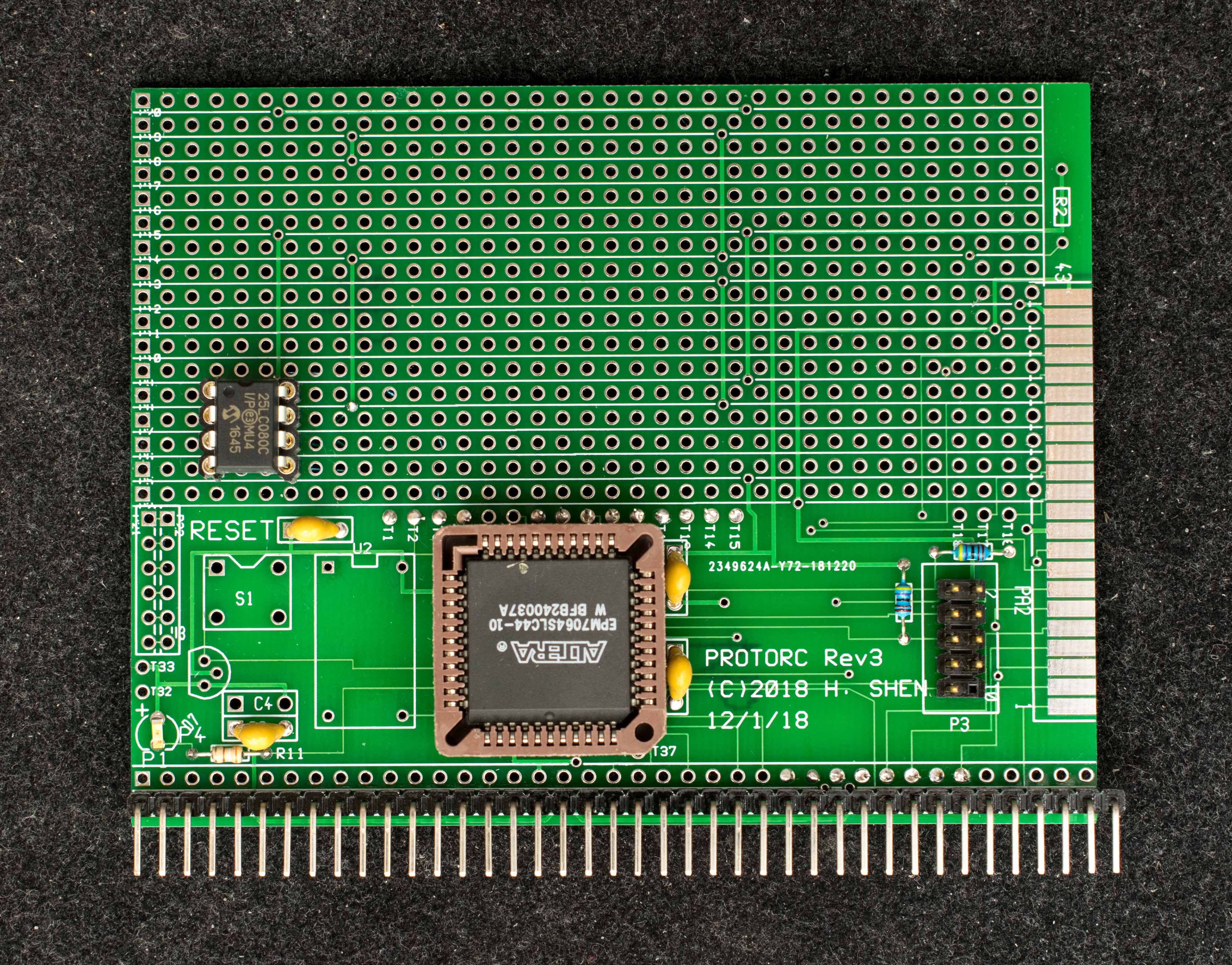

I ordered a few SPI EEPROM, 25LC080, from Mouser and built a CPLD protoboard so I can use CRC65 SBC to test the 65SPI designed in Altera schematic. The CPLD prototype board already have existing pin assignment so I removed a few pins from 65SPI so they will fit. The pins removed are MRD, MWR, CS2, and 5 slave selects. It compiled OK with 75% macrocell utilization. I'm ready to write the software to test the SPI.

Powered up the board and no smoke!
25LC080 is a relatively slow SPI device, so instead of using external clock, I just slow down 6502 to 7.37MHz. Fixed a couple simple mistakes and I'm able to talk to 25LC080, but there is a problem: writing to SPI control is causing soft reset even though the software reset bit is 0. I believe the problem is due to data bit 7 not valid until near the falling edge of PHI2 clock. While data bit 7 is changing, it can generate glitch on the asynchronous preset of flip flop. I redesigned the SRES logic so data is latched in on the falling edge of clock and cleared on the next falling edge of clock. In attached schematic, the bottom flip flop was the original SRES logic. The top flip flop is the modified logic (note: nCLK is inverted PHI2).
With that mod, I can now change the SPI control without spurious reset. I have more tests to do...
