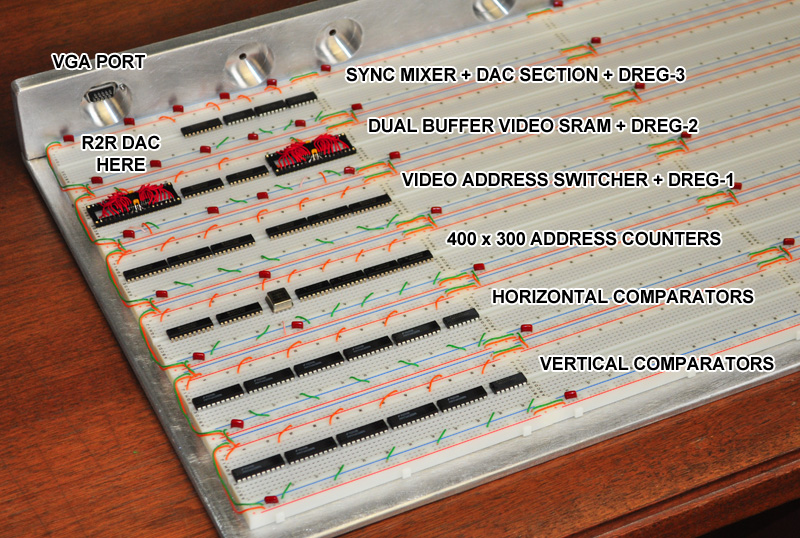

Had an hour of free time last night, so I added all the connecting wires and decoupling caps to the breadboard and then layed down the video driver section.
It's cool that the entire video section only took up one column out of the 4 available on the massive board.
This small bit of circuity is a complete 400x300 VGA driver that includes a seamless double buffer, offering synced frame switching of fully bitmapped displays so that the CPU or GPU can have complete independent access to one video memory while the other is being hurled out to the monitor. Both SRAMs are 512K, but I am only using 120K of each. Addresses are mapped as 9X and 9Y so that dealing with the 9th bit is only a single compare / branch in code.
The VGA circuit is clocked at 20MHz by the can at the center, and drives the 800x600 VGA standard, following timing to the EXACT cycle. Video is divided in half both horizontally and vertically so that banding is kept to a minimum. As it stands, this video system could accept addressing from any microprocessor capable of handing 18 address lines and 8 data lines. Any 32 pin uC can plug right into this system.
I am not planning to let the 6502 talk directly to the video memory, because it wouldn't be able to do much. Trying to spew out bytes at 16-20MHz and draw something more complex than Space Invaders would make the 6502 cry, so the next column of the board will be a logic based ultra fast GPU system, capable of block transferring variable sized bitmaps from a dedicated 1024K memory to the back buffer via commands send by the 6502. The GPU will be capable of sending 20 million pixels per second back and forth, including a selected transparent "Alpha" color, that will allow overlapping sprites without having to resort to "standard" gaming tricks like xor copies to maintain the background, as these are horrifically slow.
I think the GPU may take more than one column on the board, so it will be getting tight to squeeze the 4 channel sound system in there!
Here is my video layout so far (based on the other breadboard mess that works perfectly)...

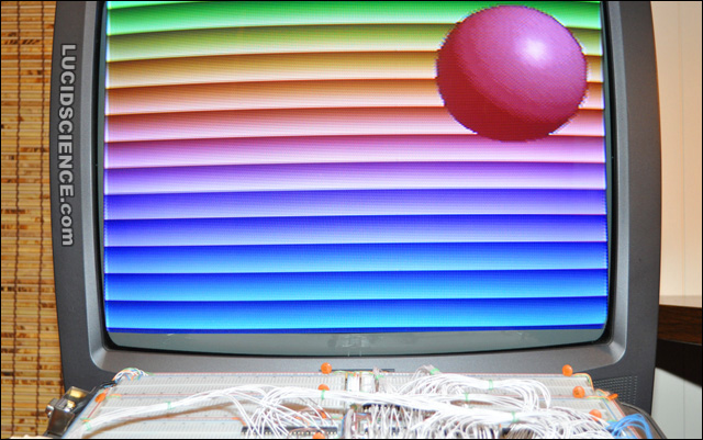

Had an hour to spare tonight, so I threw on some era-appropriate music (Judas Priest), and added a few things to the Vulcan board.
After cutting a few holes with a boring mill, I added ports for VGA, Audio, Power, and a Switch.
Wired up the R2R DAC and tossed in a 574 register so I could test the VGA port wiring.
Notice the color of the wires, which correspond to the color space of RRR-GGG-BB.
This quick and ugly code hack tosses 50 sprites around the screen over the bitmap.
Sprites are 256 colors, have transparency, priority, and can be any size.
These sprites are 32x32. In reality, the aren't really "sprites", I just like the name!
To get VGA to the new board, I stuck 12 inch long wires from the other board out to the new 74HC574!
The 400x300 VGA image looked just as clean!
Isn't it amazing what you can get away with when you should know better but try anyway!!
Ok, that's all for now, going to hit the Tequila and relax!
