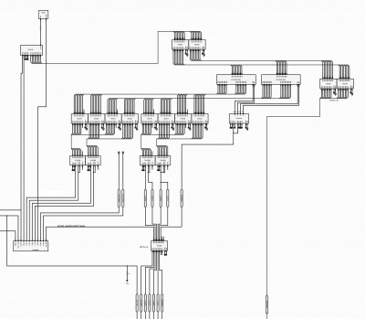

PostPosted: Fri Nov 15, 2024 3:25 am
Posts: 690
Here is the frame buffer segment of the video circuit.
Nice and simple, but also very fast.
The 6502 writes to the one video memory while the other is shifted to the CRT display.
On the VBlank, the 6502 flips the buffers. This lets the OS continue to work as the SyncGen hammers out the screen.
The SyncGen is made of several counters and 688 comparators.
Dual buffers are probably overkill for this project, but it's not like I am afraid of adding more ICs!
Brad

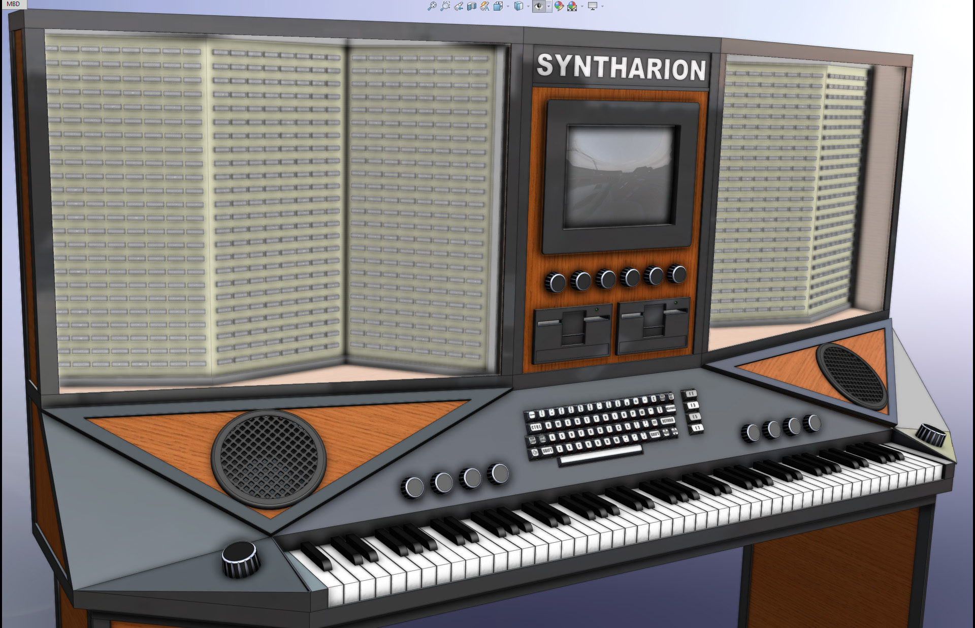

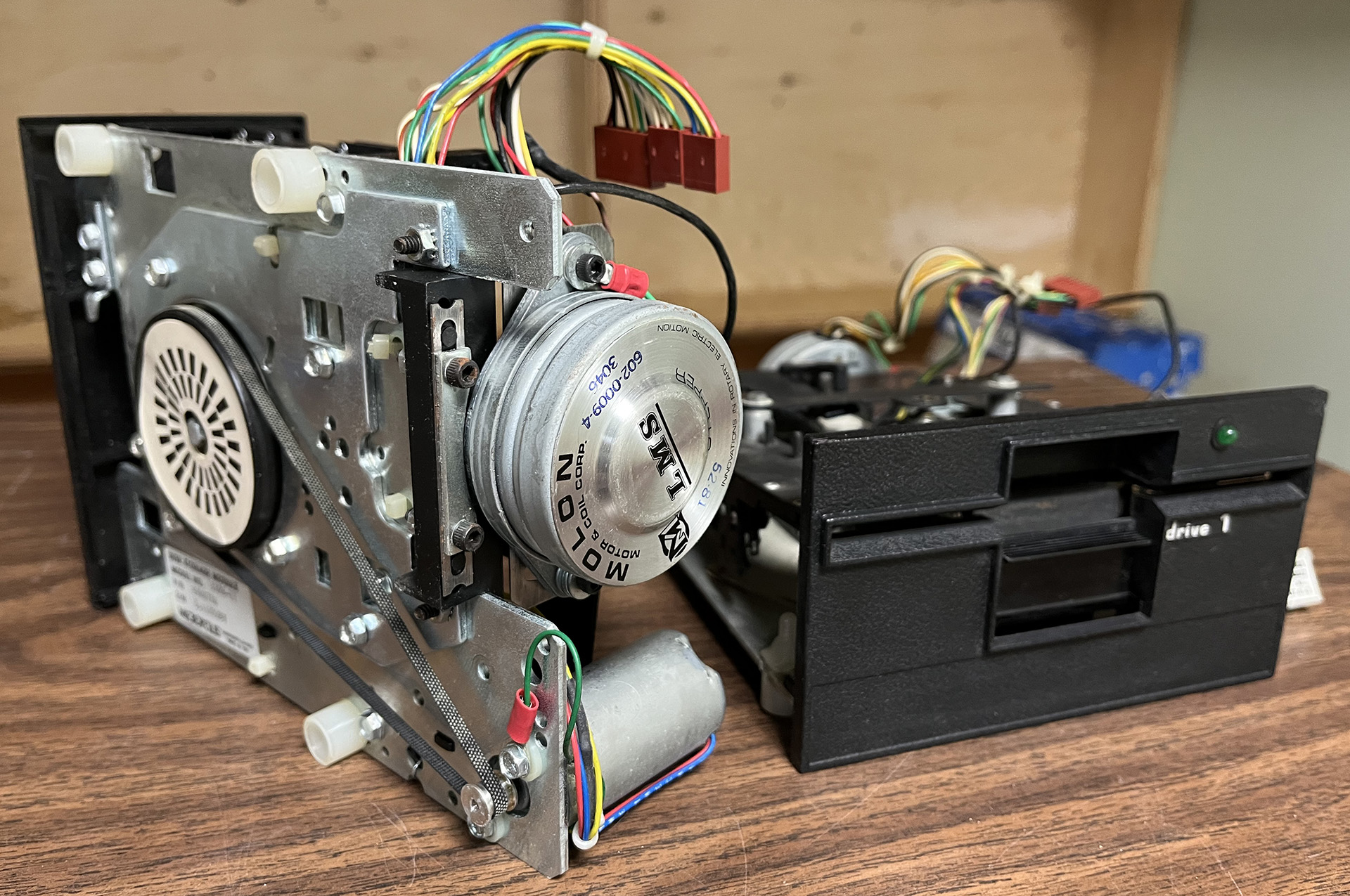

PostPosted: Mon Nov 18, 2024 1:15 am
Posts: 690
I had a meeting with "Admiral Computers" this afternoon and they helped solve one of the problems I was having with the current design.
I was using a single 170K floppy from their V20 home computer, but this required a lot of disc swaps between OS loading and the samples.
Since each of the 16 channels can hold 512K worth of sample data, this became really tedious.
CEO Jacques Leimart pounded his fist on the desk and proclaimed... "you shall have dual half meg disk drives"!
And just like that, two of these beauties came off the 8050 disc drive production line....
Not only that, but they are supplying the complete controller board that allows a much faster IEEE parallel interface.
Now I can load an entire channel from a single disc in under a minute. Just amazing!
With dual drives, users can leave the core OS disc in Drive-0 and load songs or samples from Drive-1.
I have also received the keyboard assembly from their Japanese factory, and it is great.
Also the same one used in the V20 home computer.
I updated the model to reflect the new drives and keyboard.
The keyboard cutout will be made this week using the high precision angle grinder.
Still searching for a wood panel source, but no rush.
Will keep working on the frame as long as winter is a thing of the past out here.
Radical Brad
PostPosted: Mon Nov 18, 2024 11:45 pm
Posts: 690
The keyboard assembly arrived today, fresh from the Admiral V20 production line.
What a great mechanical keyboard, and a simple Row + Column matrix interface.
I made a paper template so I can transfer the dimensions to the keyboard front steel panel.
I will hack out the opening with a grinder, keeping inside the lines and then tune it with a hand file.
The function keys will probably be the most used keys with apha keys being mainly for song naming when saving.
Brad
PostPosted: Tue Nov 19, 2024 12:00 am
Posts: 8503
Oneironaut wrote:
I had a meeting with "Admiral Computers" this afternoon and they helped solve one of the problems I was having with the current design...
Surprised you didn’t track down some SFD-1001 floppy drives.  1MB per disk, and a more-rugged, half-height Panasonic mechanism with optical track zero sensor.  Had two of those connected to my C-128D before I switched to the Lt. Kernal.  They were very reliable.  My only beef was the CBM implementation of IEEE-488 is like molasses in January compared to what it is capable of doing speed-wise.
