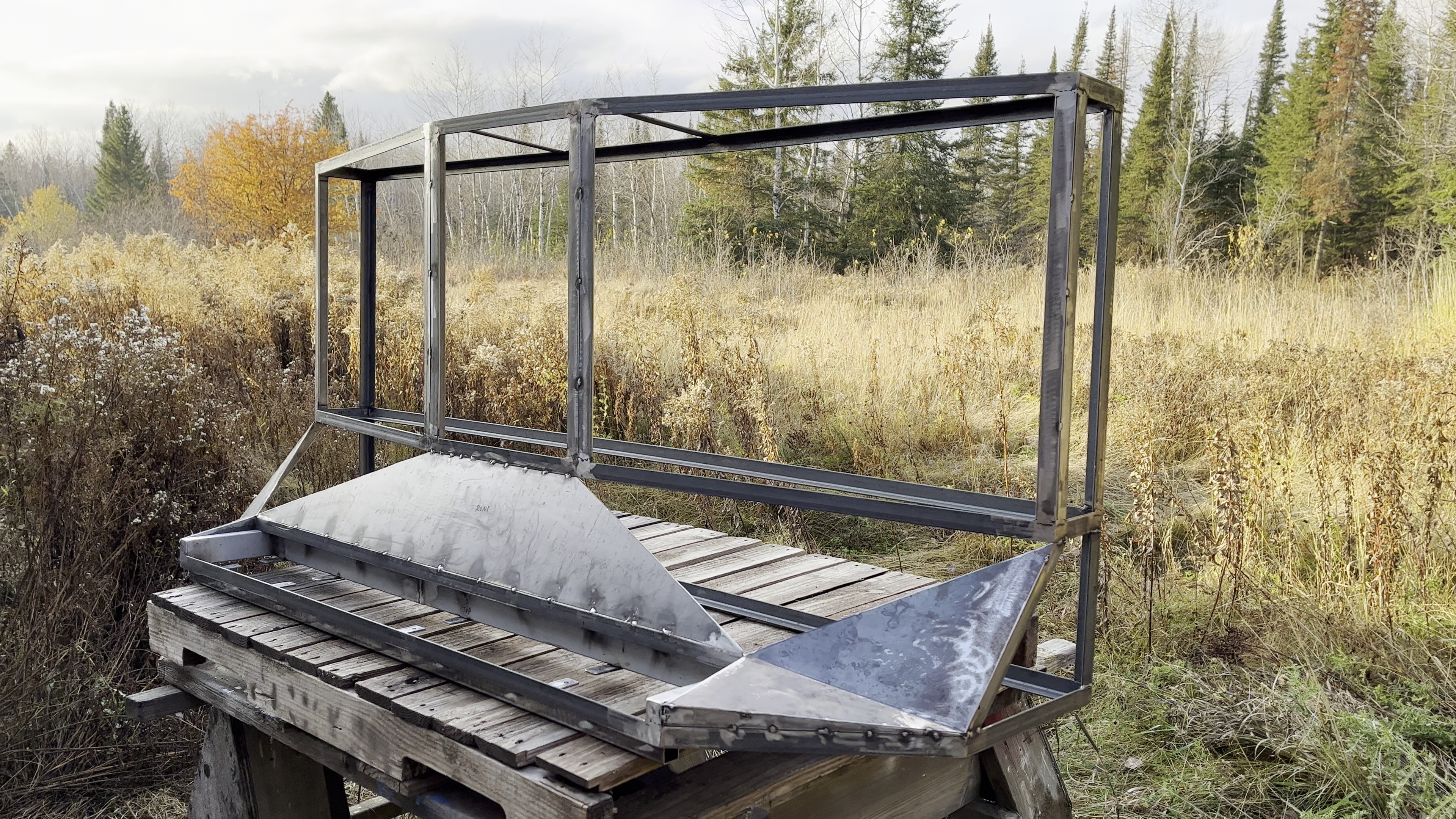

On that note, I am sourcing some sturdy floor safe casters this week to I can create the removeable legs. I am a few welds away from a base frame, so if the weather sends snow then at least things can continue indoors.
Goals this week... speaker grill frame welds, build a stand on wheels, install the CRT frame.

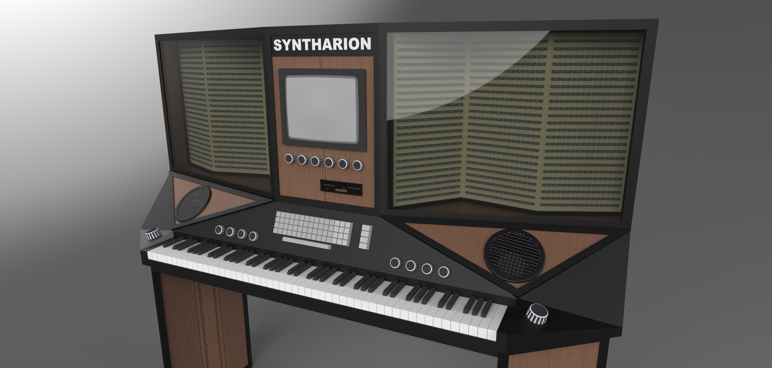

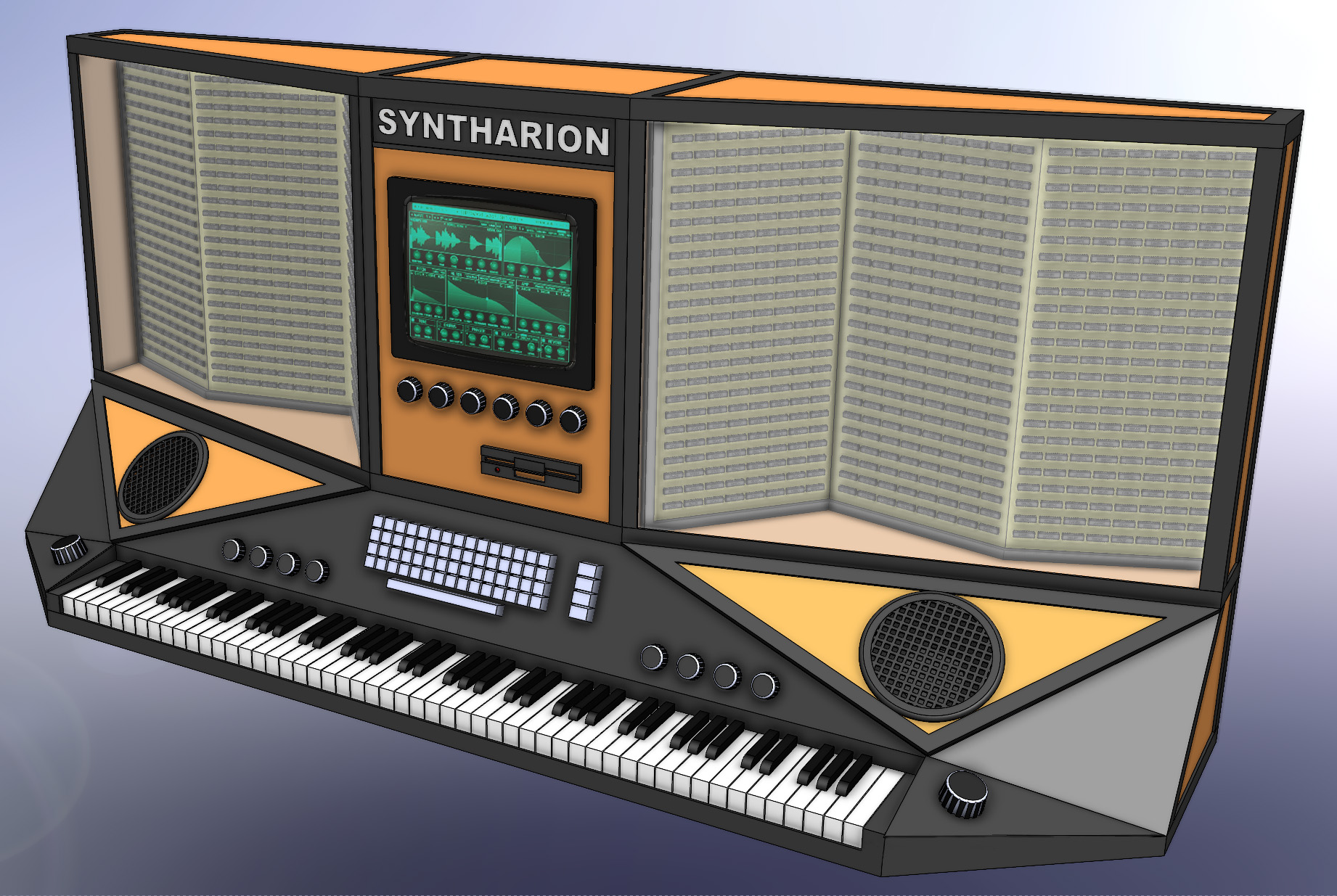

Boring night in a small hotel along the North Shore of Lake Superior tonight.
I wasn't planning on working on the 3D model anymore, but it does give inspiration.
This isn't the final layout of controls, and I may change the speaker grill design, but this is probably close to what the final Synth will look like...
On my way home I am stopping at the hardware store to get the four 5 inch casters so I can finish the rolling stand this weekend.
Next parts to acquire will be the front glass panels and a source of 1/2" thick cherry wood or mahogany for the trimmings.

PostPosted: Sun Oct 13, 2024 10:54 pm
Posts: 693
Not much to report on frame development as I have been busy with work.
It was cold and rainy today, so the outdoor welding shop was closed.
I did manage to work out the basic frame for the stand that I am going to make.
This will use up the last of the angle and flatbar that I have sitting around.
Basic renders, not showing the pull out floppy disk drawers yet....

PostPosted: Mon Oct 21, 2024 11:59 pm
Posts: 693
Almost done roughing in the main part of the frame now. It's amazing that there is no snow on the ground yet, but not cool that the sun goes down by 7:30.
I can't weld in the dark, but did actually start on the stand tonight. Having the frame indoors for the winter is actually going to happen.

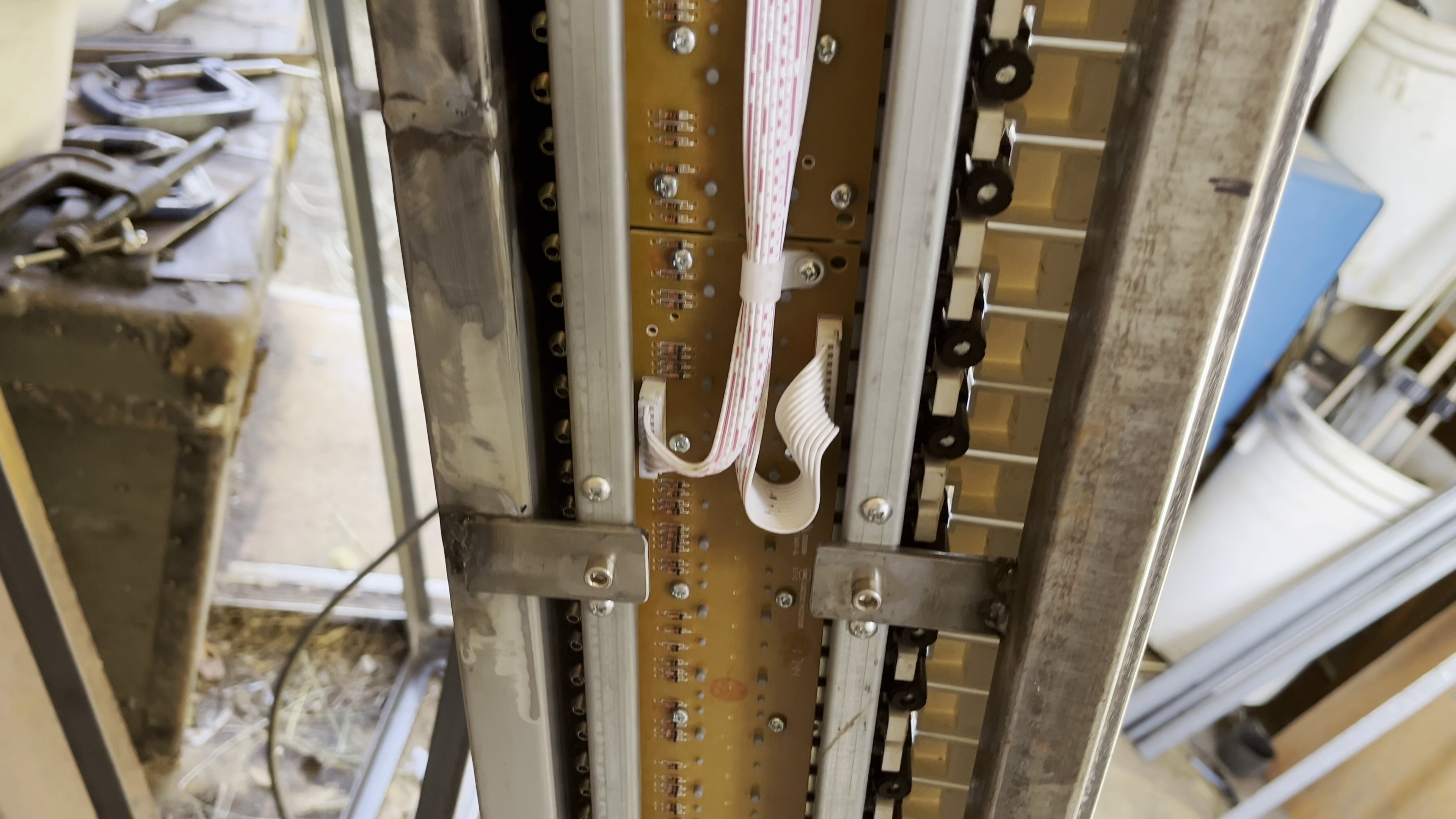

Also did the precision work needed to mount the 88 key piano board.
I was quite challenging since there is only 1/16" of clearance around the keys and the frame.
Once the stand frame is done, I will cut various bits of generic plywood so I can fill the sides and work on the huge PCB framework.
