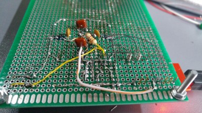

And I'll bet you can use the values stated on the schematic -- no need for variable caps. Good luck!
Well... actually, I'm running FCLK with no capacitors at all. IDK why, but leaving the ones that schematic showed made the MCU unable to make the ~5Mhz crystal run. So I think I will have to get caps with values nearest to the ones that the trim caps I previously had, had.
Or put the trimmers again. I had the MCU running stable for about 9 hours and then freezed, so I can't tell that part is done.
I think I'm testing the 6Mhz output the FTDI232 provides...
PostPosted: Sun Jun 28, 2020 4:50 am

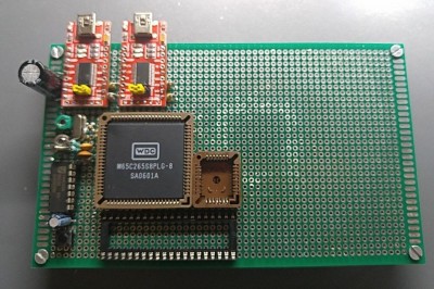

This looks quite a lot better. But in the 2nd photo, are those bare wires leading away from the upper right corner of the '265 ?? :shock: A wrapping experiment, perhaps? -- something you'll remove later?
PostPosted: Sun Jun 28, 2020 10:16 am
Posts: 344
Not bare but thin black insulated wires that were what my local electronics store have for sale. I can't tell exactly because the didn't knew. Maybe 22 AWG or something. They carry the serial data lines.

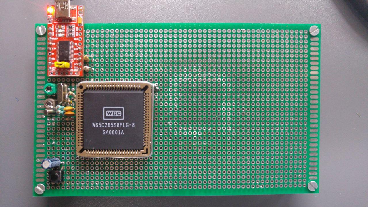

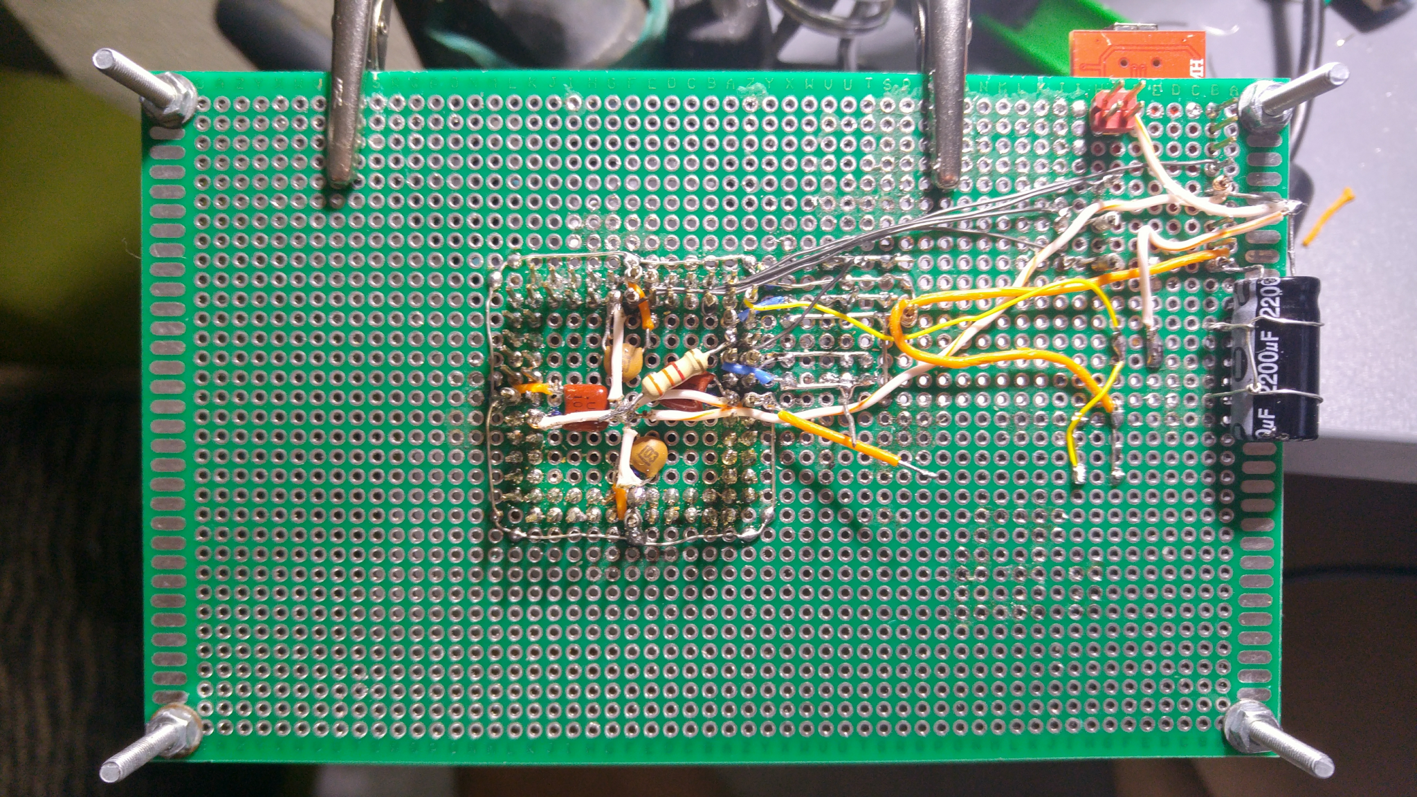

I decided to rearrange my geek room, and also decided to rearrange the SBC.
As I received the final items for the first part of the project (128K of 55ns RAM, the EEPROM and its socket, the 74HC00 chips...) I decided to move the MCU to the left.
So I have to desolder everything, rearrange the bottom part of the SBC to have as much as possible under the MCU itself, and put the reset button in a corner.
The board itself got a bit burnt because I used a heat gun to get all the soldered pins liquid at once.
I also got rid of the pins, because I just couldn't get the ability to wire wrap the right way -- also, the space was so full of pins that for me it was a no-brainer to take them away.
It's waaaay cleaner than before.

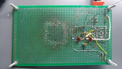

PostPosted: Sun Jul 19, 2020 4:05 pm
Posts: 344
PROGRESS:
I've added a second serial port to my board, as I intend to implement Andrew Jacob's w65c265sxb-hacker tool.
I also have added a 74hc00 there, just at the left of the MCU.
I'm modelling this prototype after the w65c265sxb, and now I'm going to add both the EEPROM socket and the SRAM socket.
