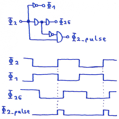

And there it was... staring at me... all this time.... Dang!
download/file.php?id=9005&mode=view
Take a look at gate U14C, in the upper left corner... The timer should tick on the rising edge of PHI2 only if DECREMENT is high.
DECREMENT comes from the clock pipeline and is always 1 when counting PHI2 pulses, and it will be a single clock wide positive pulse when counting CNT, or TA underflows.
And sure, if DECREMENT is high, a rising edge on PHI2 makes the timers tick once... but it will do the same whenever DECREMENT goes high during high phase of PHI2.
So there it is, my extra count on CNT pulses, my extra count on one-shot mode, My (unnoticed) counting one cycle earler when setting START to 1. There is it probably the cause for 80% of the issues in the timers!
I'm going to try to generate a single pulse, on PHI2 rising edge, with 3 inverters+ an and gate, pretty standard stuff. PHI2 will be delayed by an aditional inverter that will clock the FFs in the clock pipeline, adding further delay to the DECREMENT signal. At least in theory, and using the Typical propagation delays in the datasheets, everything adds up. I get a ~18 ns pulse on PHI2 rising edge, that ends before DECREMENT goes high. Everything is pretty tight though... will need to run some tests before doing anything else.

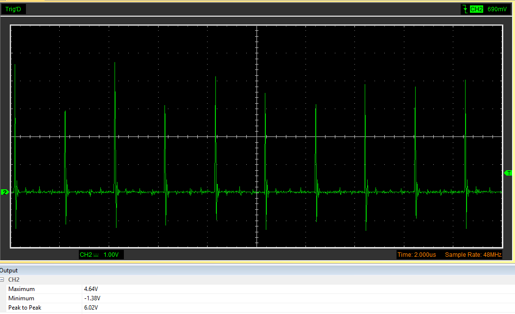

Edit: A quick breadboard test I just did is extremely promising. Passing PHI2 through 3 inverters, and AND'ing it with itself gives me a ~20ns pulse (measured with a 20mhz not-very-precise oscilloscope). Pretty much in line with my estimation. That pulse is properly driving the '193 counters, and there seems to be a 40-50ns delay between PHI2 rising edge and the counter ticking. Half of this delay comes from the counter itself. I need to make sure DECREMENT won't rise within 30-35ns after PHI2 rising edge. For that, the DFF in the clock pipeline will be run with PHI2 delayed by 4 inverters. This, along the delay of the DFF itself feels like more than enough.
Also, with such a short pulse, I'm probably diving into some high-frequency zones. A clock with 40 ns cycle (20 high 20 low) is 25 MHz. The side effects I'm seeing because of this, is that the breadboard circuits works with decoupling caps only. Without them, I'm getting random unwanted ticks on the counter. Even with the caps, I'm getting quite a bit of ringing. I'm hoping for this to be exaggerated by the breadboard and for it to be less severe on a proper PCB.
As a personal note, this is probably the first time in this whole project I've had to look this deep into the propagation delay of a whole path... and I can feel something finally clicking into my brain about it! Still a long way to go of course, but it feels very good :)

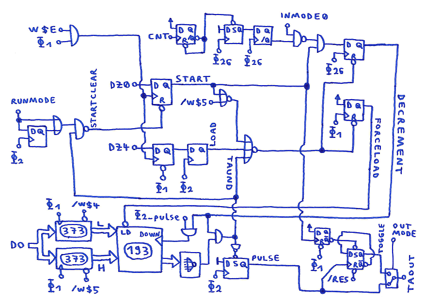

Had some time at hands for drawing a "cheat sheet" for Dani's timer control logic.
Omitted the reset circuitry to make it more easy to read.
During reset, timer and timer latches are set to -1.
Sometimes it doesn't come out clear whether sontrol signals are HIGH or LOW active,
but considering it's a beginner project it doesn't look bad.
A short overview about the clock dependencies.
Changed PHI2'''''' to PHI26 (PHI2 with six apostrophes).
Looking forward to see, how the adventure continues.

It's funny how I'm able to understand your schematics better than my own! That probably means I'm somehow putting together different pieces of a puzzle, while you're able to imprint some meaning in them. I like that.

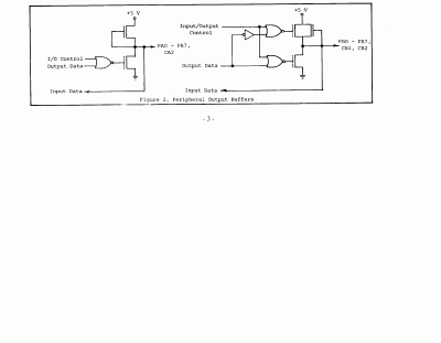

As I have been pointed out several times, in several places, I have a big design flaw in my ports. They're not open collector, as I'm activelly pulling up the outputs. So far so good, this has worked for me (Being able to use a floppy drive with my ports whas a big milestone, quite a long time ago!) but, as I've been gaining more knowledge (ok, not a lot, but some :) ) I came to understand, this was a big flaw.
First alarms went of when I found some people talking about my work, in other forum, and mentioning "A killer poke" for my design. Pretty easy to see know... of course..
In a C64, ports are used to read the keyboard matrix, as you may know. Set both ports as outputs, pull one high, one low. Press a key, a Boom!. A short to ground. Yikes!
So yeah, I've been thinking of a couple of ways to amend this. @ttlworks suggested using some buffers ('125 or '126) with it's input tied to ground, that would be put in High-Z when the port had to output a 1, relying only on the external pullup to output a high value. So I went ahead, and layout a new board with this setup.
However, after further investigating... I made one (at least for me) big discovery. PortA and PortB are not the same. First clue was deeply hidden, in a readme.txt for a C64 emulator test suite. It's intented to be run on emulator to compare with the expected outputs and, when it comes to the ports. this is what I found:
* Port A outputs high, Port B outputs (active) low.
- In this case port B always "wins" and drives port A low,
meaning both read back as 0.
* Port A outputs (active) low, Port B outputs high.
This case is a bit special and has some interesting properties:
- Usually (probably unexpectedly) port B will NOT be driven low by port A,
meaning port A reads back 0 and port B reads back 1.
- port B will be driven low (and then read back 0) only if the resistance of the
physical connection created over the keyboard matrix is low enough to allow
the required current. this is (again) usually not the case when pressing single
keys, instead -depending on the keyboard- pressing two or more keys of the same
column is required. a special case is the shift-lock key, which will also work
and which you can seperate from the normal left shift key in this configuration.

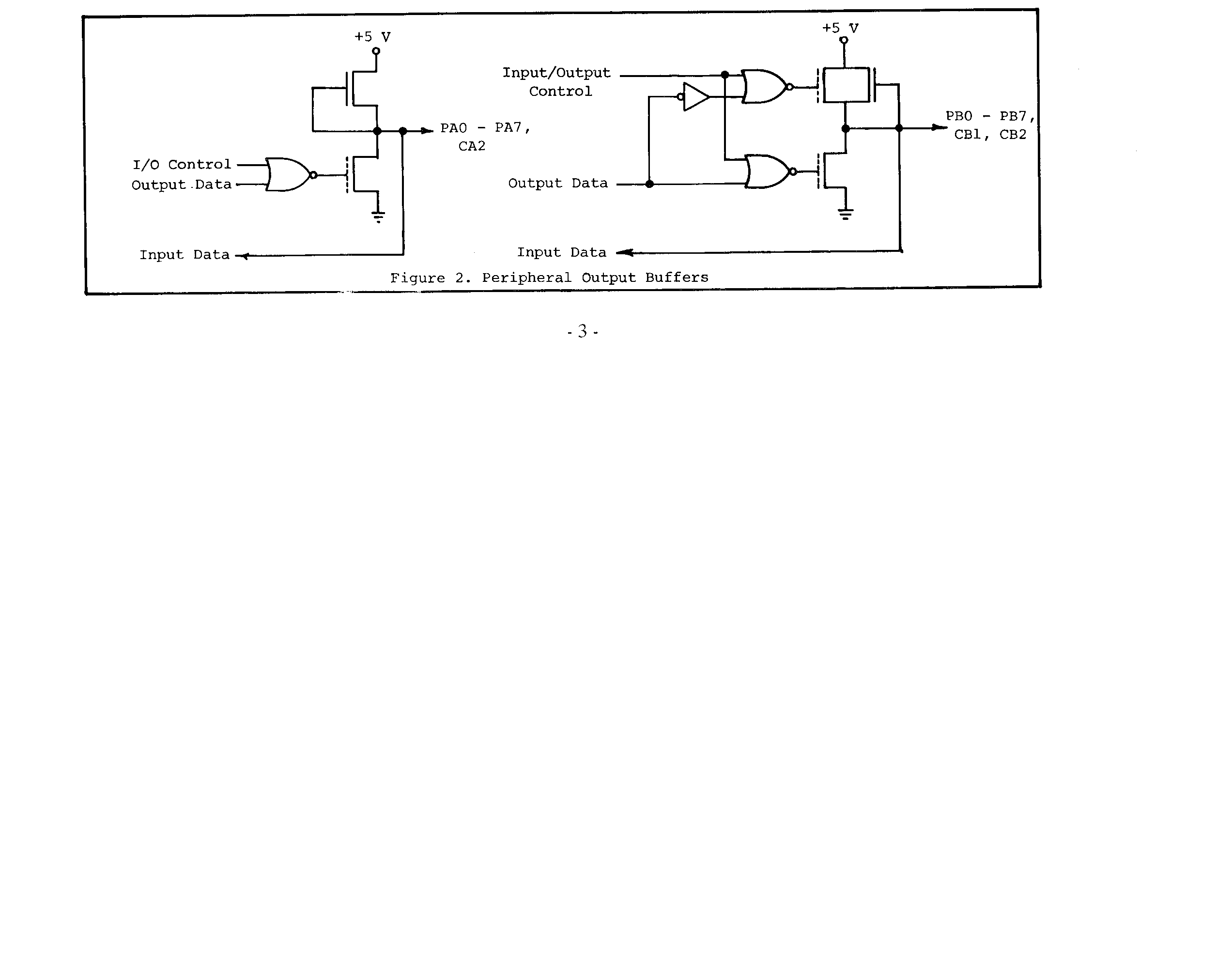

Second clue was found on an old scanned MOS6522 datasheet.
On the 6522, PortB schematic suggests it has a transistor to pull up stronger, together with a "normal" transistor acting as a pullup. This have to be the "Active and passive pull-ups" that are mentioned on the 6526 datasheet.

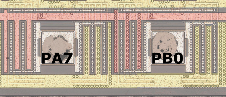

Third and last clue. Back in september, 2019, user fhw72 posted a die shot of a 6526. Even though I'm not able to read silicon in any way, there was something there, completely obvious.
I've taken a section where we can see PA7 and PB0 together. I've colored in light red the VCC metal, light yellow GND. In the VCC metal, nexts to all PB pins, there're plenty of vias, forming what I can only guess is the active pullup. They're not there in any of the PA pins.

I need to dig up my most basic electronics knowledge(Shame on me, yesterday I had to google Ohm's Law :shock: ), but I should be able to find some accurate values for the pull'ups of a rial CIA, and how to best mimick them on my design.

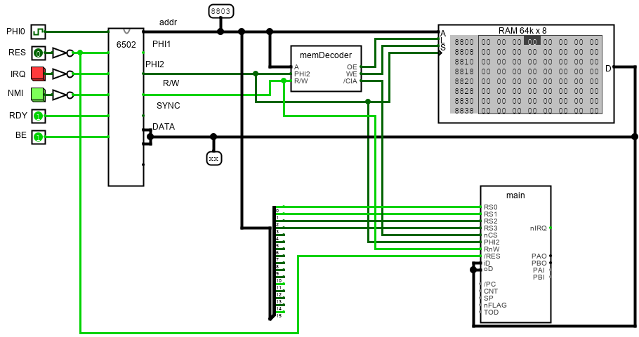

So far, I've been using Intel Quartus for my logic simulations. This is, of course, not its original purpose, so... well... overcomplicated for my needs, and, as I stepped further into the 6526, it became difficult to implement good tests, and this reflected on my work.
But, again, inspired by @Drass excellent work with the 100MHz TTL 6502, I decided to give Logisim a try. If you can properly create the 6502 there... a 6526 must be easy right?
Absolutely right. It took me only a weekend to get a handle on the Software, getting Drass CPU working, and implementing a very crude 6526 (Just DDRA and DDRB). But, amazingly, it is able to run some code, write values into the 6526, and read them back!
So I'm going to redo a big chunk of my work. Get some proper test suite running in Logisim. The circuit above replicates the most basic components of my SBC6526, which can now run with an original MOS6526, so I should be able to run the same code, both in logisim, both in real hardware. That for sure feels like a good starting point for a decent test suite!
