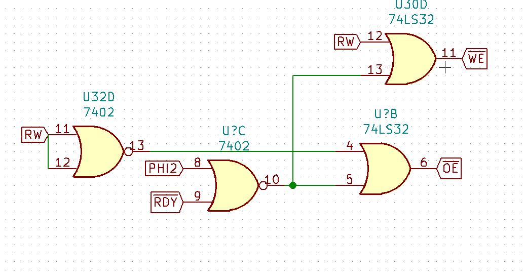

PostPosted: Fri Feb 15, 2019 4:25 pm
Not quite - don't forget to distinguish between RDY and /RDY. Also, you're currently generating ~(Phi2 | /RDY) twice, when you can reuse that signal, and you should try to minimise the gate depth from Phi2 to each control signal (use 3-input ORs if you can, or swap over the ~(Phi2 | /RDY) and /VALID_ADDR if you stay with 2-input ORs).

Treating VDA and VPA as address signals rather than bus-control signals does make some sense, actually. You can generate ~(VDA | VPA) and drop it into the /OE pin of a '688, for example, instead of tying that pin low; some other comparators also have cascade inputs. I think the 74HC multiple-input gates are often fast enough to build address-decoding logic, since the addresses become valid early, so you can use those to help qualify addresses.
Then the bus-control signals are simplified to forms which don't require 3-input gates:
Bank_LE = ~(Phi2 | /RDY)
/OE = (~R/W | ~(Phi2 | /RDY))
/WE = (R/W | ~(Phi2 | /RDY))

So here's my /OE /WE circuit now, as far as VDA and VPA go, I've got VDA qualifying all accesses to any IO, and VDA | VPA qualifying access to the top 8 bits (2 4M memory modules).
I've attached /OE and /WE to the /OE and /WE of all devices that use wait states, the RTC, EEPROM, and DUART (28L92). Other devices are still qualified off my READ, WRITE, and /READ, /WRITE signals, which are made by R/W and PHI2
If this checks out I'm going to look at the clock circuit, and see about either changing it back to a oscillator can or possibly leaving it, but not using it for slowing the clock to talk to devices. One last thing here, iirc using this circuit I've attached I don't need to worry about absorbing clock pulses, since the /OE and /WE of devices won't be pulsing off the clock now, is this correct?
