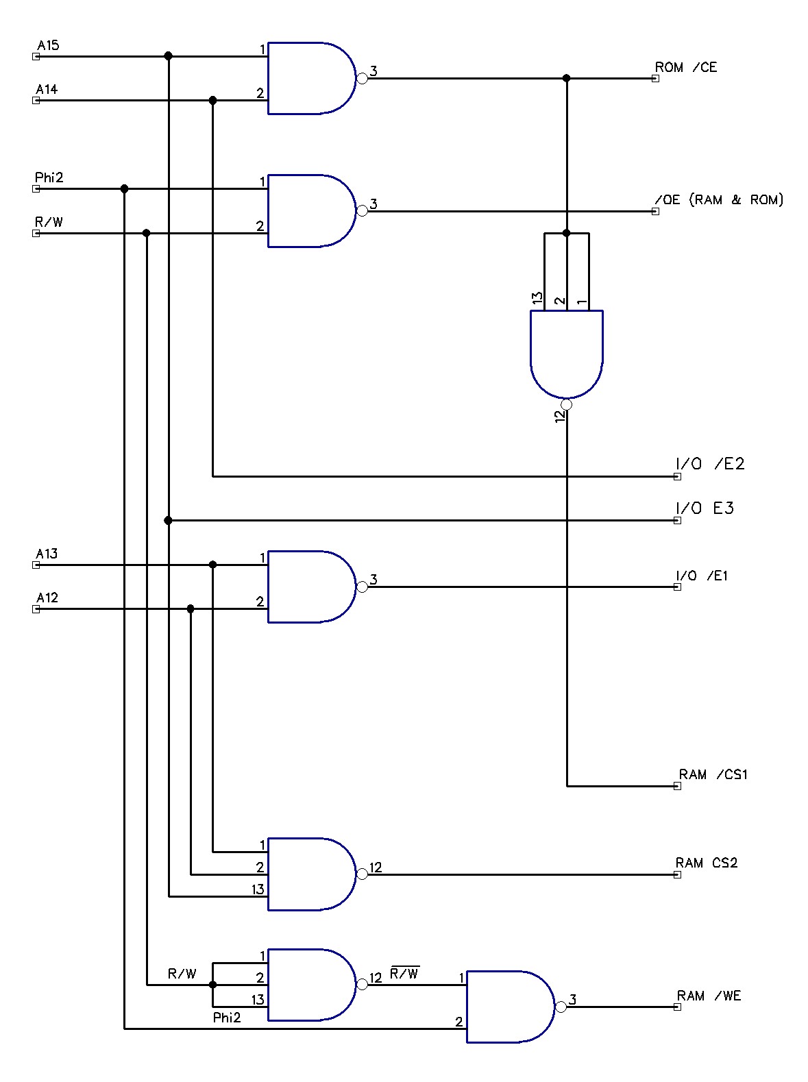

Bill, it looks like you missed one of the changes I made after double-checking my work - so in your schematic /CS1 will do the opposite of what it's supposed to.
You need to send that line to CS2 instead, and feed /CS1 with an inverted copy of ROM /CE.
PostPosted: Fri Jun 29, 2018 6:33 pm
Posts: 1007
You're right!
I'll make the change after 5pm - gotta go...
Edit - Update: Okay, the drawing in my post below this one has been updated and using just 2 74XX00s ... This looks like it.
Just wish you could use faster logic or a slower CPU, but if anything has a chance to work without one of those or delaying the clock to the CPU, this should be it.
Also Dolo, remember to run the Phi2 to this circuit and any other device from pin 37 of the CPU - not pin 39. Leave pin 39 disconnected.
Also included in this post is the improved version Chromatix was talking about - using the 74XX10. If you could see your way to using a 74AC00 and a 74AC10 you would have only approximately 9ns or less of propagation delay in this circuit. Might cost a £, but that would be good for any clock speed the w65C02 is good for.

Sorry for the delay in updating my progress. I have some exciting news, but firstly many thanks to everyone who has contributed to the thoughts on this thread.
Quick run down:
1) I made an absolute buggers muddle of implementing the new decoding glue logic, so that took a while to realise
2) I only had one 74HC00, so moved to using 74LS00 parts only for decoding, with 1k pull ups
3) The output skew and peak voltage from the decoding looked weird, traced down to bad power on the decoding breadboard
4) Finally, she seemed to awaken as if all was normal:
4.1) Keyboard - Check
4.2) Video - Check
4.3) Sound - Check.
4.4) Serial - NOPE. Serial was working but only at the lower 2.68Mhz speed. At 5.34Mhz seemed to transmit fine, but glitchy receive. I suspected the 2Mhz part I am using is sensitive to clock speed and I was lucky previously, but..
5) After a little experimentation, putting smooth caps near the 6551 VDD and VSS lines sorted the serial glitch out.
6) So, back to square one but with optimised decoding logic?
NOT SO! So the obvious thing to do was put in the 15ns SRAM which was not working with the previous decoding logic. Voila, works absolutely nicely with no glitching. It was something I privately felt could happen given all the poor practices I had gotten away with in my original design, so it's excellent that taking back to reference practices has fixed the mystery.
In conclusion, the main issues with my existing design were (in order of impact):
a) Decoding logic had a lot of delay and contra-practices and using 70ns SRAM was probably masking this :oops:
b) Poor power handling e.g. need more smoothing caps across power and ground lines needed at higher clock, was probably getting away with it marginally up till now
c) Care with breadboard power and signal distribution - they are glitchy, noisy little buggers as the clock speed goes up. Having said that, they have allowed me to get on this journey in the first place, so have a soft spot for breadboard (for purely personal projects).
Many thanks again to all of your contributions - really pleased with the outcome on this one :D

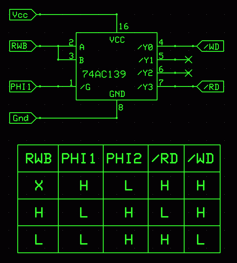

If you have to real estate, then this solution offered by BDD to produce a qualified write (/QW) should work as an alternative to delaying the clock to the CPU...
Here's another circuit I concocted to generate Ø2-qualified reads and writes. It uses one section of a 74AC139 1-4 decoder, along with the PHI1 output of my clock generator circuit.
File comment: Alternate Read-Write Circuit

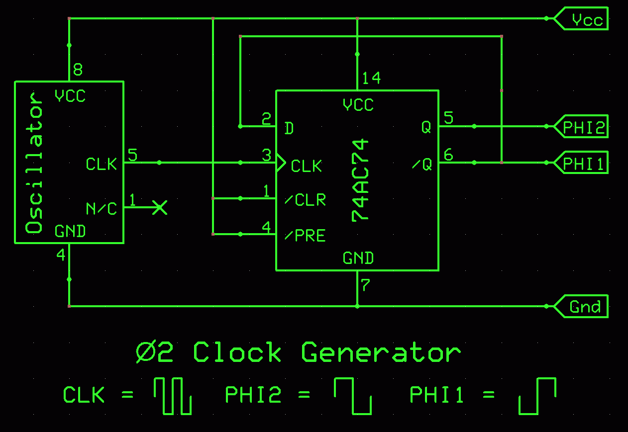

Here's the clock generator circuit again.
File comment: Two-Phase Clock Generator
When /G on the '139 is driven high, all /Yx outputs are driven high without regard to the state of the A and B inputs. As /G is connected to PHI1 of the clock generator, it will be high when PHI2 is low, which keeps /RD and /WD high while Ø2 is low. Reading and writing are inhibited.
When /G is driven low, which it would be when PHI2 is high, one of the outputs will be driven low according to the state of A and B. Since both A and B are driven by RWB, the only possible outputs are /Y0 being low when RWB is low, or /Y3 being low when RWB is high. So we get /RD = low when RWB is high and Ø2 is high, or /WD = low when RWB is low and Ø2 is high.
The state changes of /RD and /WD lag Ø2 going high by an average of 6ns at 5 volts, which is very slightly slower than the NAND gate equivalent.. However, it's still more than ample timing headroom for even the fastest 65C02 or 65C816 unit.
What's the advantage of this circuit over the read-write circuit that uses NAND gates? It takes up less space on the drawing. :D Other than that, it doesn't do anything the multiple NAND gate circuit doesn't do, although fewer connections are required. The circuit, however, is illustrative of how a particular piece of logic can be used in ways other than originally intended.
