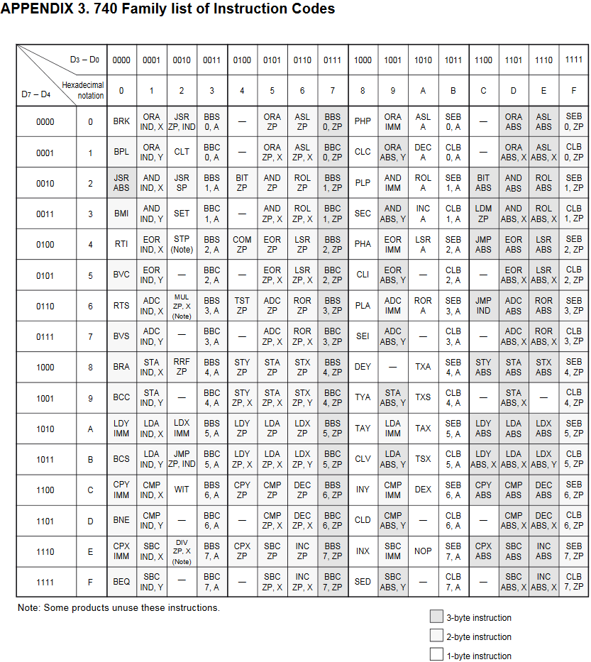

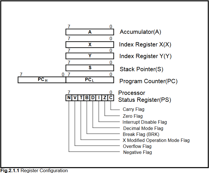

While looking a bit around in the internet, I accidentally stumbled over the 740 microcontroller family from Renesas.
Anybody familiar with this ?

An interesting find, very like a 'C02. Two interesting things about it:
When ADC instruction is executed in decimal operation mode (D = 1), execute at least one instruction after the ADC instruction before executing a SEC, CLC, or CLD instruction
X modified operation mode flag T
Bit 5
This flag determines whether arithmetic operations are performed via the Accumulator or directly on a memory location

Haha, there's something familiar with that picture, for this forum..
I did run into the 740/38k maybe a couple of years ago. But I had forgotten about it.

More things there too:
    multiply and divide (at least optionally)
    ones-complement operation
    rotate by four bits
I think this little machine deserves a review of its own!

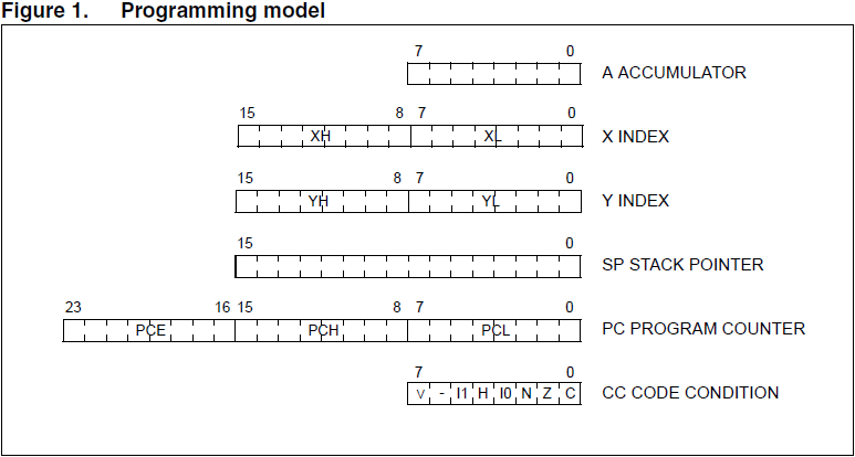

While the instruction set of the STMicroelectronics STM8 microcontroller family looks pretty different from the 6502,
the register set looks a little bit familiar... somehow.
