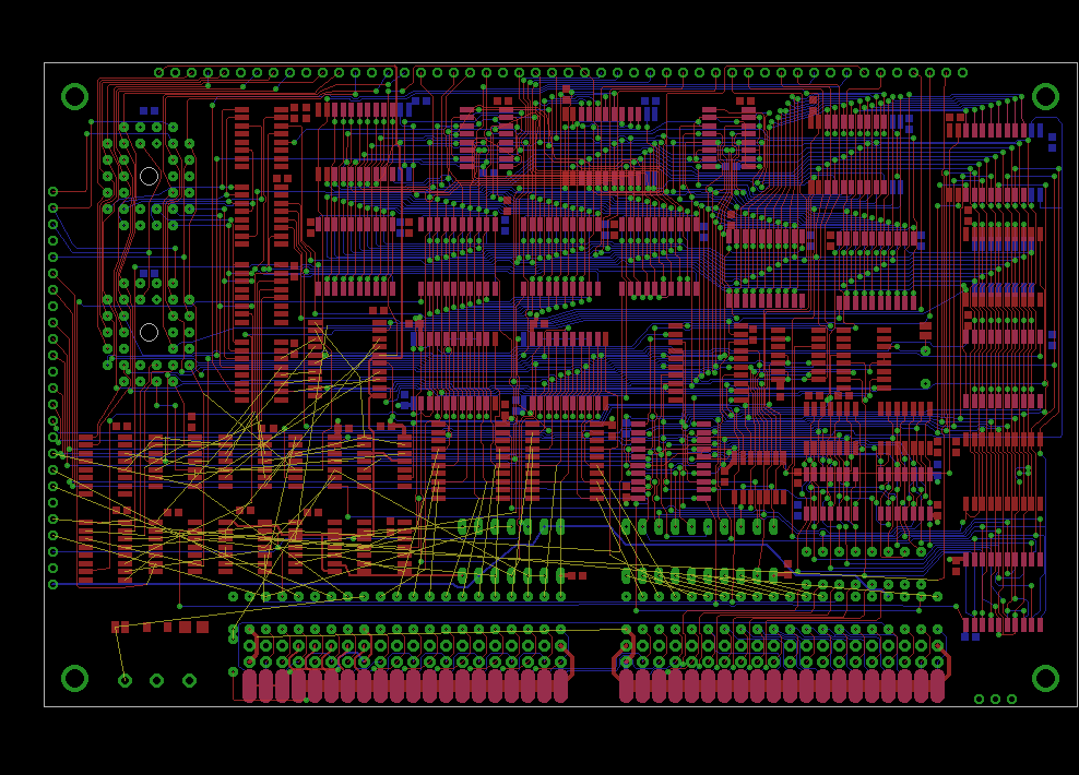

Getting closer ... Still some tricky routing on the lower left to be done, but I think I can see the finish line!

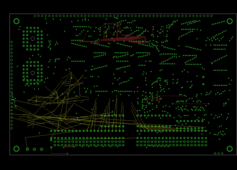

I've managed to keep most critical clock signals on the top layer but the clock going to the 6510 port is still moving around a bit too much for my liking. I'll try to go after it at the next opportunity. I'm also going to replace the individual series resistors with 16 pin sockets to make things a little more manageable. Don't really have the room right now, so that will take some work. Probably will have to wait until next weekend ...
The ground plane remains intact (save for the vias, of course), but as mentioned, I am using the VCC plane to put some traces down - mostly just short bridges to get out of a jam. Hoping that's not going to hurt things too much. Here is what that looks like:

That's it for now. Here's hoping next post will show a finished layout! :D

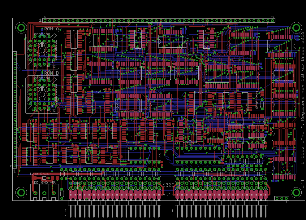

A milestone worth reporting ... 1st pass of the routing on the Registers Card complete :!: :!:
Well, almost ... I have yet to replace the series resistors with sockets. I created new packages for the through-hole ICs with octagon pads to give me a little more room. I think with some fancy footwork, I just might be able to get those sockets to fit. But it's not essential. The board is all wired up as it is so it's a good point to share. I'll sleep on the resistor sockets and may take another crack at it. In the meantime, here are some pics:

I'm very happy with how this turned out. The VCC place is a little cut up, but there are lots of bypass capacitors on the board so it should all work out well.
I'm going to take a hard look at it all and review it carefully but please let me know if anything obvious jumps out.

PostPosted: Sun Mar 13, 2016 6:11 am
It's not a big deal. The VCC doesn't really need a plane, as a bit of inductance between the power supply and the bypass cap only helps to filter the signal. As long as you have bypass caps close to the IC, and sufficiently wide traces leading to the cap (to avoid DC voltage drops), you should be okay.
The extra capacitance between the VCC and GND planes is too small to be useful, unless you a) work with really high frequencies (hundreds of megahertz), and b) take extra care (and pay extra money) to manufacture the board with minimal separation between the two layers.
PostPosted: Sun Mar 13, 2016 2:01 pm
Posts: 428
Location: Toronto, ON
Thanks Arlet. That helps.
On the topic of good bypassing, I ran across this article while following one of Garth's many helpful links: (http://www.sigcon.com/Pubs/news/9_07.htm). It deals specifically with connections to bypass caps when using planes and suggests independent vias from the planes to Bypass caps in that case (rather than for example a wide trace connecting VCC through the positive end of a bypass cap I.e., VCC via -> cap +ve node -> IC VCC pin).
I've ended up using various schemes on this board. I placed one bypass cap close every IC VCC pin and sometimes had the space for independent vias. Most often, however, I used the second method above which saves a via, and even occasionally had to resort to two capacitors sharing vias from the planes. At other times, it was convenient to place the via between the IC's VCC pin and the bypass cap, effectively sharing the via with both rather than VCC going "through" the cap to the pin.
I understand these more restricted paths will likely reduce the effectiveness of the bypass caps but your comments above seem reassuring in that regard. That said, I am contemplating using 74AC chips with fast rise times, so I want to do my best to avoid problems from the start. I'm wondering now whether to go back and work to eliminate those "shared vias" just to be safe. Does a via shared between two caps still provide a sufficiently low impedance path? Does placing a via between pin and cap render the cap ineffective? I would appreciate some perspective as I could easily be over-thinking things. After all, this is far from a "high-speed" board by modern standards.

PostPosted: Sun Mar 13, 2016 2:20 pm
These scary articles are usually geared towards people who design with 0402 or smaller surface mount parts, BGA packages, and a few hundred MHz signals. At the speeds you're working with, you'll get away with a lot worse. The SOIC packages and 4 layer board are already very helpful in reducing inductance. For a corner pin on a big DIP package, the inductance inside the package (that you can't do anything about) is equal to a few dozen vias. Even if you have to add one or two vias, the SOIC packages are still 10 times better.
