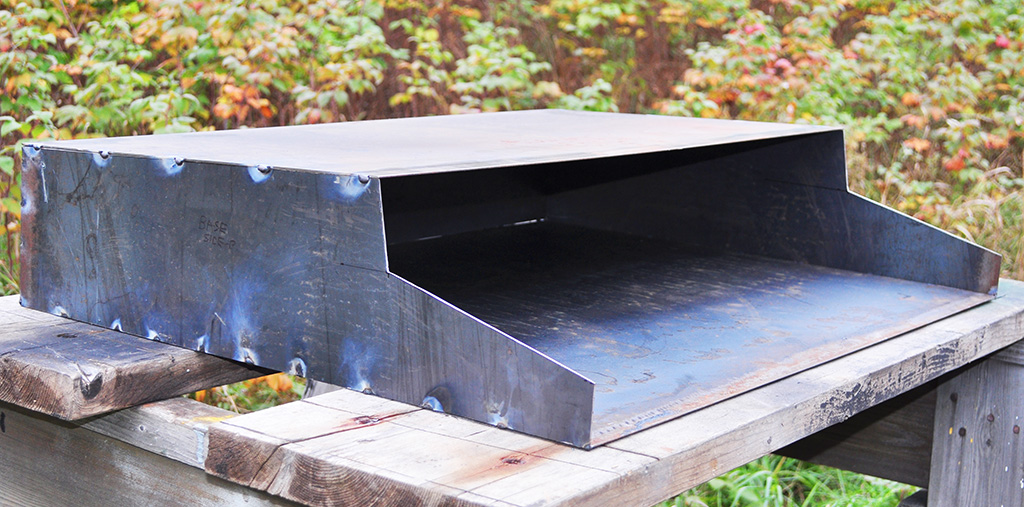

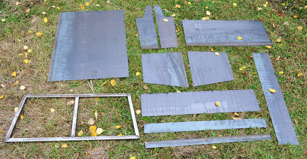

I managed to cut most of the steel for the cabinet as well as the square tube frame for the front of the monitor. The goal is to have the cabinet sitting in my lab over winter to be worked on. Since I weld outdoors, time is running out as the weather creeps towards the negatives at night around here now.
Yeah, I do everything the "hard way". Hand held grinder to cut sheet, welded outdoors on wobbly sawhorses using a basic AC buzz box. Not sure why, but it just makes the end result so much more rewarding!

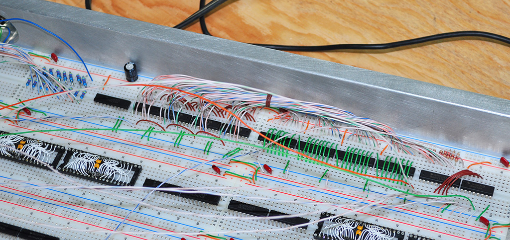

- CJS:Yes, the massive board will be completely hand wired. I intend to take a 750 square inch piece of thin lexan and hand drill every single hole for all 500+ ICs then insert them and run point to point wiring on the underside and VCC + GND on the top. This keeps that "crazy dude" effect strong and allows viewing of the entire job due to the clear board. Also, when the board slides out from the case, it will be able to tilt up to 90 degrees for inspection or repair of the P2P wiring on the underside. I am not a fan of wire wrap.

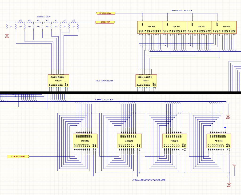

Here is a brief explanation of how I will generate 8192 colors onto my 360x230 NTSC bitmapped screen...
On the top left is the Luma DAC. This is just a basic 8 bit R2R network that creates 256 voltages from zero to about one volt. The composite sync signal is also overlayed onto the Luma signal later down the line.
NTSC color generated by the phase difference between the 3.579MHz burst signal sent before the active line and the overlayed 3.579MHz signal drawn during the active line. The more steps you have between this phase shift, the more colors you can generate.
Since 3.579MHz is about 280 nanoseconds, this limits the potential of delaying the signal by logic alone to 32 steps at most. At 32 steps, there needs to be a delay of only 8.73 nanoseconds between phases. This delay is well within the reach of a typical 74HC245 buffer, so this is why I have the 3.579MHz signal fed into the 4 buffers as shown in the schematic.
Each buffer output feeds the next input, and each output is fed into the 75HC4051 selectors. The result is a selection of 32 phase shifts as per the 5 bit input address.
Since the 74HC245 propagation delay (A to B delay) is a little less than 8 nanoseconds, I will carefully control the current to the 4 gates in the delay chain to oven them out to the required 8.73 nanoseconds. A precision 100 ohm POT on each will do the trick.
The chroma signal drives the color input on the 1702 directly and has no other signal on the line.
The 74HC574's shown in the circuit are there to align the Luma and Chroma on the next clock cycle so that there is no delay in color vs pixel data. This alignment will happen at 7.159MHz, which is the global pixel clock speed of the Video Generator.
Since I am only using 13 bits of the 16 available SRAM bits in the video system, the other 3 bits will be used for the following, which will greatly speed up the logic...
BIT 05/15 : Alpha Bit (creates built in sprite transparency).
BIT 06/15 : X Reset Bit (for faster Sprite Engine X/Y Logic).
BIT 07/15 : Y End (for faster Sprite Engine X/Y Logic).
I have most of this on the breadboard already but won't get to test anything until it's too cold to work outside.
Later!
Brad

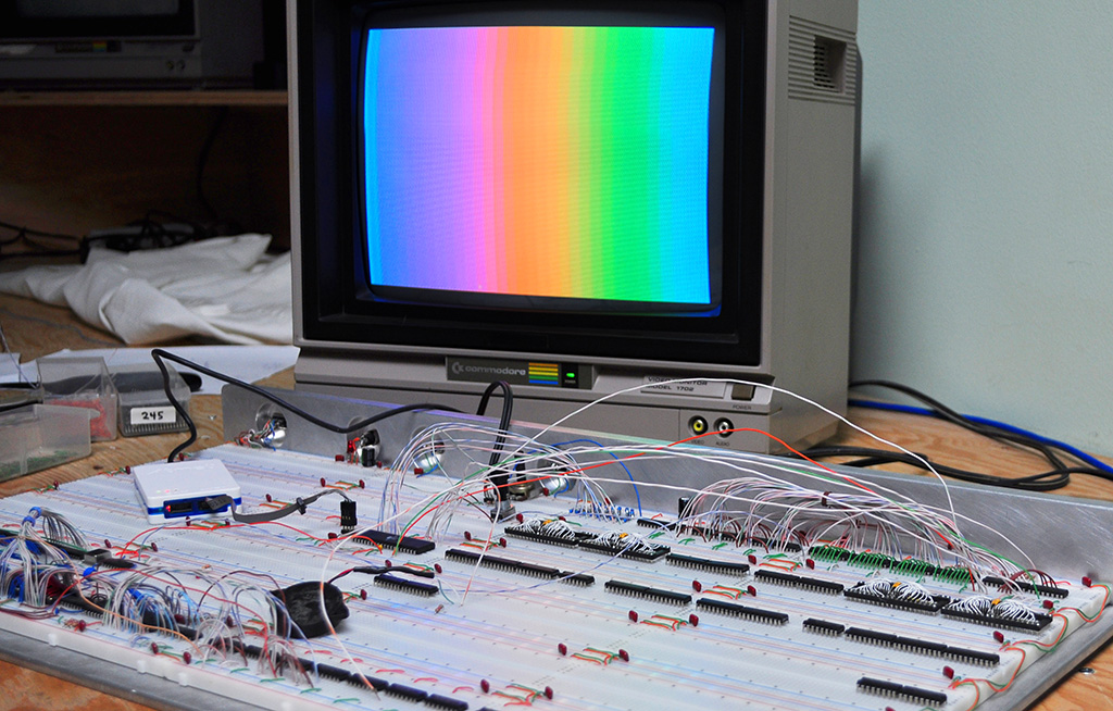

A bit early, but that did give me 1.5 hours to try out some basic chroma phase wiring.
it's ugly, but that's ok for an initial test...
Only the top rows of breadboards are active, the other ICs are just placed there to see what kind of real estate I might need as I continue.
So from left to right, this is what is going on here...
The bunch of resistors is the Luma DAC. This puts out 256 shades of grey or 256 levels of whatever color is being generated.
Composite sync is also embedded into the Luma signal, and this feeds the Luma input on the back of the 1702 monitor.
To the right of the DAC is the phase selector, which is 4 chained 74HC4051 analog data selectors.
There are 32 possible phases, which is why Vulcan-74 is capable of 8192 colors (256*32=8192).
Next in line is the chroma phase delay generator, which is 4 chained 74HC245 buffers feeding each other in series.
I have not fine tuned the delays yet, but they are not that bad already with only slight color overlap.
The last 2 ICs are just a 74HC574 latch to sync up the data bus and a 74HC138 to assist in addressing the 4051s.

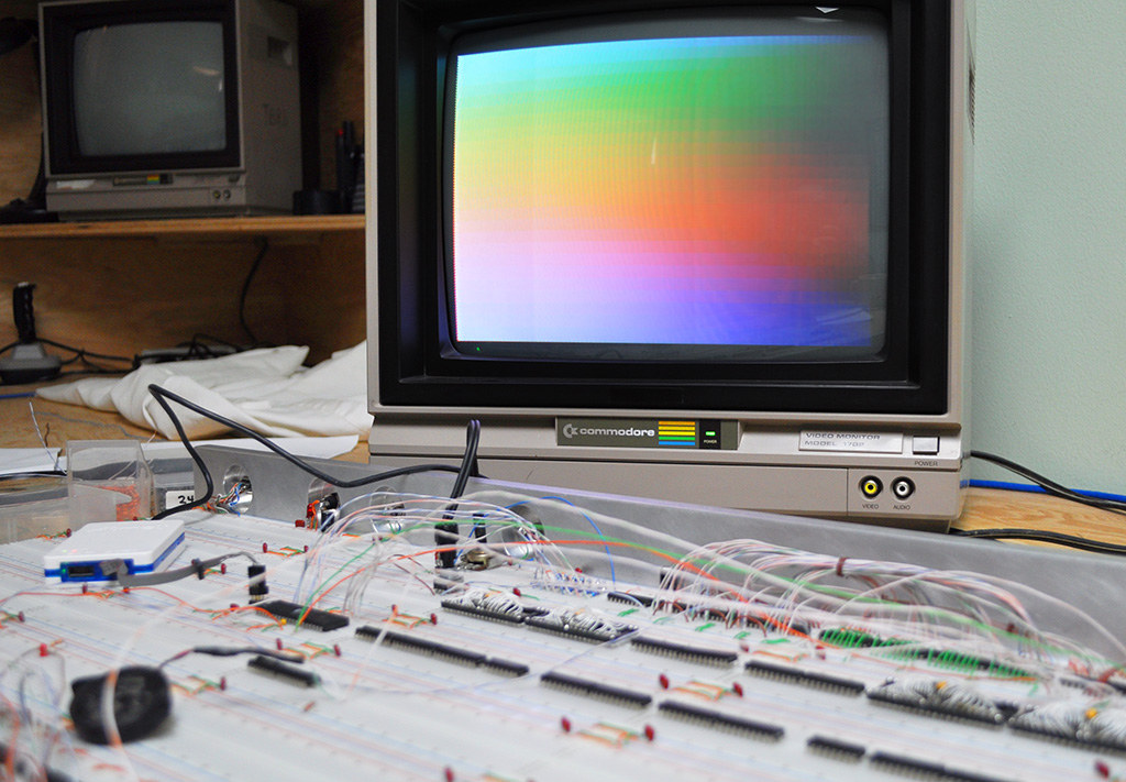

The output (selected phase delay) from the 4051 chain is fed into the Chroma input on the monitor.
For this initial test, I just dropped my old AVR324 sync generator onto the board and fed the DAC and phaser with addresses.
Here, only the Chroma phase is changing and the Luma is sent as full brightness (level 255)...
As expected, a nice selection of 32 colors with some overlap in the blue due to the propagation of the gates being fester then required.
This is good since now I just need a precision POT to lower the 74HC245 current ever so slightly.

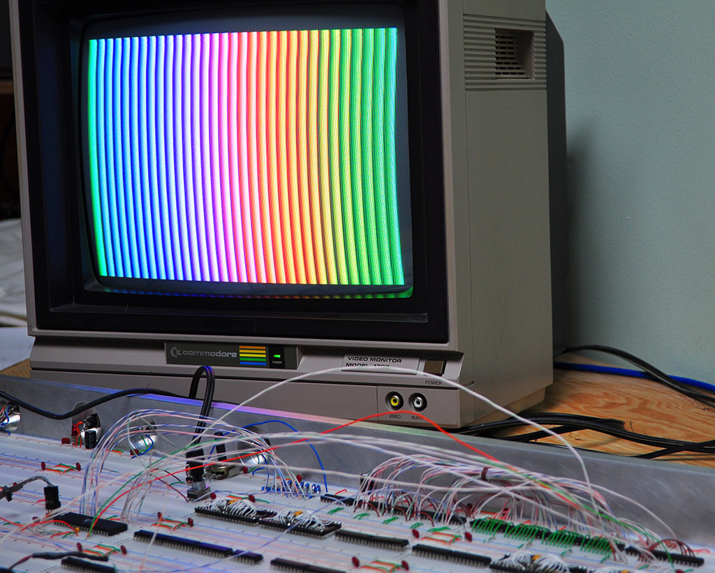

In this test, I sent Luma levels as well, so it made the expected color bars...
I will find a better setting for my camera later, as photographing an NTSC monitor is not easy!
On the bench here, that 8192 display of color bars looks very nice and clean.
Those Commodore monitors are really good quality, so much better then newer TV sets with S-Video inputs even.
So there it is... you can indeed generate 8192 colors for NTSC using nothing but 1980's logic chips!

One last shot of the basic color test, this time Luma fading across horizontal, and Chroma phases along vertical...
Yeah.... 8192 colors, baby!
The screen being generated here is 320x200 pixels in size, which fits nicely on the 1702 monitor.
I wanted to test that as I intend to have the left (IDE) monitor display 40x25 characters, just like the C-64.
The main monitor (GFX) fill have no borders and generate a 360x230 screen well into the overscan area.

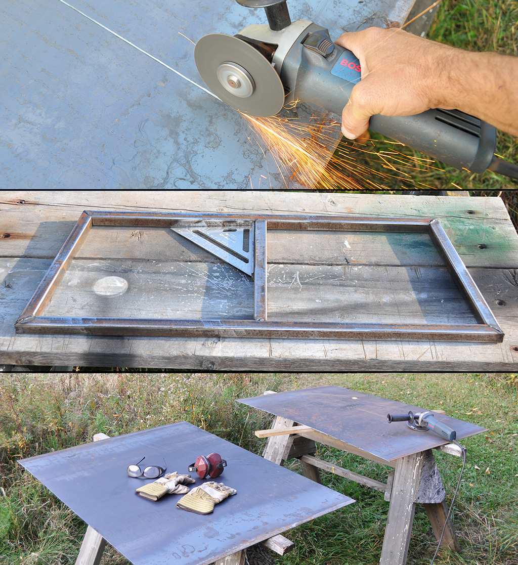

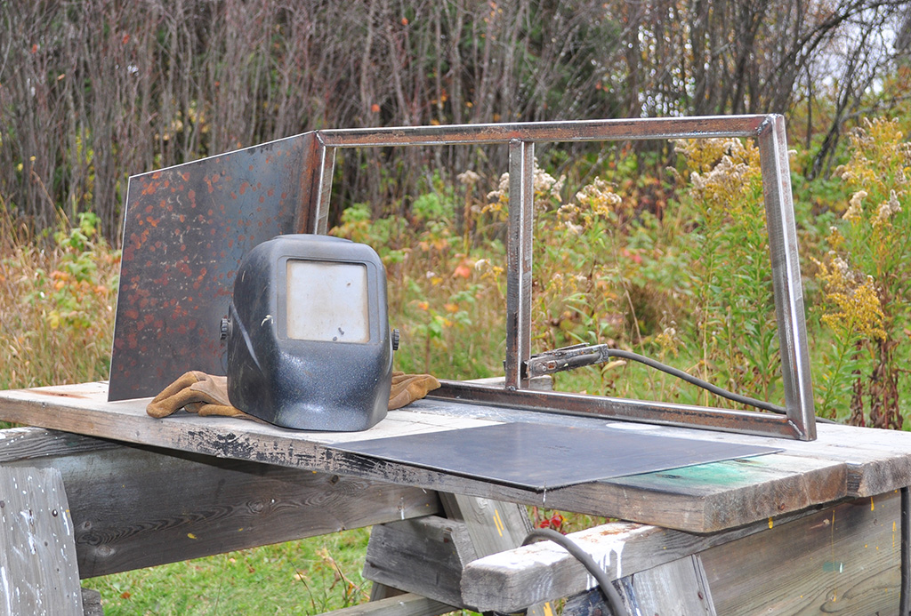

I managed to find 90 minutes of free time tonight. Yep.... I count every minute!
Went down to my old shack in the back 40 and tack welded the steel together for motivation.
Had some of the plates already cut, and carved out the other main pieces...
This is what I call "working in the field".... literally!

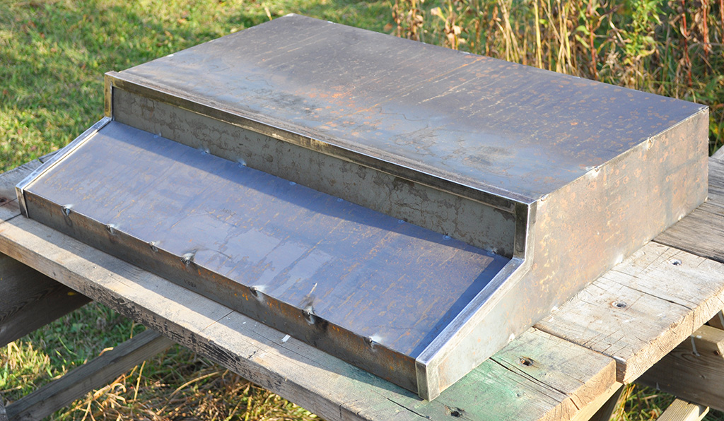

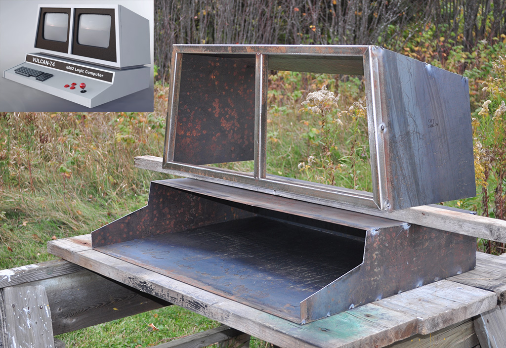

The front square tube frame is the foundation for the monitor sides, top, and bottom plates...
Here is the main cabinet tack welded. It's a big box at over 3 feet wide and 2 feet deep!
Here is a mockup to show the concept vs the real deal...
So far, the cabinet is exactly like the model. Final welds will be made on all outside corners and then worked perfectly smooth.
I am even going to find out how they painted the PET cases so I can copy that off white kind of bumpy look.
The only part I have not figured are the monitor bezels, but I think I lot of hand carving of wood might work.

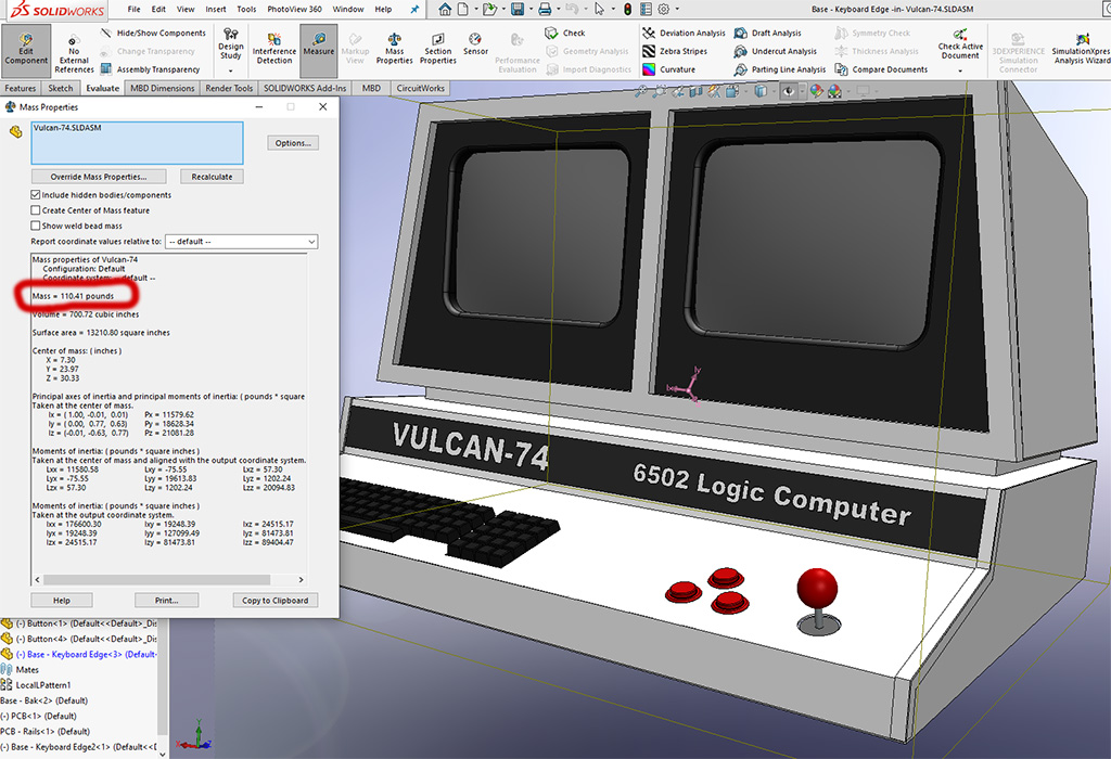

So far my 3D weight simulation seems accurate. I modelled everything including the CRT glass to get as close as possible.
The monitor simply lifts from the base and unplugs, so moving Vulcan-74 around won't be too difficult.
The monitor unit will weigh about 50 pounds, same as the base unit.
One day I want to bring this down to the World of Commodore show, so portability was always part of the design.

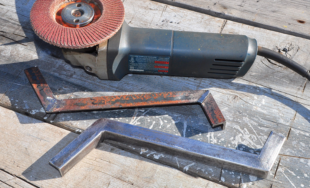

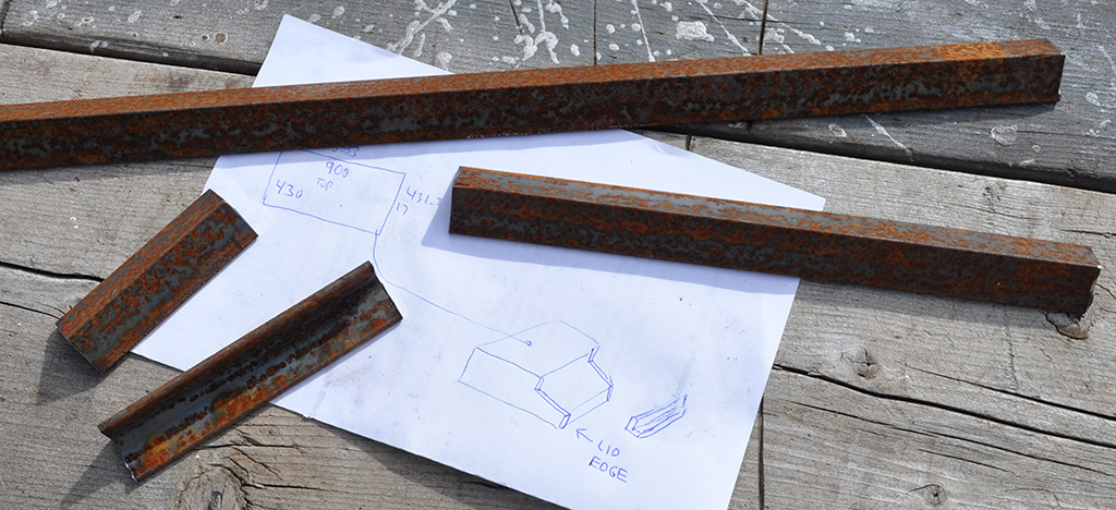

It warmed up to 8 degrees here, so I spent some time doing the smaller but more complex parts of the cabinet today.
I mostly build things from recycled stuff I have around, and I had just enough 3/4" angle iron for the keyboard trap door frame.
it's rusty from sitting outside for 10 years, but that's nothing the sanding disc can't deal with.
Once rough welded, the flap disc (sanding disc) does wonders for the rusty steel...
I only need to get "mostly" smooth here since I intend to use some epoxy filler to even out any scratches or weld inconsistencies.
Using the same design principals as Commodore did on the original PET case.... get close, fill the gaps, prime, paint.
of course, they probably didn't hand cut the steel on wobbly saw horses, but I am getting it close enough!

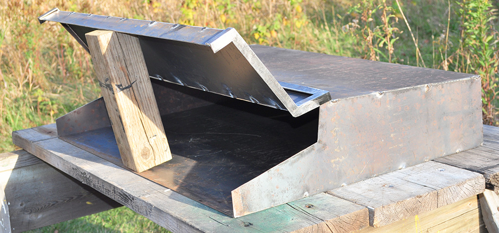

Here is the Keyboard Trap Door frame done with the Keyboard plate sitting in the frame...
The angle across the top isn't in the original design, but I though it made the cabinet look more robust.

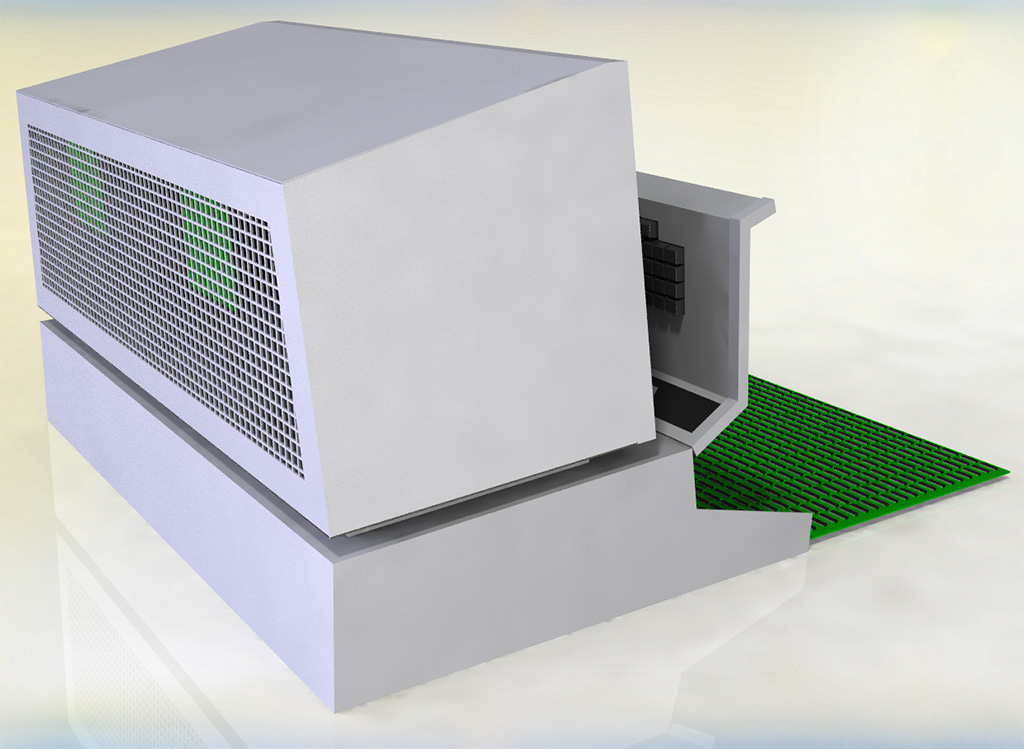

This is also a good place to make the hinge system, which I intend to work like a car hood.

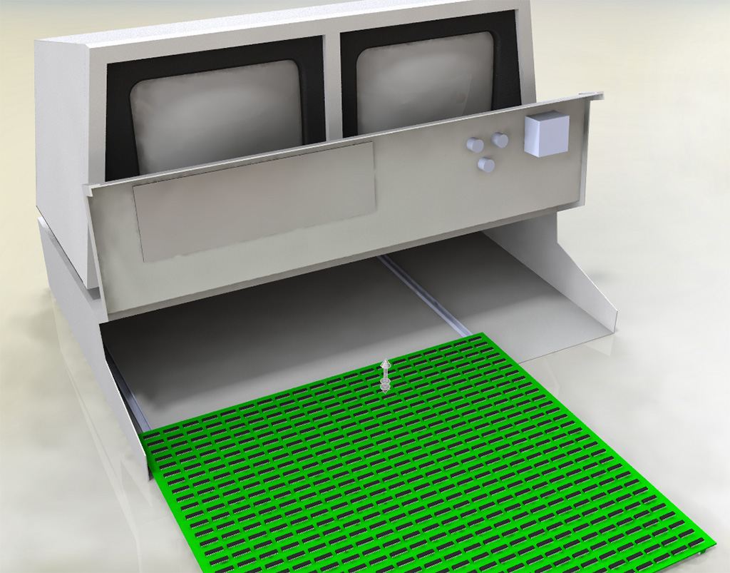

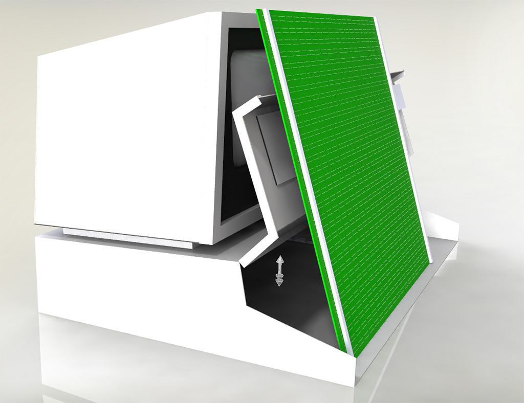

Vulcan-74 will open its hood with the press of a button. A motorized actuator will put it in this position...
At the same time, the massive circuit board will slide out of the front to expose the hand wired insanity.
The mainboard will also be able to tilt 90 degrees upwards to get at the underside wiring in case of repairs.
I can't imagine anything going wrong with a hand-wired board of 300+ ICs though, so it will be mainly to show off the wiring.

Here are a few renders showing how the mainboard will extract and then flip.
Also added the new keyboard lid top rail to the model...
Cheers!

Looks very robust, Brad... Kinda validates the "iron" part of your screen name! :wink:
Thanks for sharing the pics. World of Commodore is gonna *love* this!
