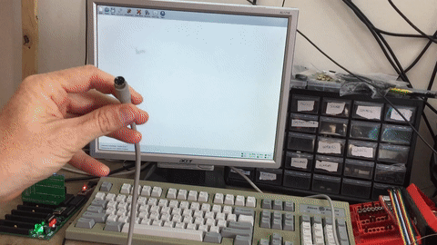

Quick update : the latest versions of the boards, with all through hole components have turned out to work perfectly. Here is a quick demo of the single board computer and the IO board together, working perfectly with a PS/2 keyboard with a 24 MHz crystal (12MHz CPU clock) and one wait state for the ROM.
Some slight mistakes with the labels on the boards and some components under the sockets that interfere with some styles of sockets were the only problems I found so far.
Very happy with how it turned out. It also works fine without any extension cards, doing I/O through the serial port only.
Real video (not a gif) here: https://planck6502.com/news/2021/10/15/new-boards-work-fine/
