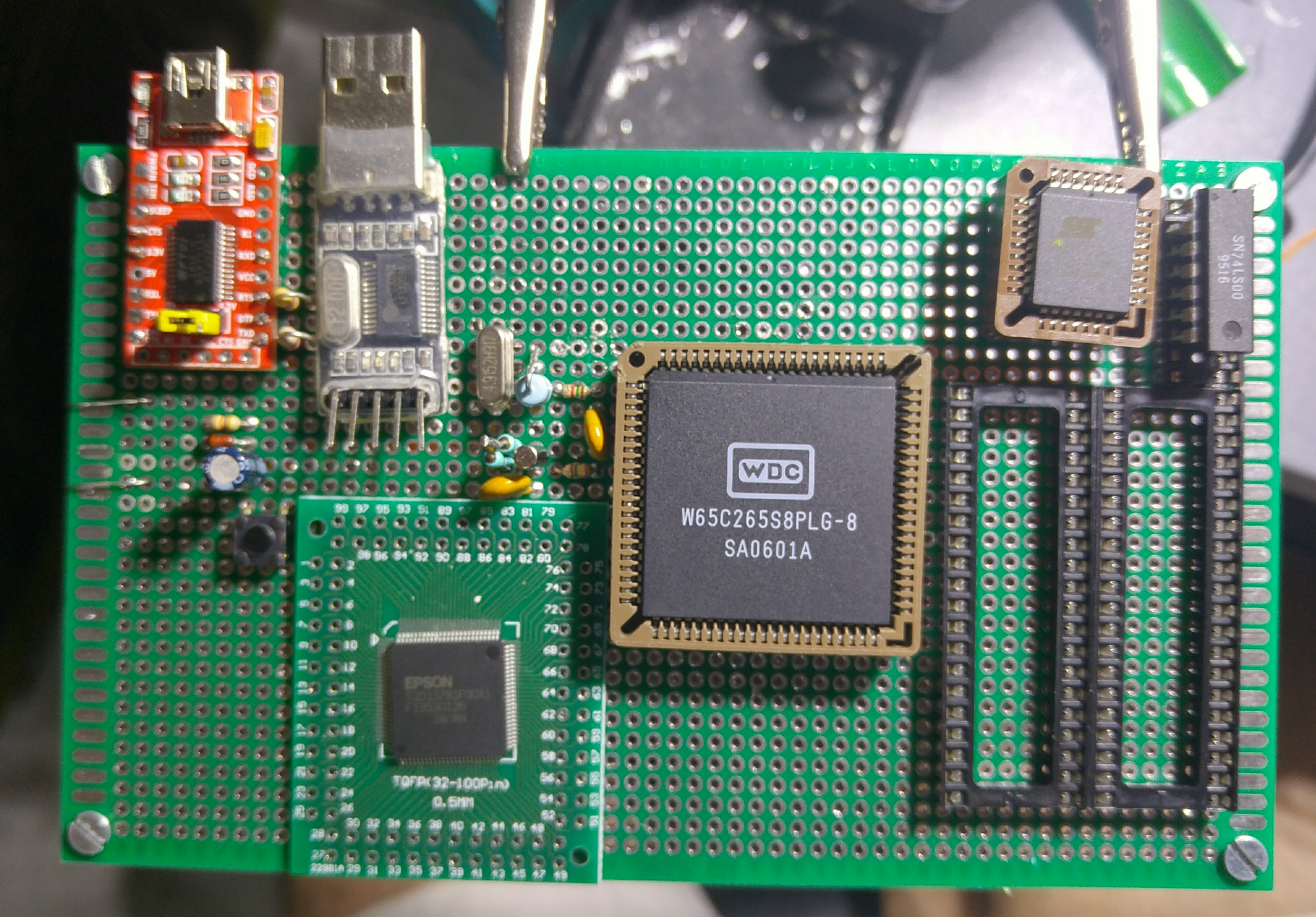

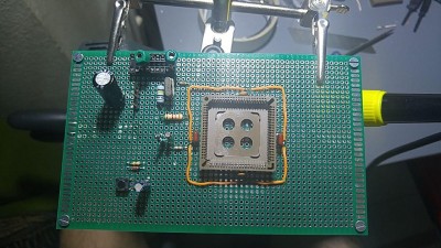

Well... Reorganized the board. Put away the big switch away so I will power the board just with USB by now.
Removed CLK fixed capacitors and rewired the circuit to a 14 dip socket where I can put in and pull off variable capacitors, so I don't need to desolder and resolder them just to change the trimmer and measure it.
By doing this, I got the board working at 3.3V stable so I can move to the next thing that is putting the EEPROM socket.

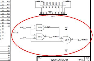

I will follow the w65c265SXB schematics, that uses a NAND logic gate to accomplish that.

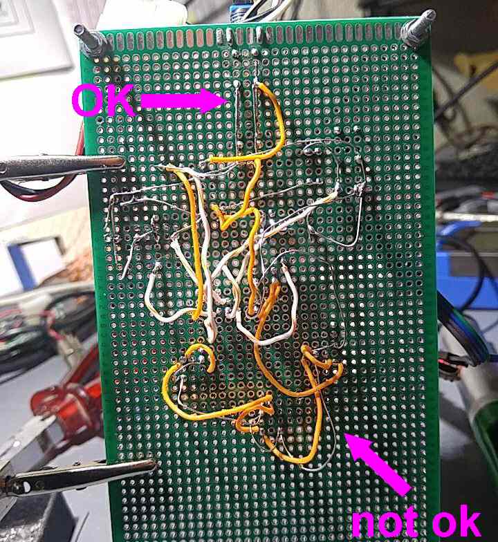

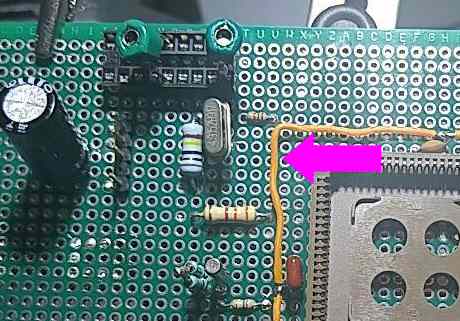

PostPosted: Mon Jun 22, 2020 4:02 am
Glad you're getting along a bit, but the continuing comments about touchy oscillator capacitors are baffling and worrisome. Something's wrong -- it's not normal to be fine-tuning those guys all the time (or at all, really). Hard to say for certain, but I suspect your power and Vcc arrangements are responsible for the flakiness. It'll be time well spent and I think you'll spare yourself some grief if you give the matter some attention.
In the photo I see some of your wires are short and direct and others have lots of unnecessary slack. If it were my project I'd re-do the bottom half entirely, especially since those wires are what bring Vcc and ground to the chip. Also I'd extend those Vcc and ground connections one step further so they form a complete loop around the chip. IOW, don't just go from the other circuitry to N-E-S-W (a J shape) around the chip. Make it N-E-S-W-N to complete the loop. Better yet, you could create an + shape right in the center of the chip's footprint connecting directly to all points of the compass. For best results you might wanna clear away what's there and re-do those N-E-S-W connections entirely. Then make sure the connections from the oscillator caps to the loop or + and to the CPU pins are reasonably short and straight. Best if those caps are rather close to the chip.
In another post I was asking about the bypass capacitors, and while I have no quarrel with recycled parts it's still important to get the right sort of device. Is there any old digital/computer gear you can cannabalize to get some ceramic caps? These'll be a better choice than the audio caps you have in there now.
Have fun and keep us posted,
PostPosted: Mon Jun 22, 2020 10:05 am
Posts: 344
Thanks for your detailed answer and honest advices. They are priceless.
This is the test board. The one built to see if I could do it. I have another one where I will be organizing things the best way.
So, you are telling me that I could wire the power supply like this, aren't you?
If it is... Where should I be attacking the mesh with the source of power? to the center? to one of the edges? to one of NSEW points?
The clock seems stable now, not only because the thing runs code, but also because I set date and time and after all night powered on, I checked back in the morning and the board hasn't frozen and it's still on time.
As the clocks, I think I will be putting cans there in more advanced stages of the project. The graphics chip I chose runs anywere between 1 and 33mhz, and I intend to run the board all from the same clock (except for 32768hz), I'm surely reworking that part. I still have to figure out how the clock affects the graphic chip. I think it has something to do with the fact that it has an integrated LCD driver, and that could be the key to choose the right frequency. From there, it would be a matter of extracting FCLK for the '265.
Thanks, again. I'm thinking in a kind of burning test code that I could write in the few bytes of RAM that the '265 has internal, to let it run for hours.

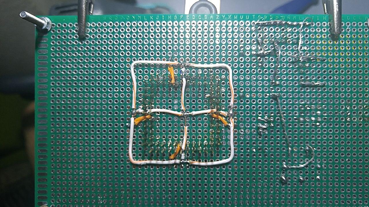

PostPosted: Mon Jun 22, 2020 2:38 pm
Yes, a mesh or grid is the right idea. And you want as many connections as possible, in all directions... subject to practical limitations, of course.
The ideal would be a Ground Plane, and that would directly attach every point with every other point! But it's possible to imagine the plane as an infinitely fine mesh. That's our compromise solution -- a "plane" whose mesh is more coarse than the ideal. A power or Vcc plane is the same.
You'll find it challenging to implement both a ground grid and a power grid, but doing just one or the other (for example, only do a ground grid) is a reasonable compromise. This works because attaching to a bypass cap that goes to the ground grid is almost as good as attaching to a power grid.
Remember to locate the crystal and the associated oscillator caps close to the '265, and keep the connections short. And I expect you'll be able to go back to the capacitance value shown in WDC's schematic.

What do you think of this arrangment?
I was thinking of using twisted pair CAT5 ethernet cable, the rigid one, like the one in the previous pictures, but this time the shortest possible route, with the GND and VDD twisted in each other instead of apart.
PostPosted: Mon Jun 22, 2020 4:04 pm
That looks good -- it agrees with the principle of as many connections as possible, in all directions. Possibly you don't need both the diamond and the cross, but the extra effort is trivial, so I'd say go for it. Better to invest a few extra minutes doing something boring, as compared to wasting many "interesting" hours chasing gremlins.
Speaking of effort, I think you'll find it much easier to work with fine gauge wire, such as AWG 30 wire-wrap wire. That and other relevant topics are mentioned in my and Garth's posts here. As he says, resistance is not the enemy (meaning a thicker conductor isn't greatly helpful).
No need to twist Gnd and Vcc together -- simply being adjacent is almost the same thing. And a run of Gnd and Vcc would typically be shunted at each end by a bypass cap anyway, which makes the situation less critical. Remember, for the high frequencies we're worried about a bypass cap acts pretty much as a piece of wire. That's why in my previous post I remarked that attaching to a bypass cap that goes to a ground grid is almost as good as attaching to a power grid. Hence you may choose to omit the power grid per se. Instead it's okay to rely on bypass caps and the Gnd grid, and for Vcc distribution just have a fairly casual arrangement of wires, not a grid.
For gnd connections I often use uninsulated wire, and that works out well because it's less work to install -- I usually just solder it flat on the board. And of course there's quite a lot of wiring in the ground grid, so the effort saved is considerable. In contrast, my Vcc distribution is usually pretty minimal, using insulated wire.

What's more important than keeping the power and ground wires together, is keeping the data lines and ground together. Every transition on a data line involves a small pulse of current which needs a return path, and the smaller the loop described by the outward and return paths, the less inductance, bounce, ringing and crosstalk you'll have to deal with.
So use your data paths as a guide to where to run your ground network. And fit 100nF ceramic capacitors across every IC's power pins. That'll take care of most of your immediate needs.

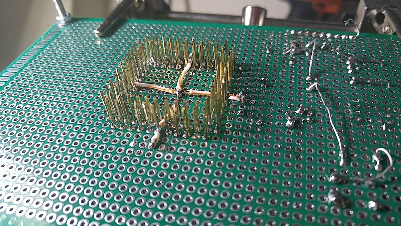

PostPosted: Mon Jun 22, 2020 10:29 pm
Posts: 344
Thanks all, again.
Well, I don't know if what I've done has in fact worsened my circuit, but here it is:
I took all the pins of IDE ports of an old Pentium 4 motherboard and soldered them along the small pins of the PLCC adapter the '265s was into.
And I'm reworking all as you suggested. I'll try to get a wire wrapper so I can do the next connections that way. I will remove and place back the clock circuits, next to the '265s. And I will also put a small FTDI board I ordered, so I will have a fixed serial converter there.
A thing about the FTDI is that it has an internal oscillator that could be used to clock the '265s, couldn't it??

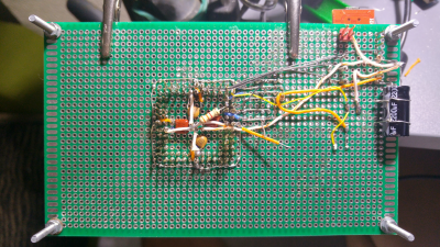

PostPosted: Mon Jun 22, 2020 11:49 pm
Posts: 344
I will stop today here:
I don't know if having VDD in one side and VSS in the opposite one, will make things better or worse. Maybe it will make putting clock, reset or serial circuits more difficult to replace...
PostPosted: Tue Jun 23, 2020 11:59 am
That's looking a lot better. But I hope you get some wire-wrap wire or other fine gauge wire soon, because I think you'll find it easier to work with.
It's OK to solder wire-wrap wire, BTW. Stripping off the insulation can be tricky, but you'll figure it out. When you buy a spool of WW wire there's usually a little stripping tool in the housing for the spool. Sometimes I use the tip of a hot soldering iron instead -- I just melt a nick in the insulation then pull it off with my fingernails or whatever.
In the photo, the arrow suggests (approximately) where you could attach the oscillator capacitors. I would relocate them so they're right next to the '265, ideally with one lead of each cap going directly (no intervening connection) to the appropriate pin on the '265.
And I'll bet you can use the values stated on the schematic -- no need for variable caps. Good luck!

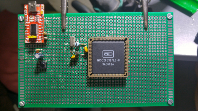

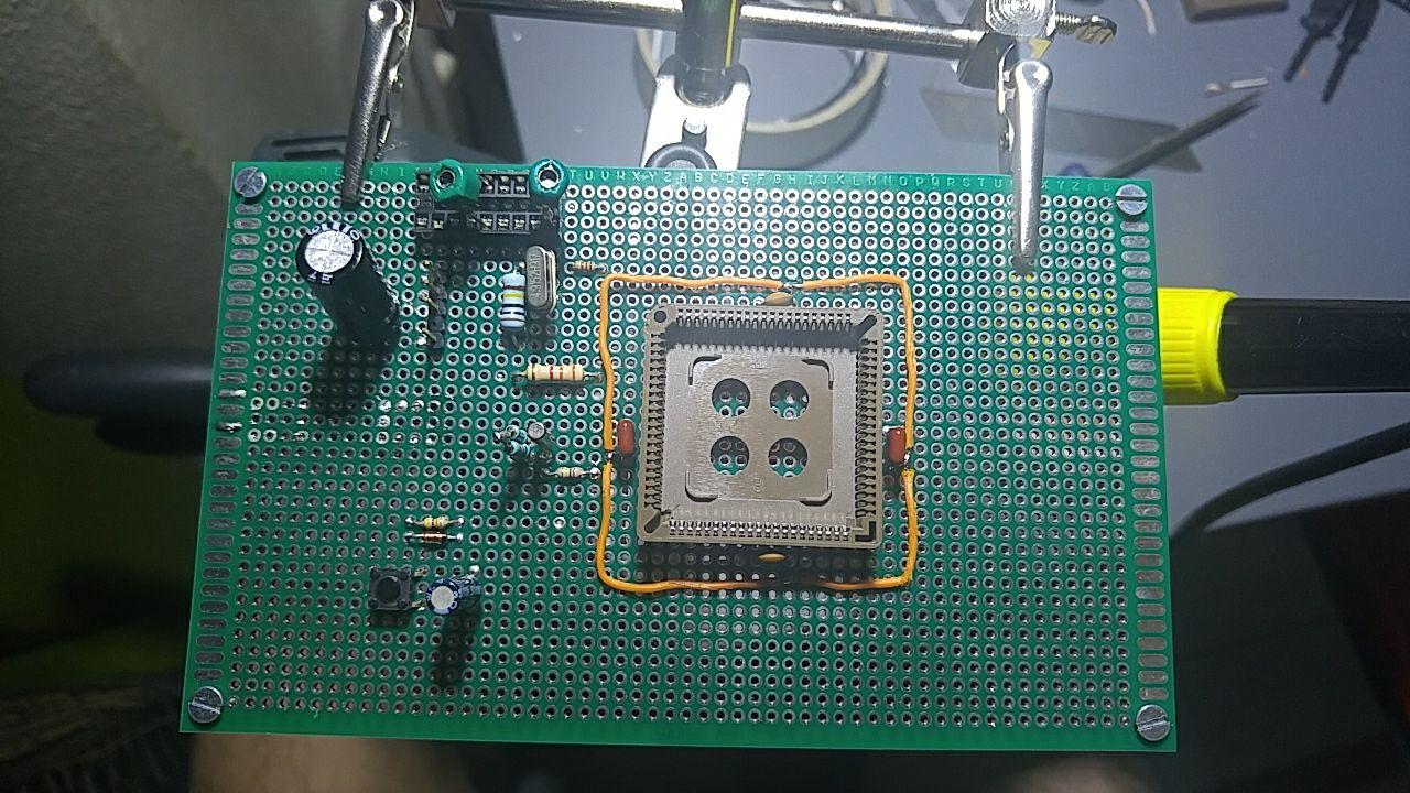

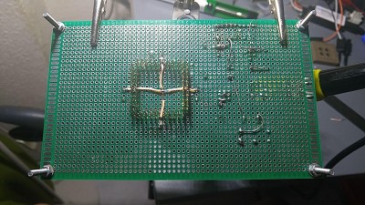

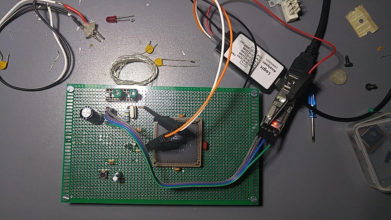

PostPosted: Sat Jun 27, 2020 2:36 am
Posts: 344
UPDATE:
AS suggested, I reworked the entire board. Well... the '265 is still in the same place. =D =D =D
I put a fixed FT232RL based daughter board to both power the board and interface the CPU. It seems that I could Fclock the CPU with it, because it can output a 6 Mhz clock in one of its pins, removing the need of a second crystal chip in the board. I have yet to test that way.
The bottom has now the capacitors under the main chip, and also the BE resistor directly soldered to the BE pin. I used a cross shape for the VDD supply, and a square shape for the VSS supply. I'm pretty sure this can be improved and in fact I will have to do it because...
...I have to yet fit all of this in the main board. There are even things yet to consider like a sound chip, the connector for the LCD module, an extra connector for the buttons and an extra board that would be used to put the LCD module and the buttons themselves. But this is more or less the things that should be put there.
Of course that this is not the definitive arrangement and I'm pretty sure I'll have to get all those caps, resistors and crystals moved, surely on top of the main chip.
And anyway, if someday this becomes something that would be actually manufactured and/or sold (I think it would be the first true 65xx games console in years, since the Atari Lynx) I would need the aid of true and experienced hardware designers to get a more compact design with surely SMD parts.
