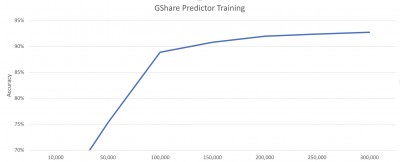

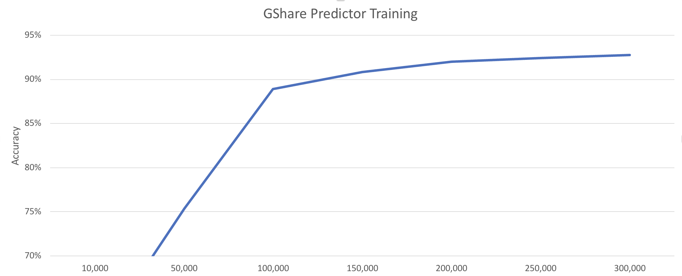

Good idea! I’ve not tried it yet either, but I do have this graph from a previous test run:
The GShare predictor takes about 100,000 cycles to exceed the bi-modal predictor’s 85% threshold. Perhaps simply easing the GHR from 0 to 16 bits at the rate of 1 bit every few thousand cycles might do the trick.
I do worry that changing the width of the GHR will change the location of branches in the addressable space and cause the predictor to take even longer to train. Does that make sense? Also, one advantage of the tournament predictor is that it will adapt fairly quickly to a varying workload (with bi-modal once again taking over as the accuracy of GShare drops). Maybe the “sliding” GShare scheme should have some heuristic to once again restrict the width of the GHR if accuracy drops suddenly.
I’ll be interested to see how this works out.

I think if you add the bits from the left to the right, then the locations of the first elements will remain the same. In other words, left justify your sliding / variable index into the memory, filling unused bits with zeroes.

Thanks Michael. Will give it a try.

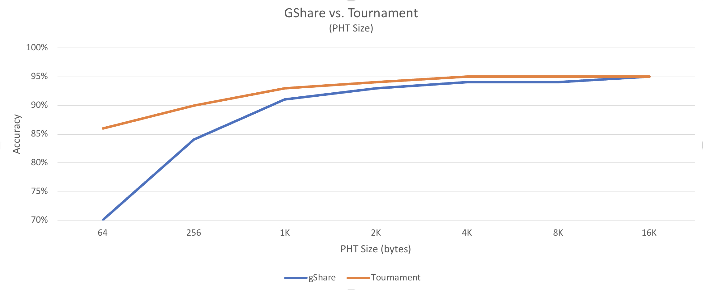

Alright, after much tweaking, the latest run-stats for the BASIC Benchmark look pretty good:

CPI is at just 1.15 for the BASIC Benchmark, or 2.8x NMOS. The tournament branch predictor performs well here, as well as on the much shorter Eratosthenes Sieve. It also does much better than gshare alone with smaller table sizes, making it much more FPGA friendly:
All in all, I'm pretty happy with that. I didn't have much luck with the "sliding gshare" scheme, unfortunately, but there are two additional enhancements that I'm holding in abeyance for the moment. They are:
1) JSR currently executes in two micro-instructions. Reducing it to one would eliminate all Generated cycles in the run above. The pipeline would then complete an additional 253,761 instructions for the same run, and CPI would be 1.11. The complication is that JSR would be writing to two addresses on the stack (for the low and high bytes of the return address). Unfortunately, that would double the number of hazard comparators required to keep consistency (from 14 to 28!). That's a lot of ICs.
2) Implementing the i486's Specualtive Execute Fetch would eliminate two cycles from every branch mis-prediction. That translates into 154,180 additional instructions in the run above, or a CPI of 1.09 when taken together with the JSR enhacement. The complication here is that additional memory bandwidth is required for the I-Cache to support the additional fetch. A quick test shows that without it the speculative fetch conflicts with the primary FE stage fetch 70% of the time in this run. There are a number of options for increasing bandwidth (including doubling with width of the I-Cache bus), but each comes at a cost.
We're at a pretty good place with the Basic interpreter for now, so I'm going to resist the impulse to optimize further. Instead, lets see what happens with FORTH and VTL02 ... :)
As always, thanks in advance for any thoughts and comments.
Cheers for now,
Drass
