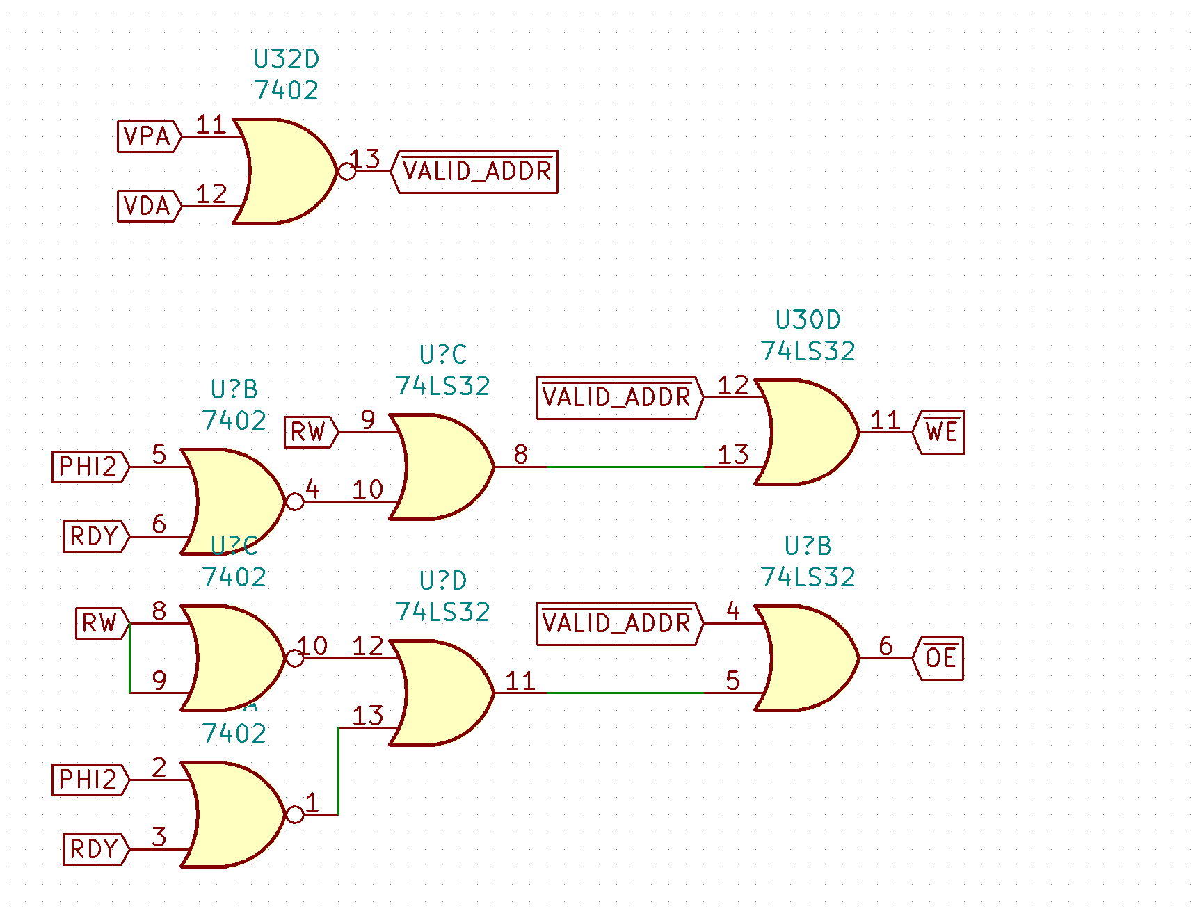

Well, I think I've got a handle on it. Let's start by establishing the circumstances where we need one or two wait-states; both conditions can be generated from one 74109 (JK flipflop pair):
The 28L92 UART will work without wait-states at up to 8MHz with 5V power, or about 6.5MHz with 3.3V power. It needs one wait-state to keep up with a WDC CPU's maximum clock rate at either voltage.
SRAM can be assumed to work without wait-states, as long as a suitably fast part is used. An inexpensive 55ns part is sufficient for 8MHz at 3.3V. (These parts likely run faster at 5V, but that aspect of their performance is not specified in the datasheet, only that they will *tolerate* being used in a 5V system.)
Atmel EEPROMs with individual byte-write capability are available with 150ns access time at 5V in PDIP format, and with 200ns access time at 3.3V in SOIC or PLCC format. The 150ns parts require a 100ns /WE pulse width for in-circuit programming, and the 200ns parts require a 200ns /WE pulse width. Both have a much shorter /OE access time than address access time (noting that the CPU's address lines become valid some time *before* Phi2 goes high, including the bank address because that "shines through" the transparent latch while it's open).
So the 150ns parts can be run at 5MHz (or more safely at 4MHz) for both reading and writing with no wait-states, require one wait-state for up to 10MHz, and two wait-states permit full 14MHz operation of the CPU.
The 200ns parts will run at 4MHz for reading only with no wait-states; the relatively slower write cycle requires reducing that to 2.5MHz for programming. Introducing one wait-state increases the limit to 7.5MHz for both modes of access; you could then sensibly run both the CPU and a UART from a single standard 7.3728 MHz oscillator, and reuse the same wait-state logic for safe UART access. If you prefer 8MHz as a round number, you'll need two wait-states on the EEPROM to be safe, so overall performance may be slower if you run a lot of code from ROM.
Jeff's 74109-based circuits trigger RDY to change just after the rising edge of Phi2, so we can assume RDY to be stable during the Phi1 phase of the clock - a very useful property. They also naturally provide /RDY without an additional inverter gate, because each flipflop includes both Q and /Q outputs. We want the bank address (and thus /CE), /OE and /WE to remain stable while RDY is held low, and the necessary logic equations involve /RDY, so this is very useful. We can lead the positive RDY signal straight to the CPU pin, through a parallel RC circuit to avoid conflicts upon executing WAI or STP.
Normally, the bank-address latch is triggered by ~Phi2. To avoid corrupting the bank address, replace that with ~(Phi2 | /RDY).
One of the things we want to do with an '816, as opposed to a 6502, is to qualify /OE and /WE with (VDA | VPA), so as to suppress spurious accesses during "internal operation" CPU cycles. The equations without wait-states would be:
/OE = ~(R/W & Phi2 & (VDA | VPA)) = (~R/W | ~Phi2 | ~(VDA | VPA))
/WE = ~(~R/W & Phi2 & (VDA | VPA)) = (R/W | ~Phi2 | ~(VDA | VPA))
Wait-states require that *either* Phi2 high *or* /RDY high are sufficient to qualify these signals, and this is most convenient to arrange with the latter form of each equation, though it increases the gate depth from Phi2 by one level (compensate for this by using a fast logic family such as 74AHC). We get to reuse the ~(Phi2 | /RDY) signal from the bank address trigger:
/OE = (~R/W | ~(Phi2 | /RDY) | ~(VDA | VPA))
/WE = (R/W | ~(Phi2 | /RDY) | ~(VDA | VPA))
We also need to qualify the wait-state circuit's trigger with (VDA | VPA), so that a spurious access that just happens to select the slow EEPROM doesn't trigger an unnecessary wait-state or two. Since we're already generating ~(VDA | VPA) in the above, we can trigger the wait-state logic with (~(VDA | VPA) | (/CS_UART & /CS_EEPROM)) for example.
Is there anything I missed?
I'm pretty sure the above takes care of the bank address. That and the VDA/VPA wrinkle are the only things specific to the '816.
This should do it then:
