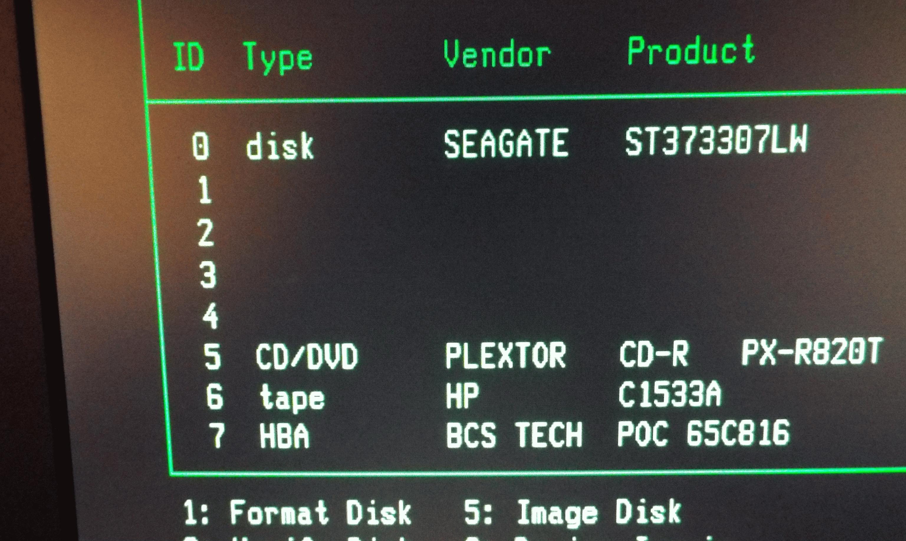

Funny you should ask, Garth. :D BCS Technology recently acquired a new higher-end digital camera that takes exceptionally good photos, and has a wide focal range, from less than six inches to upwards of a mile (see attachment for just how close a closeup it can take). It should be able to take sharp pictures of 'scope traces, something that I had considerable trouble doing with my previous camera.
What I'd like to be able to do is figure out how to secure the camera to the bezel of the HP 1725 'scope we have on the electronics bench so photos are taken at close range without surrounding light interference. At one time, camera adapters for that purpose used to be readily available, but I haven't seen anything of the sort in recent years. These adapters held the camera at a precise position, minimizing image distortion caused by the lens not being dead square to the CRT face and eliminating blurriness caused by having shaky hands (that describes me these days :lol:). They also included a hood that completely excluded surrounding light. Way back when in my bench technician days, I used such an arrangement to take Polaroids of 'scope traces for use in technical manuals.
Anyhow, I have been wanting to get a collection of 'scope images of the various signals on POC V1.1 for comparison to POC V2 when it gets built. So I will make the effort to get something as soon as I work out how to set up the camera for the purpose.
